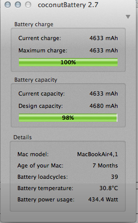

Screen Shot 2011-09-26 at 1.46.16 PM
What is up with my battery listing? Its saying my mba 7 months old when they only came out in July. Also, compared to the OP's post, my wattage is much much much higher.
I've been having unsatisfactory battery usage as well, but I'm on an 11" i5. I'm getting maybe 3 hours max with the display on the lowest and backlit/bluetooth off.
any ideas?
Coconut Battery hasn't been updated in a while, and its formula for estimating the age of the notebook isn't accurate anymore.
Ok, I can probably accept that, but why is the op's wattage 9.2 while mine is 434.4?
I have no idea. I was getting results closer to the OPs. Did you have anything intensive running in the background (like Handbrake)?
I guess that explains your poor battery life if you are consuming 434.4 watts! ;)
I suspect it gets a little warm too? :rolleyes: ;) :eek: You could heat the room with that!
Obviously, the Coconut isn't working properly in your computer with those readings. You might want to re-download the program again and run the new copy and compare results. Otherwise ... as someone said earlier, that program hasn't been updated recently and is probably not reading the battery data correctly.
I ran CoconutBattery 2.7 on my 2011 11" i7 Air and it was running about 10-15 watts while doing a TM backup over the WiFi. All other readings were similar, and mine showed a erroneous 7 month age as well.
