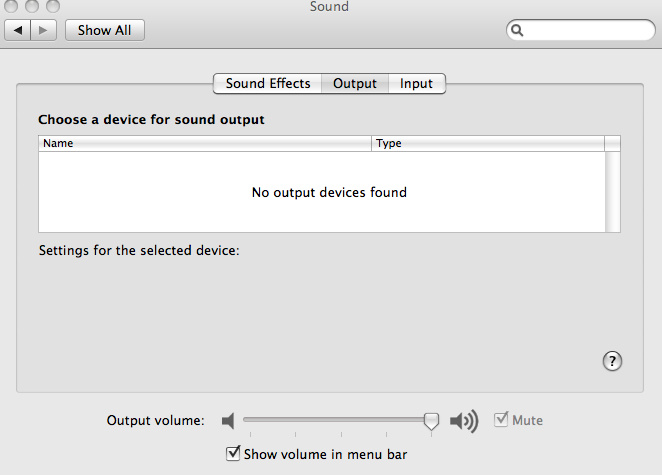

Upon startup, the internal speaker do their chime thing, but afterwards there is no sound. The place on the status bar when the volume controls are supposed to be is blank, the F10, 11, 12 keys show a mute, the sound preferences show no output (grab attached).
I have searched forum and the there is no red light from headphone jack, pugging in headphones did not change.
Again, this is a brand new machine that I used my SuperDuper back-up to reload. My previous laptop was 15" Macbookpro '10/2008 model. Other than this issue, all went well with the transition to the new machine.
If it is a hardware issue, why do they work on start-up? thanks for your help.

You did not clone your drive I hope? Cloning with super duper gives you no sound. This has been reported by MANY. DONT use super duper to clone your drive to this version of Macbook Pro. No sound is the result. Try a reinstall for repair or just do a full clean install. either new sound drive is needed or super duper has a bug.
Argggggggh
If it is not connected, then why would I get the sound on start-up? Thought it must be a software problem (driver thing) when I restored from backup?
i had the same problem when I swapped hard drives with an old MBP with the new one. What I figured was that the hardware was not the same, and you needed new drivers that came with the MBP install disk. So what I did was I backed up all my files to Time Machine, then reinstalled OS X using the provided Install CD. It works fine now! Hope that helps!!
I had the same problem after migrating from my other Mac to my 13" MBP. Tried everything, including extracting the audio kexts from the install disk as described elsewhere on the forum, to no avail. Had to do a reinstall from the OSX disk to fix it.
Oh if you cloned... try installing the OS from scratch 🙂
