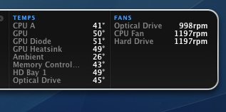

my macs been on most of the day with a few sleep times..
here are my temps to give you something to compare to.
