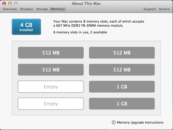

I opened the side and pulled out the memory cards. Looks like two banks of 512mg (1gig per?) and 2 1G banks. Total 4Gs(?).

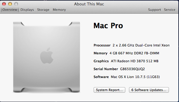

That machine will still be a fast beast. The dual quad core processors will help with video encoding etc. I would try the 1T HD and suspect it will work.

If it's a 2006 model, it'll have dual cores. The quads weren't available until 2007.

2. Add more RAM. 8 Gig would give you plenty to play with. Most people seem to buy from OWC (http://www.macsales.com/) - I've bought RAM from them several times, and apart from one faulty stick, which they replaced promptly, I've had no issues.

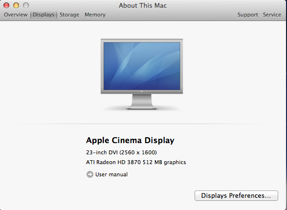

One more thing: It's not clear what graphics card you're running, but I'd also upgrade it if it's a really old model. You could buy the Apple upgrade kit, or if you're willing to lose the boot screen (the monitor shows a black screen until the login screen) and have a later version of Snow Leopard and/or Lion, some PC cards work 'out of the box'. Personally mine has a Sapphire 5770HD (PC version) in it.

If you look under the PCI-E cards slots on the outside of the tower it will show the specs the computer came with.

3. Replace that old HD 3870 with a decent card.

As budget allows, I'll try to get more memory. Expensive little buggers. Definitely going to get a SSD for it. I just threw this 320 in to test. I won a dollar off a friend. He bet that it wouldn't boot with an internal drive. 🙂 I think the video card, for now, is fine. I don't do graphics/videos (well, I edit my small little eating videos with iMovie.. if that counts, still earning how to do that on my Macbook.) What card would you recommend? After reading what I just posted. Or do you think this card will suffice? I have no plans dropping cash on any "bigger" photo/video editing software or games really.

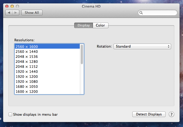

23 Cinema HD @2560x1600? Little weird. Native is 1920x1200.
Seems like similar driver bug as with 7950s.
Thank you. i got a helluva deal on it. I couldn't pass it up. Just wish it'd run ML (I use Messages for everything.) but, it's fine. I have Lion installed right now but, I may put Snow Leopard on it.

I've bought all my RAM and other hardware from MacSales. I haven't had an issue yet. I see the prices, it might be awhile before I try to load up. 32Gs sounds fun.

I'll most likely hold out on the video card for awhile. As I noted in a reply earlier, I don't really do anything graphic intensive. My lil 23" ACD looked great while I was running it last night. I'm fine with that, of course, I'll test it out more tonight with videos, youtube, and other video means.

Another good place for RAM is Crucial. They've got a handy "Memory Advisor" tool right on the home page. Enjoy the new-to-you Mac Pro!
I use them for all my PC systems I work on. Never had an issue with them either.

OWC has on major issue: price. $419 for 16GB in 4GB sticks.
You can have that for $160-180 on eBay, with standard flat heatsinks.
