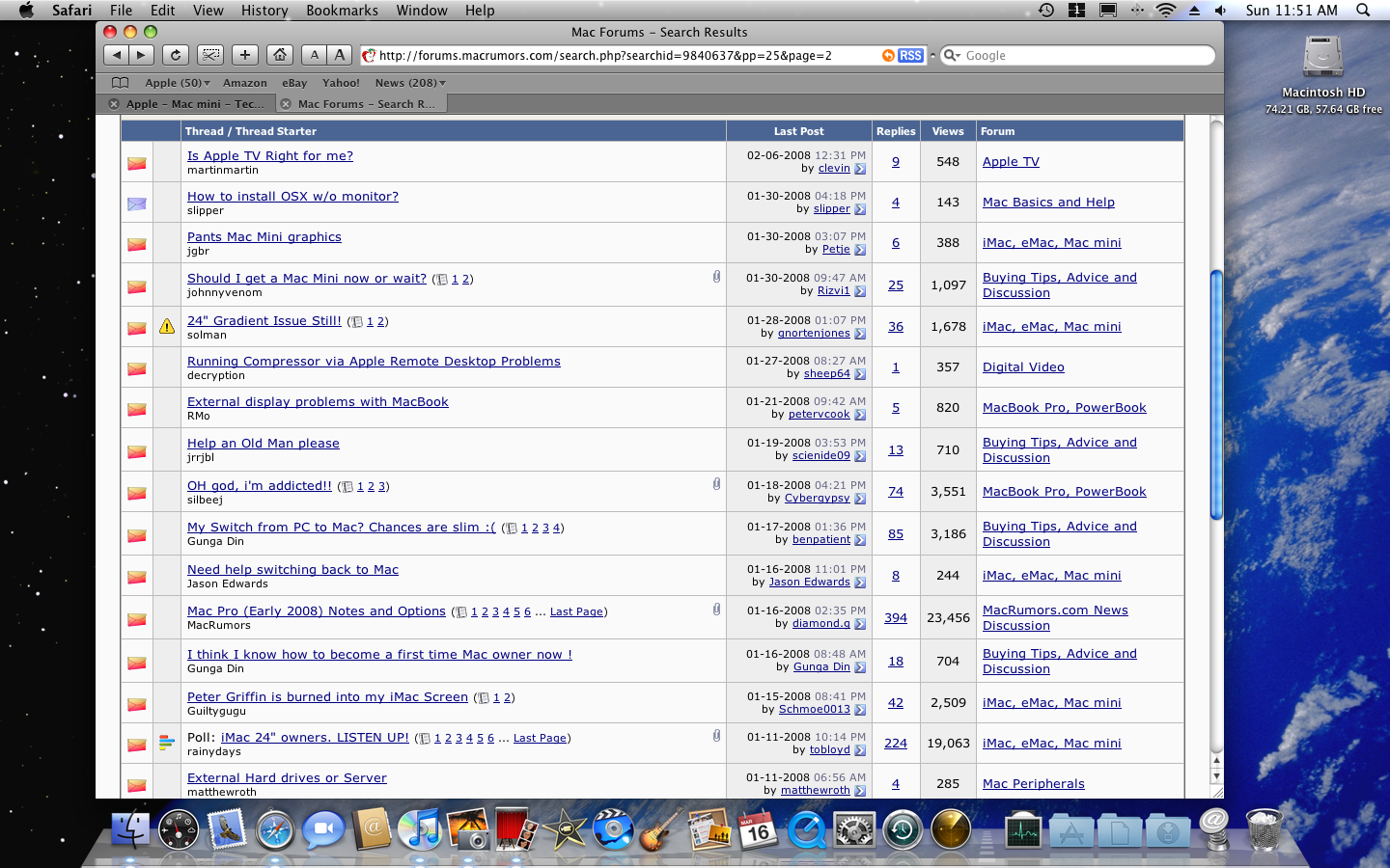

I just bought my first mac on Thursday from a friend and am having some display issues. (the mini was brand new, sealed, never opened) I also bought a new Dell 17" widescreen lcd monitor. (model #SE178WFP) Here's the problem... Anytime I open a window of some sort, whether it be Finder or Safari or any other app, I get these faint vertical lines that run up and down the screen in the background. Sometimes when I move the mouse around, there's a vertical line from top to bottom that follows the cursor. I have the Resolution set to 1440 X 900 which the monitor can handle. Has anyone experienced this issue? Even when there are no windows open, you can still see the lines & shadow...kinda like burn in. Could this be a bad monitor or the mini itself or something to do with the refresh rate? I haven't installed the cd that came with the monitor yet. Anyone have any ideas to what it might be? If it is the Mini, will it be covered by Apple? Any tips or info will be much appreciated. Thanks
Please click on the picture to open in full screen and look at the top near the address bar to see what I'm talking about.

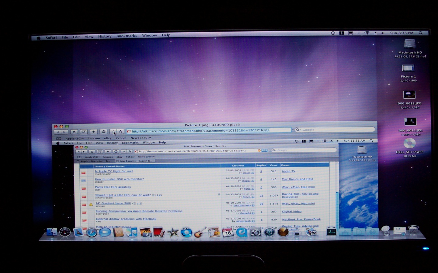

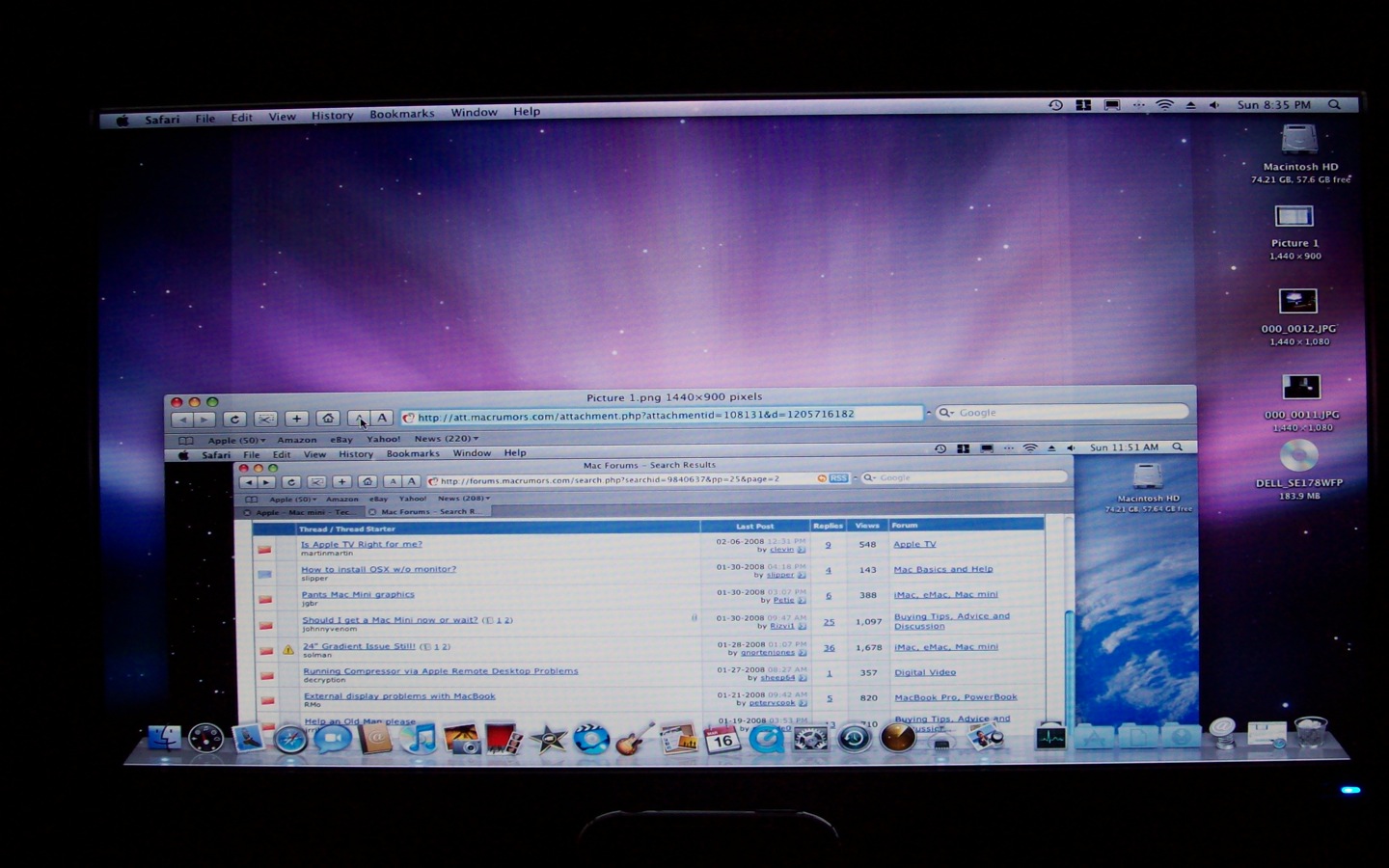

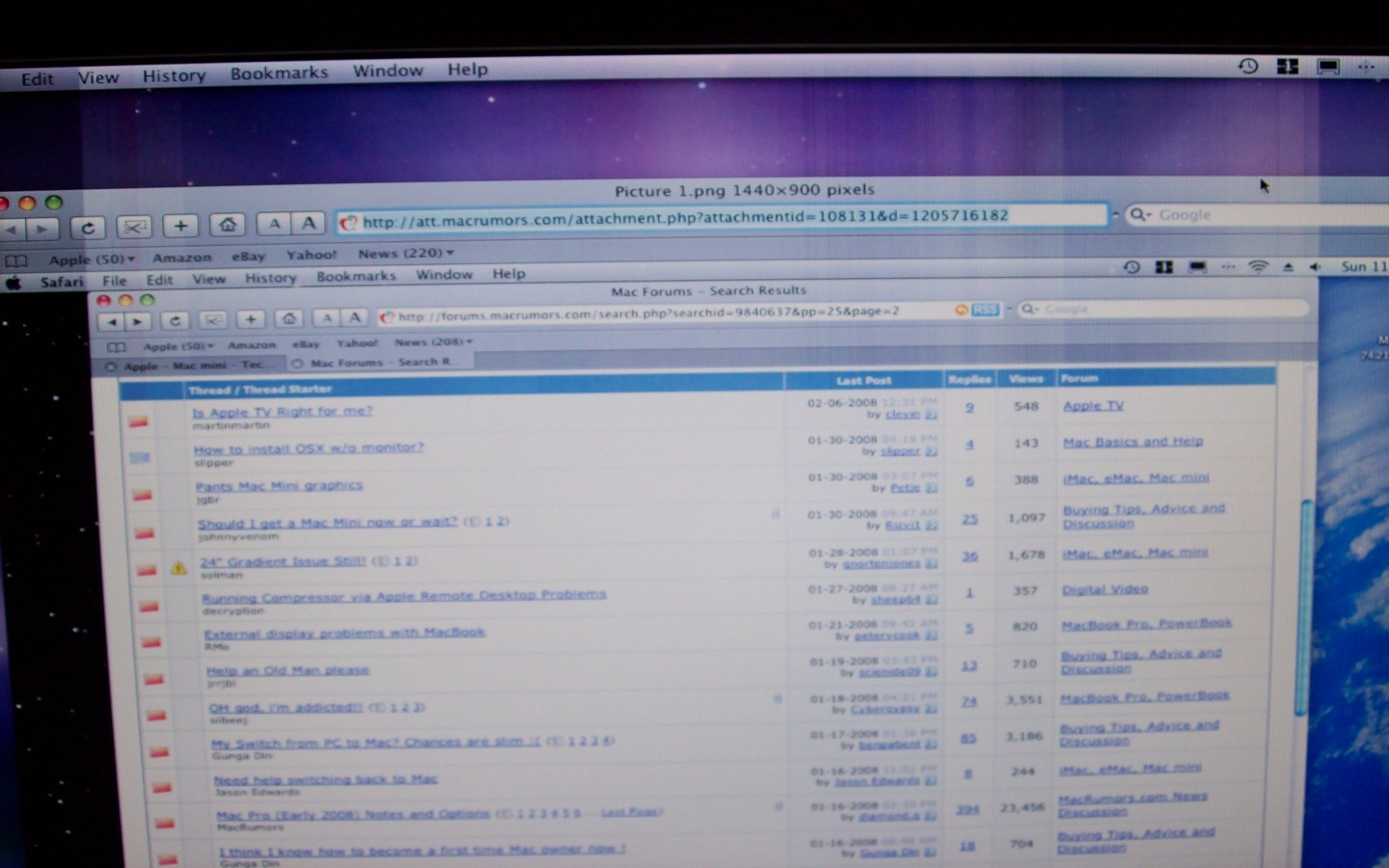

i took a couple more pics. this time with my digital camera. hopefully ya'll can see these. i tried changing resolutions, but it doesn't help.

Eww, looks bad, do you have another display in your home that you could test and see if it has the same problem?

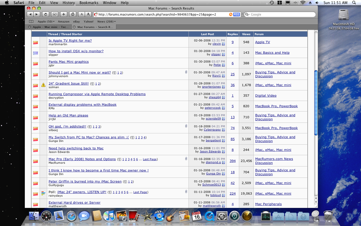

That does look bad, but because the screeshot came out perfect I'm going to guess it's the monitor.

got to say, with 20 years of experience, looking at the first screen shot, then the two digital photo shots, this totally looks like a monitor problem. you might try changing refresh rates (recommend 60hz), and then try running the dell 'auto' cal from the buttons, but bet you a quarter, it's a monitor problem.
ghosting on frame lines, retrace, all classic monitor faults. best of luck.
Good News!!!!!
YAY!!! I tried it on my notebook and it does the same thing! 😀 Thank God it's not the mini. Looks like I'm making a trip to BB and swapping it out! The funny thing is that it wasn't so noticeable on my hp as it is on the mini. Thanks to all for the advice! That's why I love this forum.
