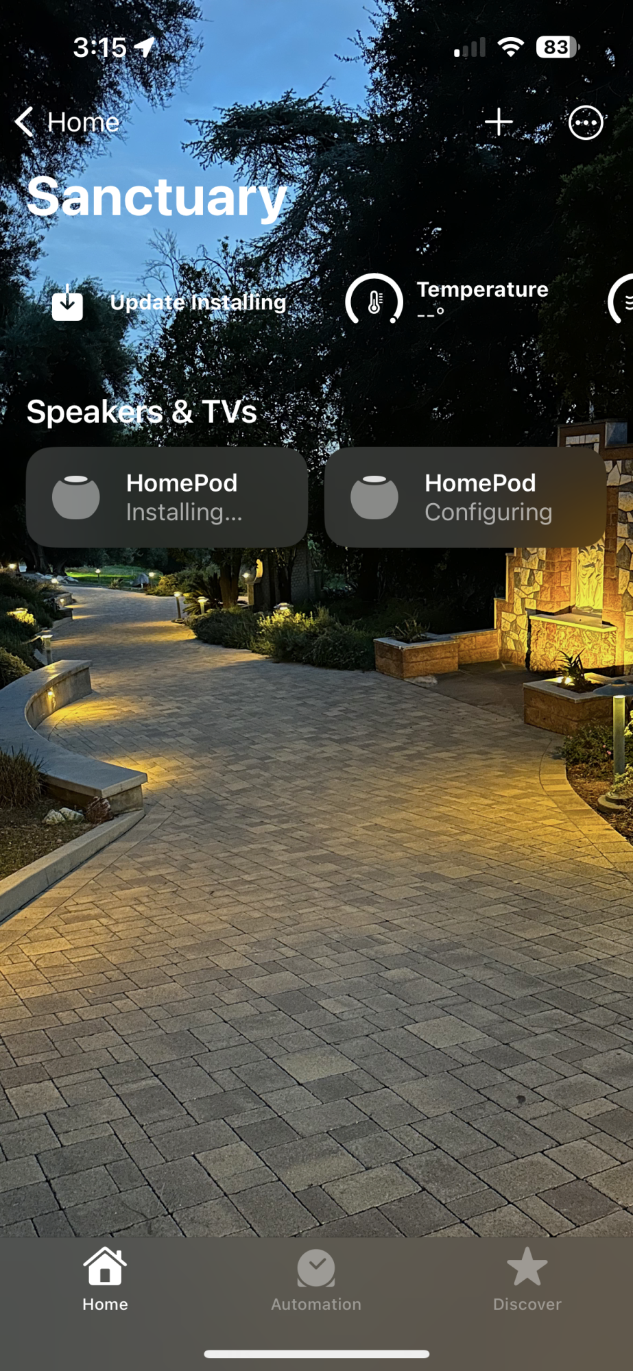

I decided to pick up a pair of minis today for my office/home gym room. I plugged them both in, and each one was recognized. It even asked for me if I wanted to pair them (had to do that on my own with the OGs). Anyway, they were updating to 16.3 and configuring.
But they’ve been stuck like this for over an hour! Not sure what to do. Any suggestions?

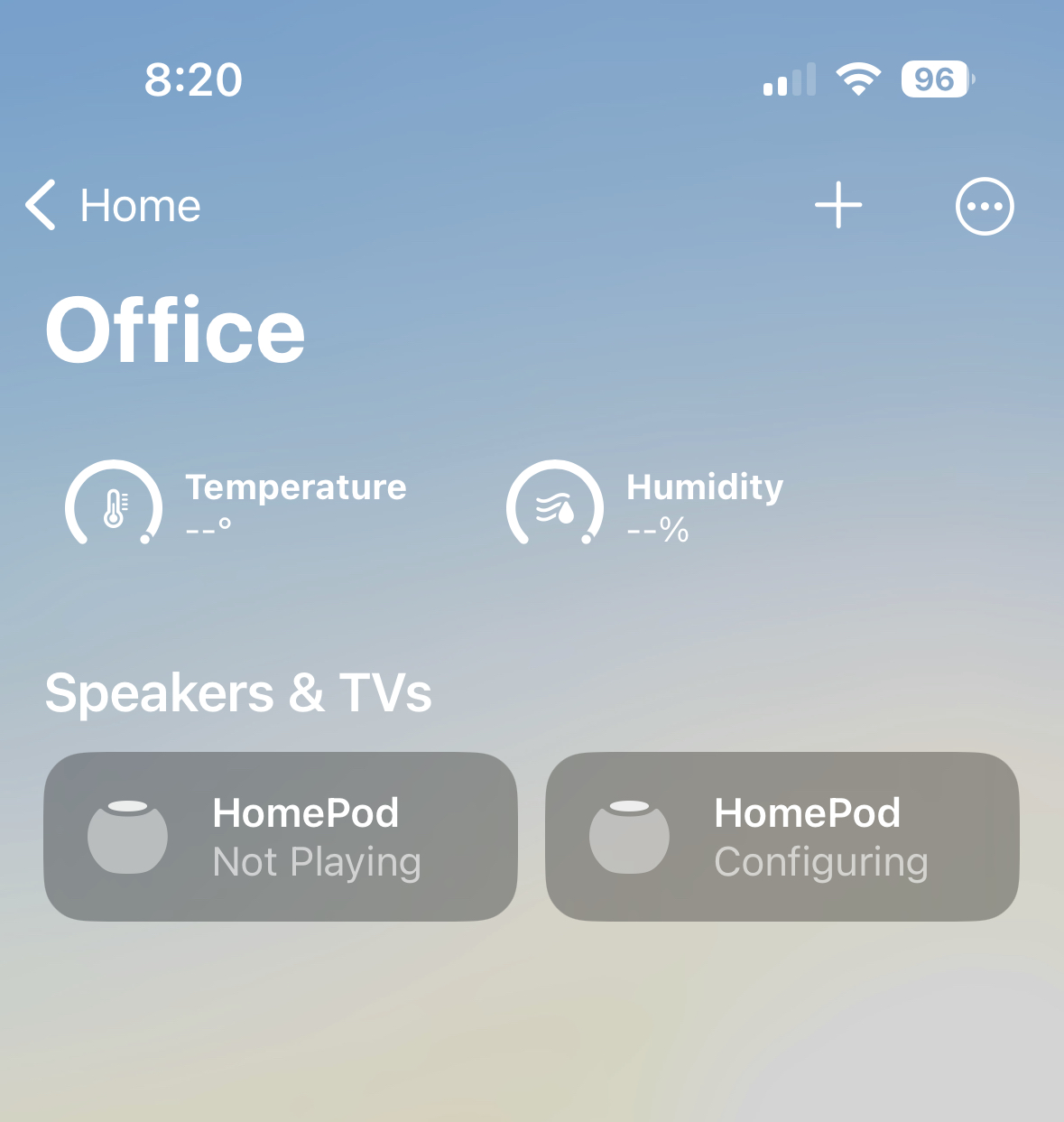

Yeah, tried that twice. Now on with Support. We’re trying to set up with another device (iPad). Still stuck on configuring.

They are on 16.3. Stuck on Configuring (Calibrating). The updating part is done.

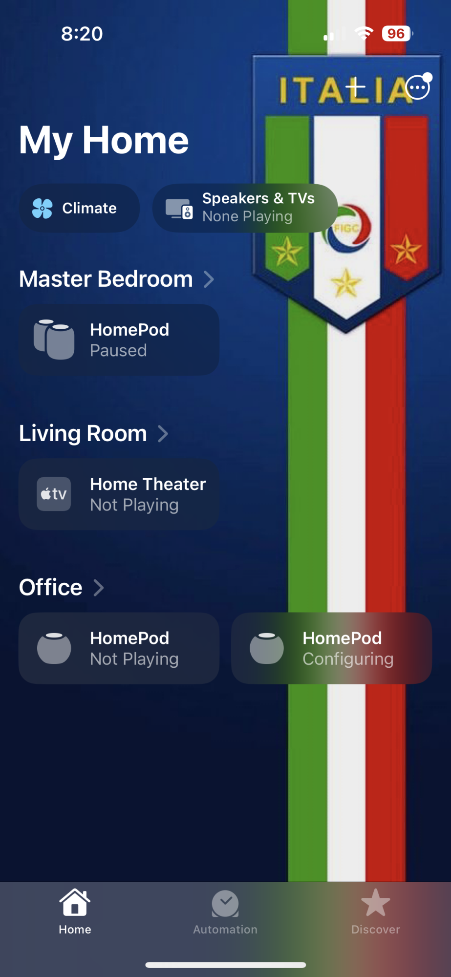

What I just did was unplug all items in Home (Atv, OG HPs). Then removed the minis. Reset the minis, and set up one at a time.
I thought it was going to work as the first mini actually completed. But the 2nd one is stuck. I can pair the 2 for a hot second, then they immediately unpair.
I know at least some in Support are pulling their hair out because of the new Home architecture. It’s giving users all kinds of problems, and they aren’t able to solve them all.
It’s just weird that not everyone is having the same issue. Some are, some aren’t.

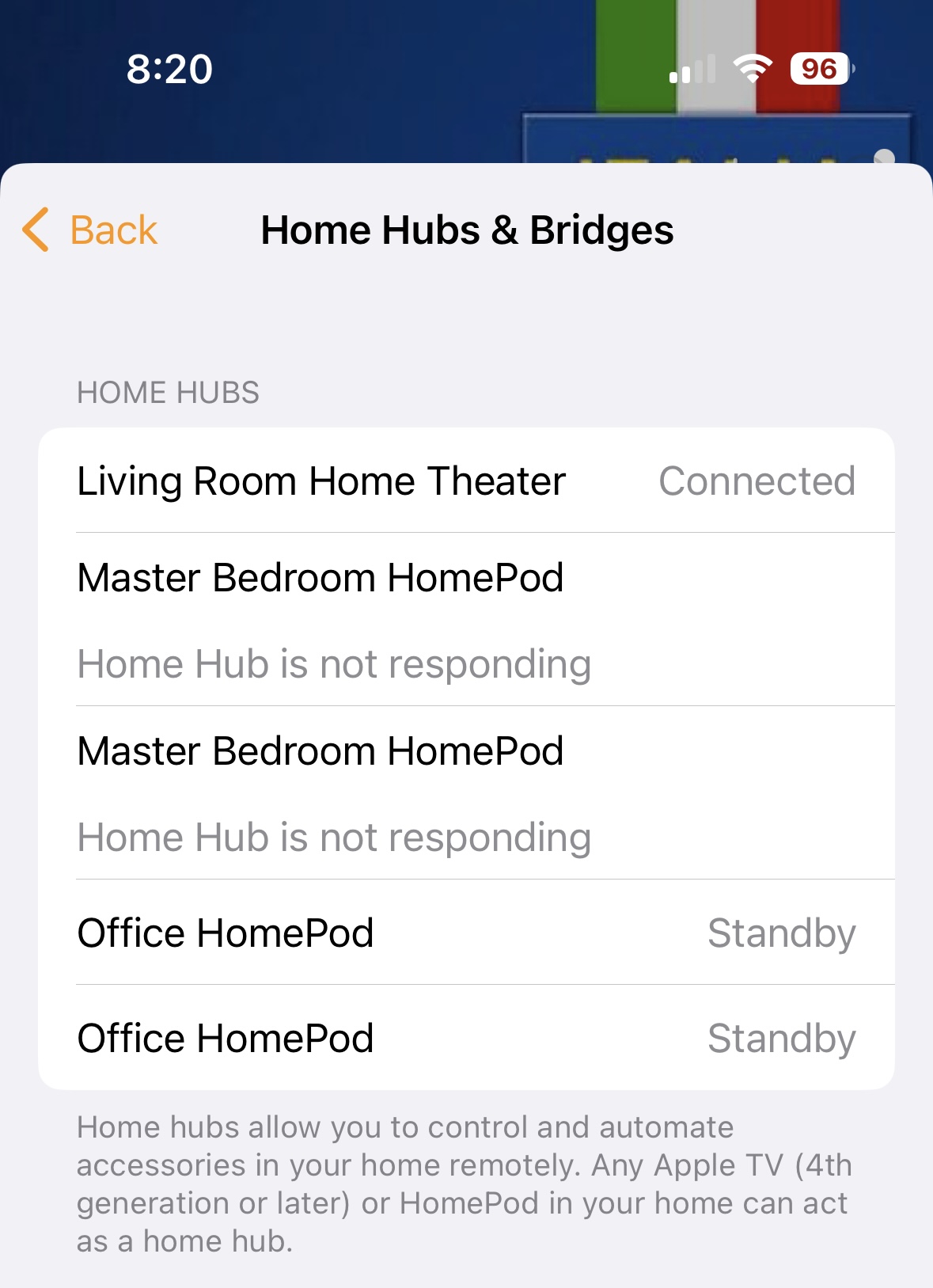

One thing to note, as I’ve plugged the Atv and OGs back in, they are in the Home app, but the OGs aren’t connected as hubs anymore.
Office are the minis, master are the OGs
