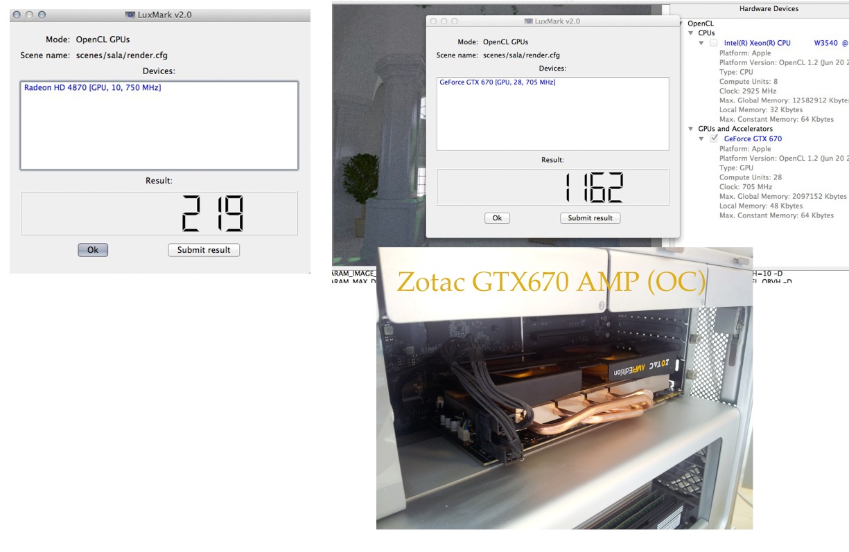

Just installed a ZOTAC GTX 670 AMP (overclocked) with two 6 pin connectors.
Popped it in, no boot screen(I don't care, I actually like the black screen), and both DVI ports work for my 30" and 20" ACD. Did the easy Netkas OpenGL hack and ran Luxmark with scores below.
ATi 4760- 219
Zotac GTX 670 OC- 1162
ATi 4760- 219

Yes, I bought it from Centralfield, my GTX 670 2GB was $3,298, not a bad deal, cheaper than the prices I've seen from the US.
One more question, since installing my 670, I've performed the netkas openGL fix, and installed the nvidia cuda driver.
now, when I boot up my mac, it would be blank until it gets to the login screen, however, only the gray textured screen appears, there is no password input box with the name, personal icon, or anything. But I am still able to login by typing my password, and pushing enter.
Do you guys know how I can get my login window back?
