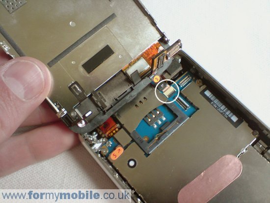

There's 3 connectors that connect the two halves of the device. Connector 3 is a small ribbon cable that looks to be part of the "Home" button interface. I pulled the ribbon out of the connector, but for the life of me, I can't get it back in. It looks like it should just push right back in. There doesn't seem to be any latch to crimp it down with.
Question #1: Is anyone familiar with that cable/connector and how it connects?

Ribbon cable 3 just goes inside the little white box and you clamp the black bit down to secure it:
Thanks a lot for the explanation. I was able to slide the ribbon in further, but the home button still doesn't function. I sent a query to Miliamp to see if it's salvageable (or economically sensible to do so).
