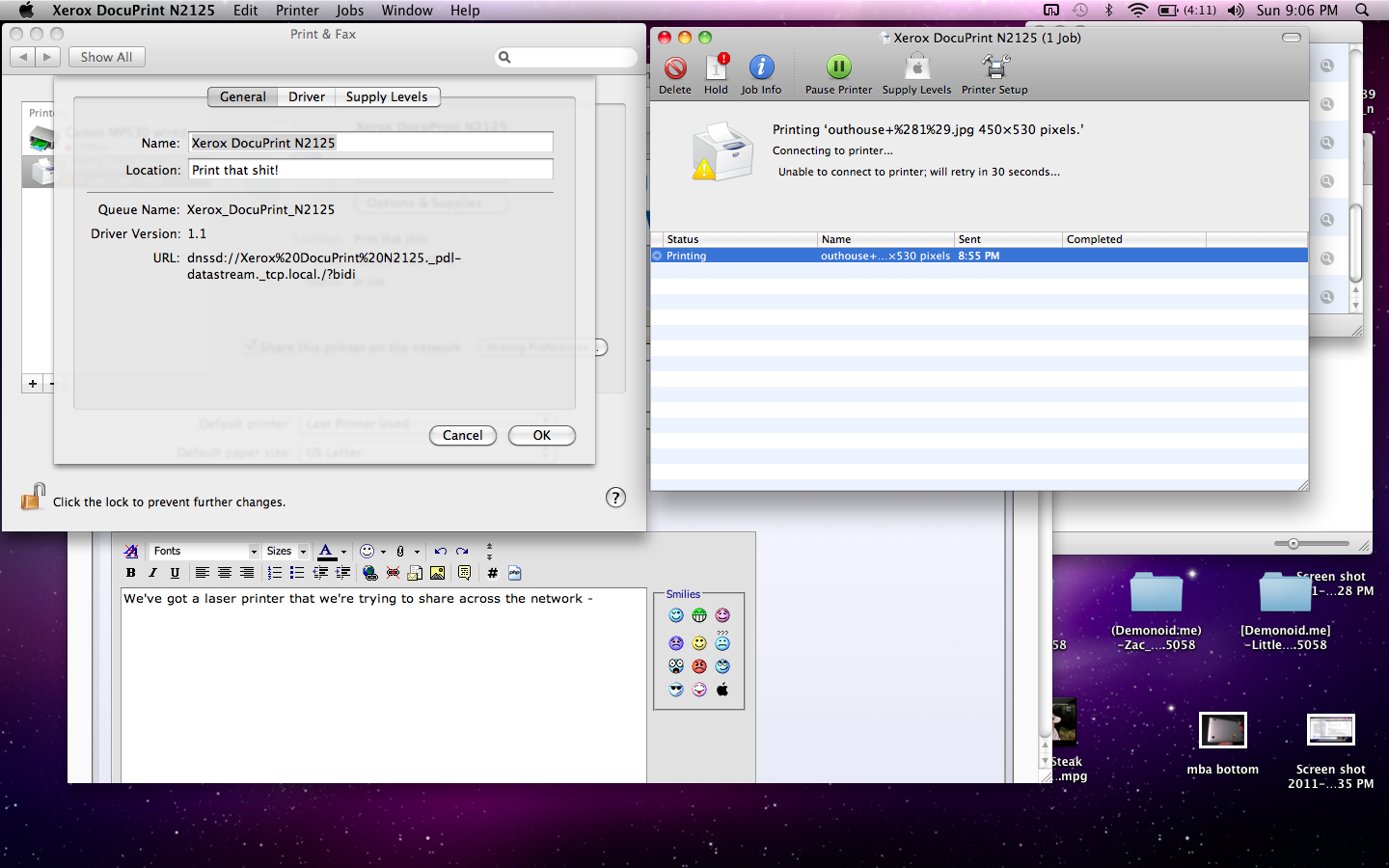

We've got a laser printer that we're trying to share across the network - we've got a WZR-HP-G300NH that doesn't support wireless printing, so we hooked up our old AE, which we had the printer configured on previously. So, we could have two networks, one for internet, one for printing, but there's gotta be a more elegant way to do this.
Currently, I can see the printer across the network, but it doesn't respond when it comes time to print; I know it's connecting via Bonjour, but I don't know if there's some port or protocol I need to open on the Buffalo router to make things work.

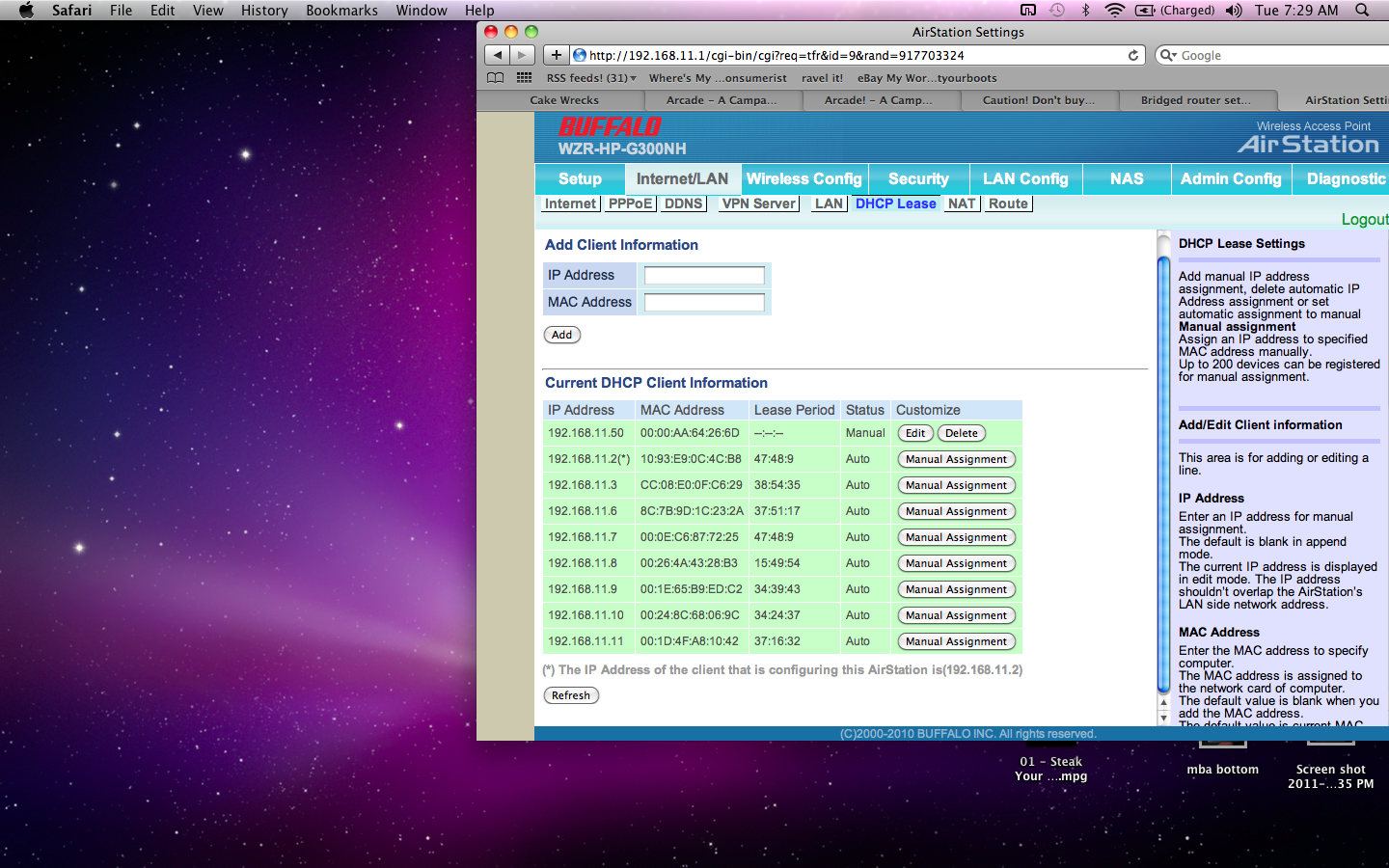

Is it anything more complicated than this? (Pic below)
