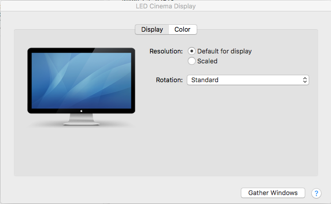

I'm not sure what to do. I have a 5K iMac and a non-Thunderbolt display connected. However, the secondary display, I cannot control the brightness. In System Preferences > Displays, there isn't a slider for brightness for the secondary display.
I've tried Control/Option/Command/FN + F1/F2 and it won't do it.
Any ideas?
You have to have the USB cable from the Cinema Display plugged into the computer as well, there's no brightness control when you only have the miniDP cable connected.

Thanks, but I did have the USB plugged in and tried a different port. Same result.

I too had this issue and found it to be a dodgy profile.
Open colour sync utility, select your monitor from the list then change profile. In my Mac, there were 3 Cinema Display profile so I selected an alternative and presto, brightens control came back instantly.
running 27 inch iMac with 27 inch Thunderbolt Display and 24 inch Cinema Display. working a treat now but, it did take a while to figure out.
What Apple call profiles are in truth, cleverly disguised display drivers.

I know you're going to hate this reply but It is your monitor profile. open ColorSync utility, select a new profile for that screen type, load it and finally, reset your PRAM.
option-command-P-R on bootup. hold down when you hear the chimes.

go t colour sync and select an alternative profile ( display driver ). usually there are several listed for a particular series of screens. it usually fixes it
