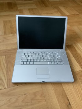

Hello all,
My girlfriend unearthed a few of her old Mac laptops, and I’ve taken it upon myself to try and get them flying again. Rather new to this, but what should I be doing to get it working and usable (only for fun, not serious work). Battery is dead as a door nail and no charger in sight, so those are ordered and on their way.
haven't cracked it open yet, but took a peek at the RAM and it’s got a single 512 in it. Looks like it can take up to 2GB so that’s a possibility.
Also turned up an iBook A1005 and MacBook A1181.
thanks! Can’t wait to see these things working.

Status report, put a new battery in and it booted right up. Also ordered a charger and that doesn’t seem to make a difference. Tested the charger on the iBook and it works there. Area around the charging port is dented, wonder if something is loose there? Powered it down and took the battery out so as not to waste the charge.
Searching around, seems like it’s likely an issue with the DC in board? Won’t charge the battery, no run on adaptor power alone. Might see if I can find one cheap enough on eBay. Seen a few guides on iFixit, not exactly swapping RAM, but with some time I can knock it out.

With the dent you mentioned and then the symptoms, yes. Most likely a DC-In(verter) board. Probably got hit there which broke the solder joints on the receptacle.
Just replace the board, lightly pound out the dent and you should be good.
