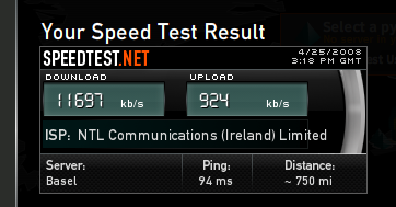

Here my iMac speed result from speedtest.net
