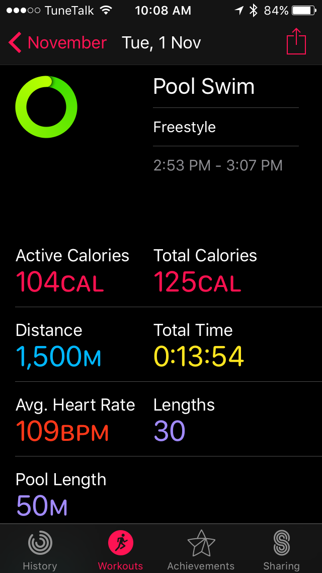

1500m with 13'54"
Used Apple Pool Swim App, actual fact I swam only 400m with rest in between
Also tried Swim.com App, it showed the distance correctly, but stoke count was inaccurate, did 24 or 25 strokes, the app shown 21 or 22 instead.
Today I'm going to try Myswimpro app.

Did you have the pool length set correctly?
I got a similar result in a 10 yard hotel pool recently. I'd inadvertently left the pool length set to my usual 25 yards. The watch still counted the number of laps/lengths correctly (based on the number of turns detected, presumably) but multiplied it out by the wrong pool length. So my speed was grossly inflated 🙂
That's quite odd as my swim tracking has been very accurate. As Arran mentioned, do you definitely have the pool length correct?
Yes, set the length correctly, it's a 50m pool, as you can see from the screenshot.

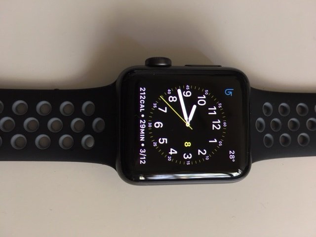

The only unusual thing I did is wore the watch on left hand, digital crown on left side.
and is your watch set for that? if not, you may be messing with the accelerometer (which is how it gets the data..)
also, i'm wondering, are you running both the swim.com app workout and the stock workout app simultaneously?
We can change the watch orientation on iphone, afraid setting Digital Crown on the left side turn the watch upside down, and messing the sensor.
Will set the Digital Crown back to the right side for my next swim on Tuesday.
I quit the Apple Swim app before changing to Swim.com app.
if i understand you right, i think this may be a bug in watchos. i have 2 apple watches and like to wear my overnight one on the "wrong" wrist. when my other one died early one day, i set it correctly to the left wrist and chose the right place for the digital crown - but it was upside down on screen. a reboot of the watch without changing any of the settings brought the screen back the right way up.
Problem solved.
After changing the digital crown to the right, the Apple Workout app made no mistake this time.
I even dive into the pool to test.
But won't use the Apple app any way, as it is too basic, during the workout not even have the current pace shown on the watch.
Digital Crown on left side :
