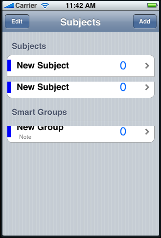

Hmm, I just realized that after deleting a row, then adding new rows, I start seeing weird GUI inconsistencies as well.😕

Hmm... It seems like this might be an Apple bug? I built the *most basic* UITableView I could, and any reordering/deleting caused this flaw.
When I switch to a "Plain" table view, however (as opposed to a "Group" table view), there're no issues. 😕
Edit: This issue remains unfixed in the new Beta 4 of the SDK, I've filed a bug report with Apple. If I hear anything back, I'll post it here.
Edit 2: Got an email back from Apple. It's a documented bug, and they're working on a fix. 🙂
