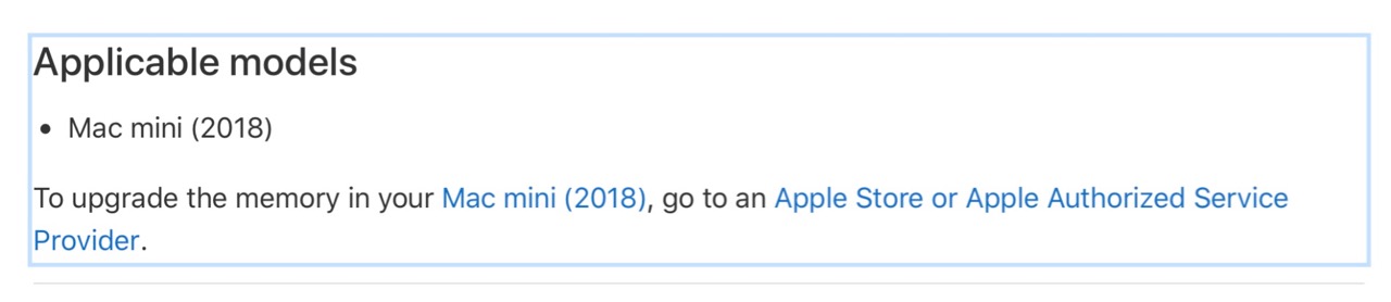

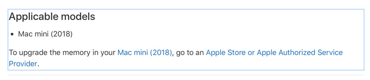

I called Apple Tech Support and they told me I would void my Apple Care+ warranty if I upgraded the memory myself. I called the Apple store and they will only install their memory for a price of $400 for 16gb and $80 for 32gb. Crazy prices. Why is everyone on this board saying you won't void your warranty if you do it yourself?
You only void your warranty if you damage something doing it. If you upgrade your RAM and next month the power supply fails that's unrelated. They would have to cover that. Not Apple's decision it's law.
It may be the law, but if they have evidence you opened up the Mini and serviced it, they’ll probably find a way to use that evidence to deny a warranty repair regardless. I wouldn’t spend the money on AppleCare+ if I intended to upgrade the RAM myself. I’d spend it on RAM instead 😉 The only official statement from Apple regarding RAM upgrades is from the screenshot above, right?
First of all, I have been told by staff at two of the New York stores that they were instructed to say that it will not void the warranty. Secondly, the screenshot does not in fact say that installing RAM oneself will void the warranty. Thirdly, I think that Tim Cook and staff have better things to do than spend their time trying to figure out how to void a warranty, in the process violating Apple’s legal obligations, on a problem that has nothing to do with RAM. That kind of behaviour runs counter to every dealing that I’ve had with Apple staff over a period of ten years. Finally, I have purchased AppleCare+, I am installing RAM myself, and I am not worried about this. If you are, then don’t do it.
