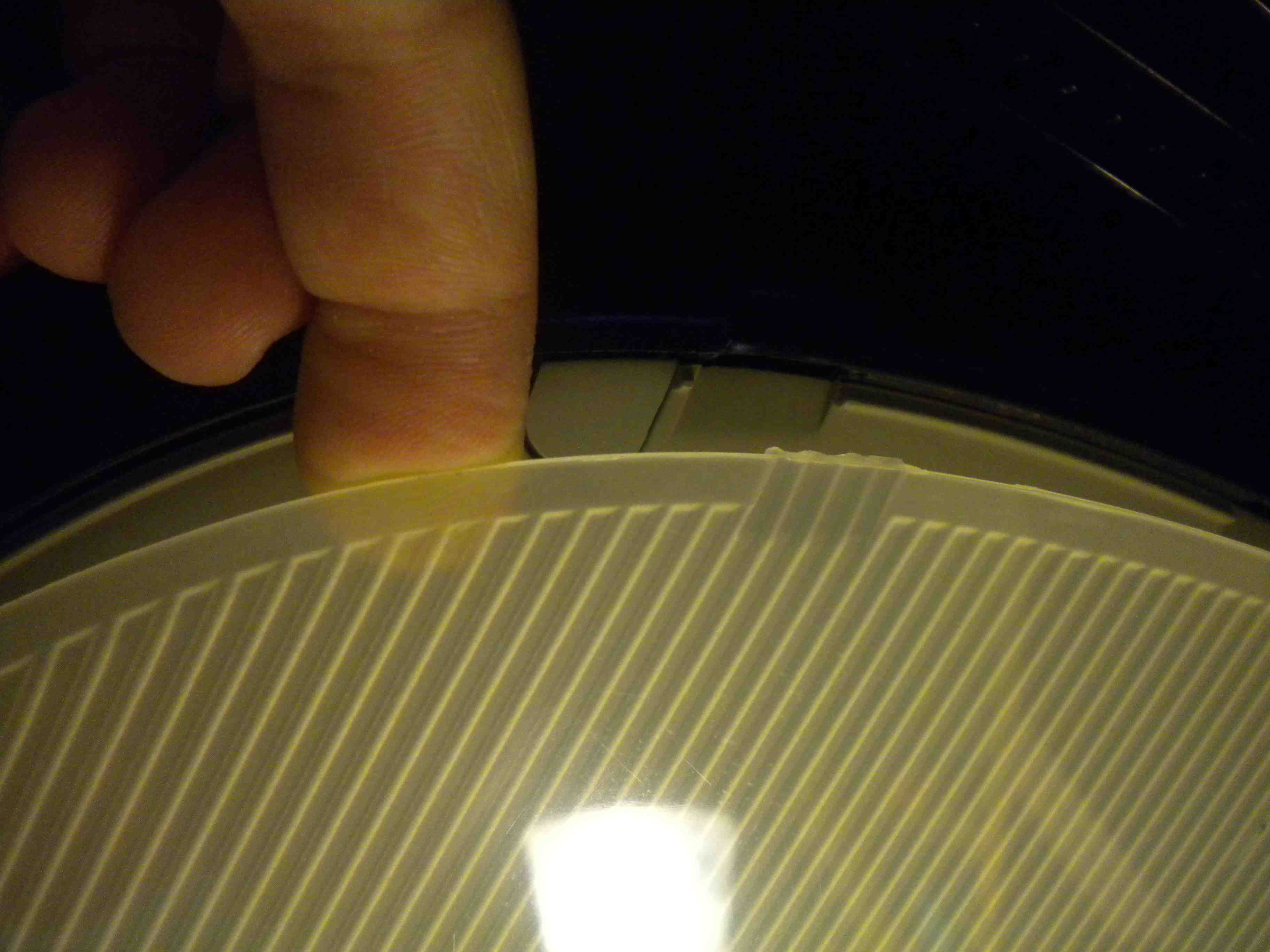

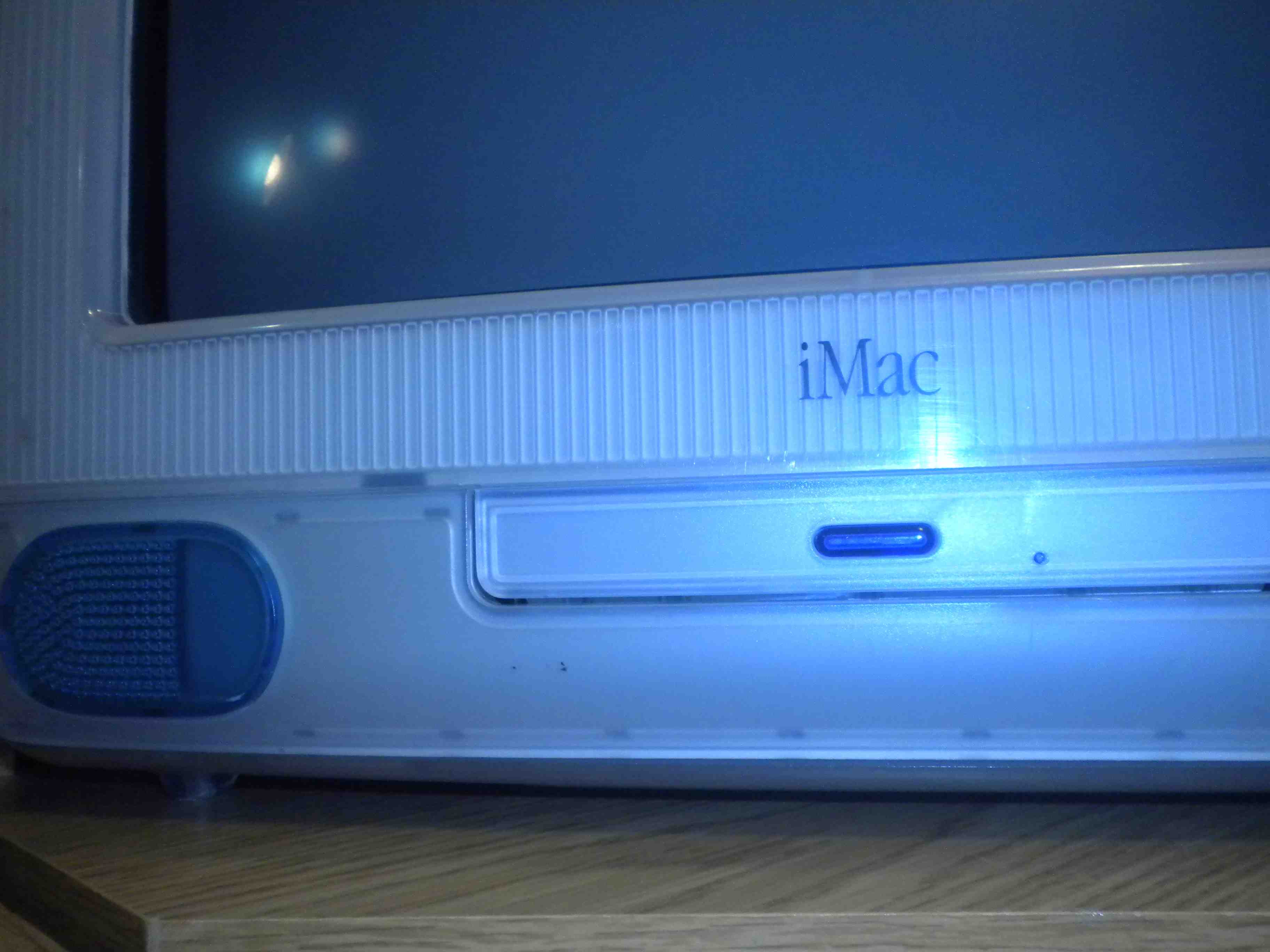

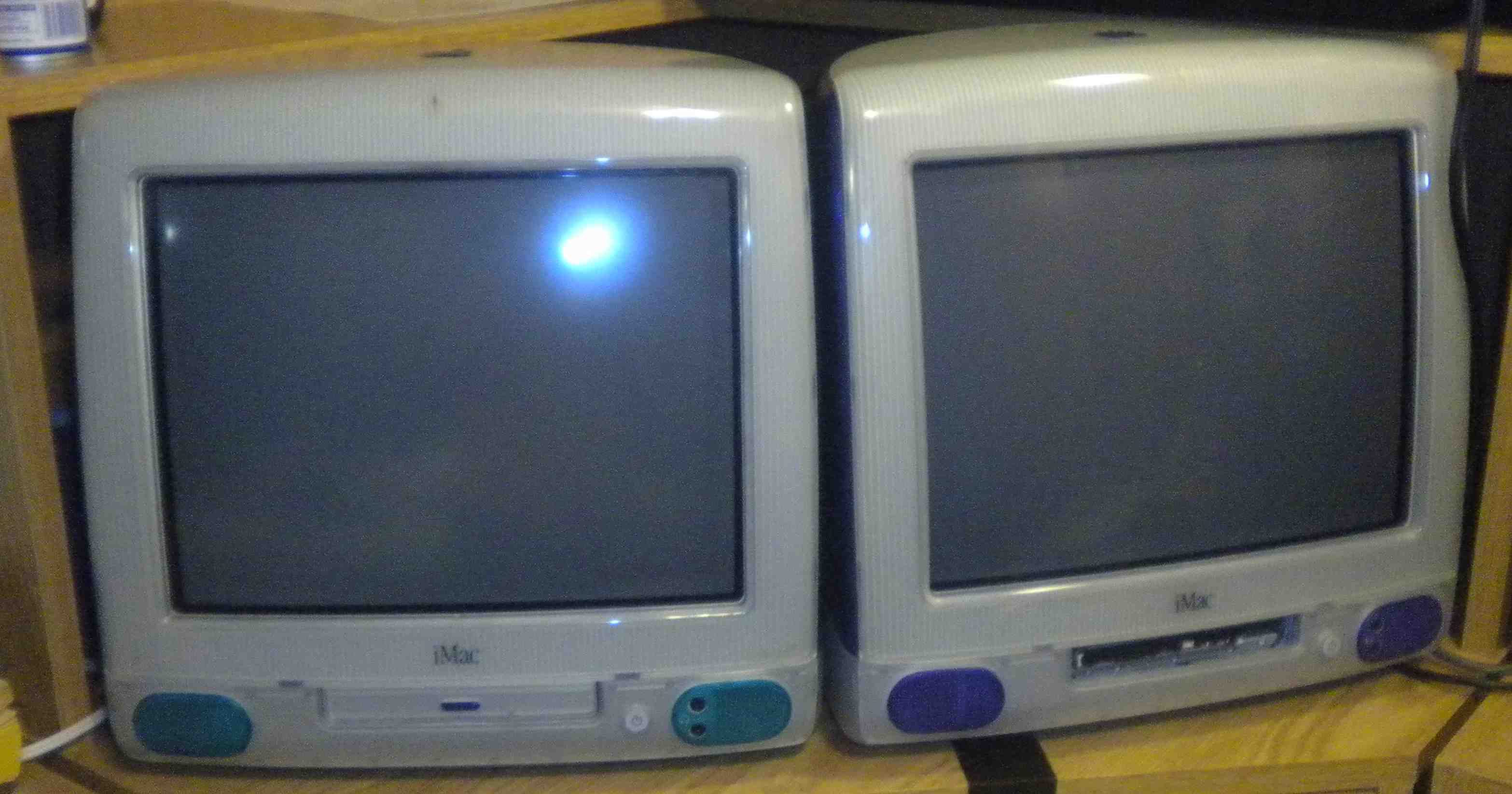

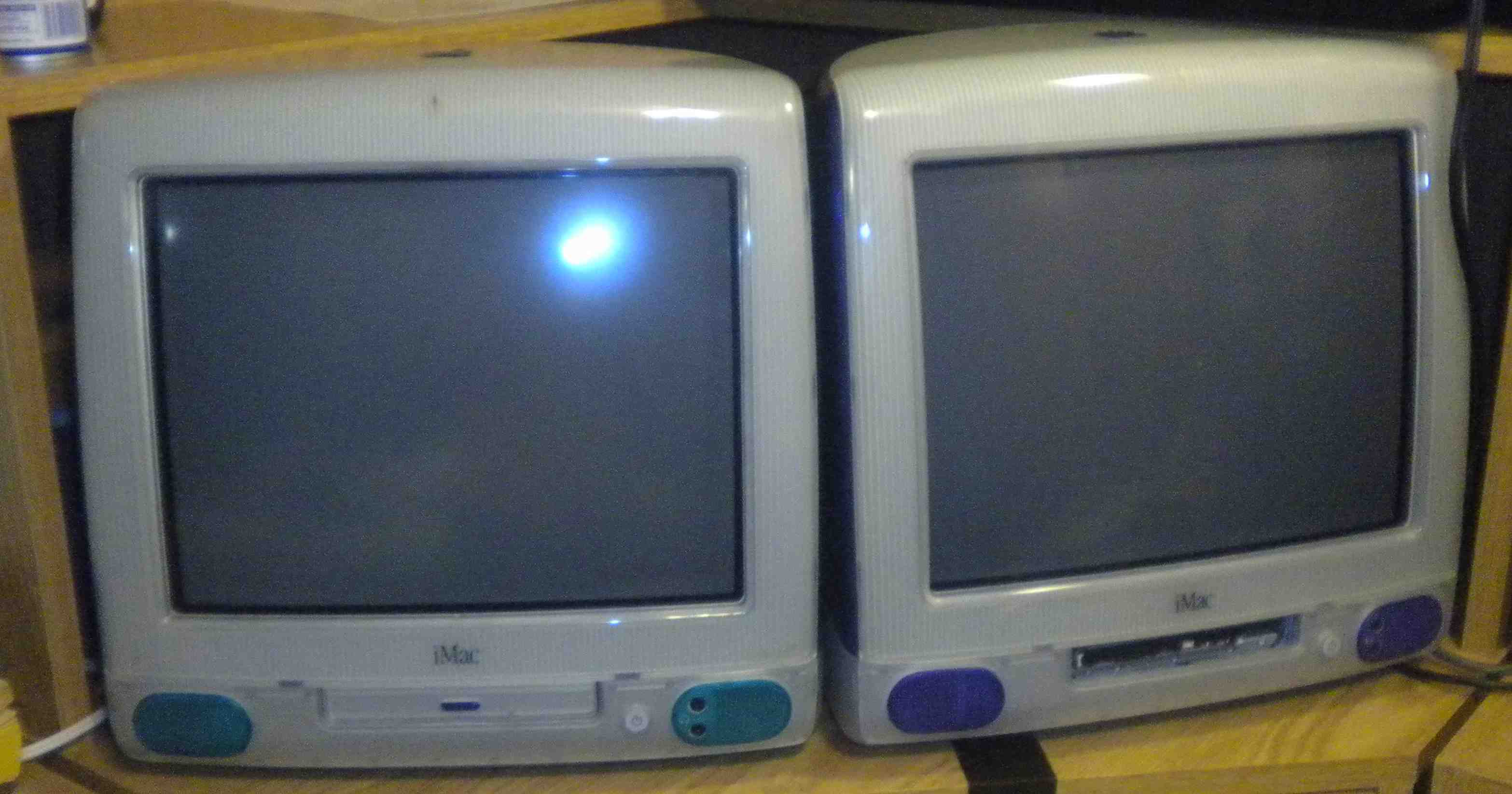

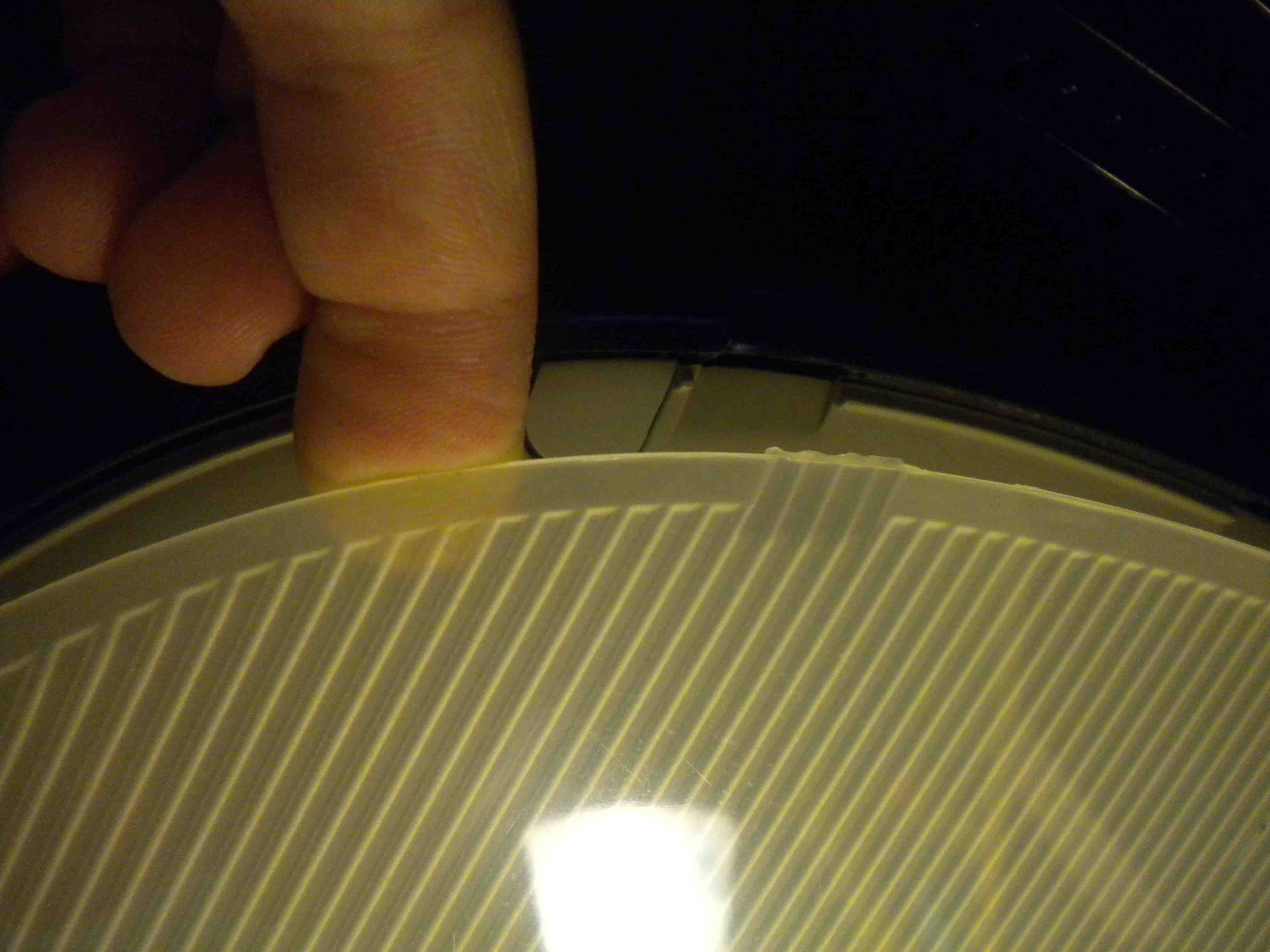

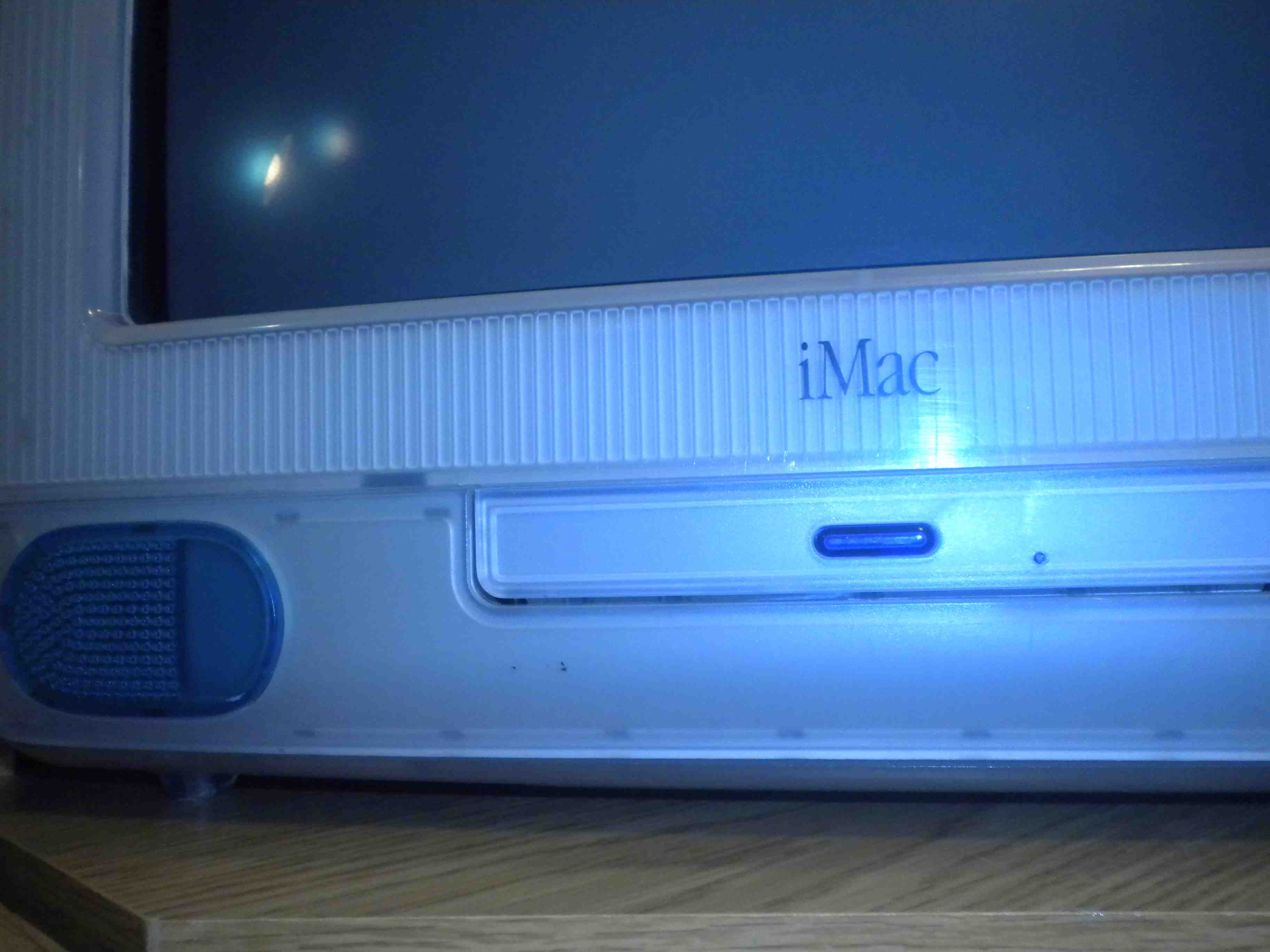

The Grape iMac has some case damage... See the attached pics.
In the first attached picture, you can see both of the iMacs sitting next to eachother. In the second one, you can see the mismatched drive cover. And finally, in the third one, you can see the case damage on the iMac. That cover isn't supposed to come off like that...
