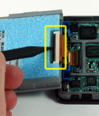

The black thing they are lifting up in this picture - the clamp for the ribbon cable. It's not on there and now broken in 2 pieces as i tried to get it put back in there.
