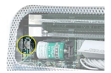

As a last resort try unplugging it (or turning off the power strip) and then starting, or hitting the PMU reset switch (just one time after grounding yourself).
I have tried the PMU button and it did nothing. I can't even boot into OS9 off the harddrive. The internal CD won't boot. Right now the only thing that I can boot off of is an external CDRW using firewire. And I can't boot the OSX cds. I got the 9 cd to boot and rebuilt the desktop. Nothing changed. I ran my Norton cd and the only problem that could not be fixed was that it said it had multiple system folders. But still it just shows a broken folder when started. Any more help? I don't even know what would cause this error.
