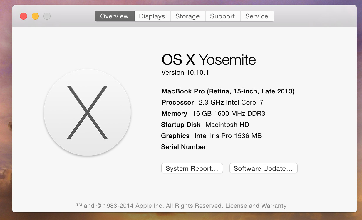

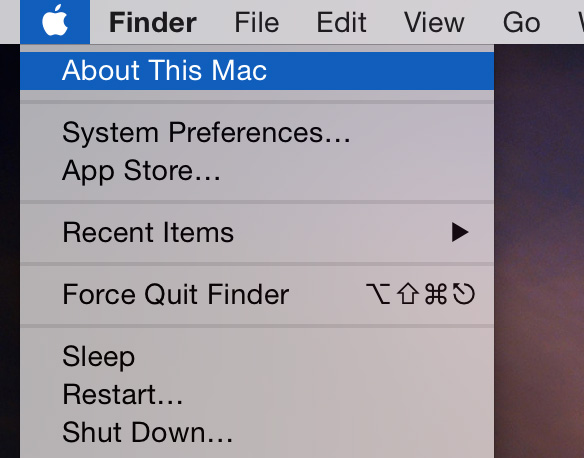

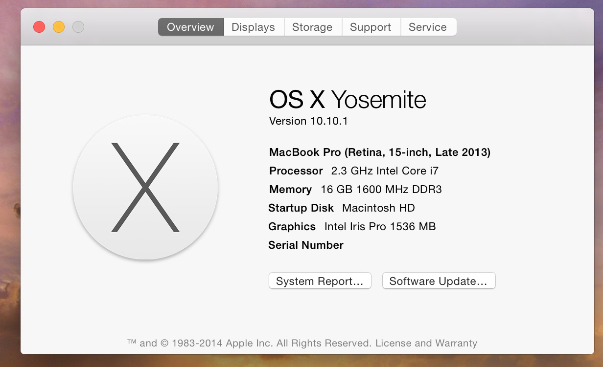

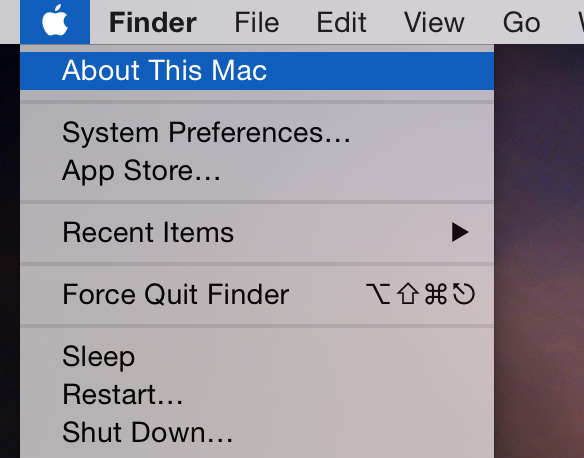

First things first, what MacBook Pro do you have?
You can determine this by:
1) Clicking the Apple menu
2) Selecting "About This Mac"
3) Looking at the top line of the subsequent box.
