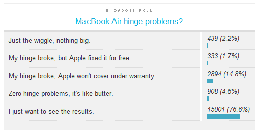

Engadget has the fanboys and Apple haters going at it over the broken hinge issue. I was curious as to how widespread the problem was here.
http://www.engadget.com/2009/02/26/macbook-air-hinge-defect-not-covered-by-apples-warranty/
I HARDLY call people who want a notebook to not have a faulty hinge haters. As with any forum type setting though you'll get the ones who want to yell "HA HA" to anyone with what many people see as an over-priced netbook.
So far my hinge is good, but like NC said ... only time will tell. I don't detect any play either but I did not use mine daily until about 5 weeks ago.
It's refreshing sometimes to read comments from non Apple sites. Haters versus clueless fanboys? I'll take Haters any day because at least they err on the side of skepticism instead of fanaticism. That comment from the one fangirl cracked me up though. She was boasting about how awesome it was that Apple took care of her the 10 or so times she had to bring her machine in for service. Apple would probably lose my business forever if I had to bring my machine in more than twice. I won't touch a Compaq notebook ever again because the hinge broke on one I had a long time ago.
Anyhow, the poll they had seems a bit suspect though. Are there seriously 3000 Macbook Air users that both read Engadget and have had their hinges broken AND Apple refused to fix it under warranty? That's hard for me to believe.

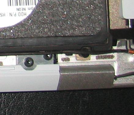

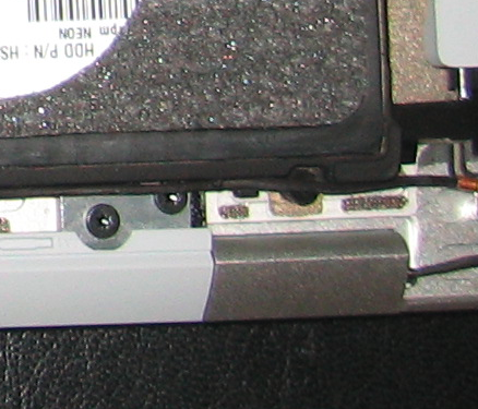

Opened my 11 month old REV A. last Thursday and heard a pop/crack and sure enough, the hinge on the ports side had come loose. Made an Genius appointment at the Vancouver Apple Store for the same day and was told it would be replaced under warranty this one time. The repair would have cost $700 otherwise. Read the engadget post on the way home from the store. Yeah, weird coincidence! Got it back on Saturday and the screen is as tight as can be.
Before the repair, the screen/lid did exhibit quite a bit of play which I do believe may be an indicator the hinge may come loose. In my case, it was the part of the hinge that attaches to the unibody that popped off.
For those with "sloppy" screens, it may be a good idea to open up the bottom to make sure the screws are tight. Unfortunately you cannot check the ones that attach to the screen as they are hidden behind the bezel. The ones on the unibody are star-shaped as seen in the attachment.
I hope this helps 🙂
