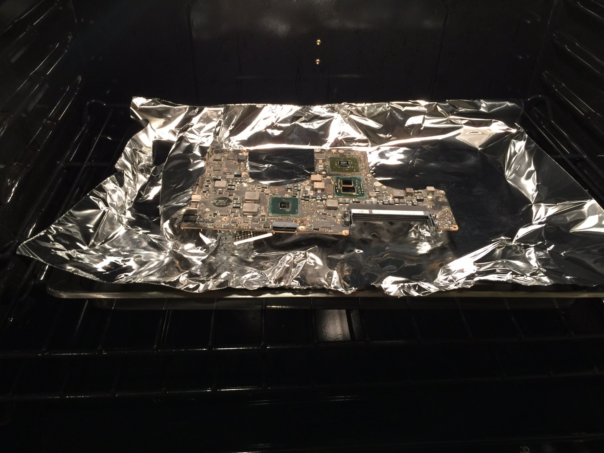

I’ve done it a few times on my MacBook Pro 17”. Bad solder on the graphics chipset would cause kernel panics if it switched to integrated graphics. I took the time to pull the logic board out and lightly bake it.
That said, 120F would be way too low to do anything to solder. Some capacitors can react to high temperatures, so I could see a bad capacitor getting a bit more life from a dose of heat maybe. Thermal expansion of various components might also restore enough of a connection on a loose component.

I’ve done it a few times on my MacBook Pro 17”. Bad solder on the graphics chipset would cause kernel panics if it switched to integrated graphics. I took the time to pull the logic board out and lightly bake it. View attachment 2126905
