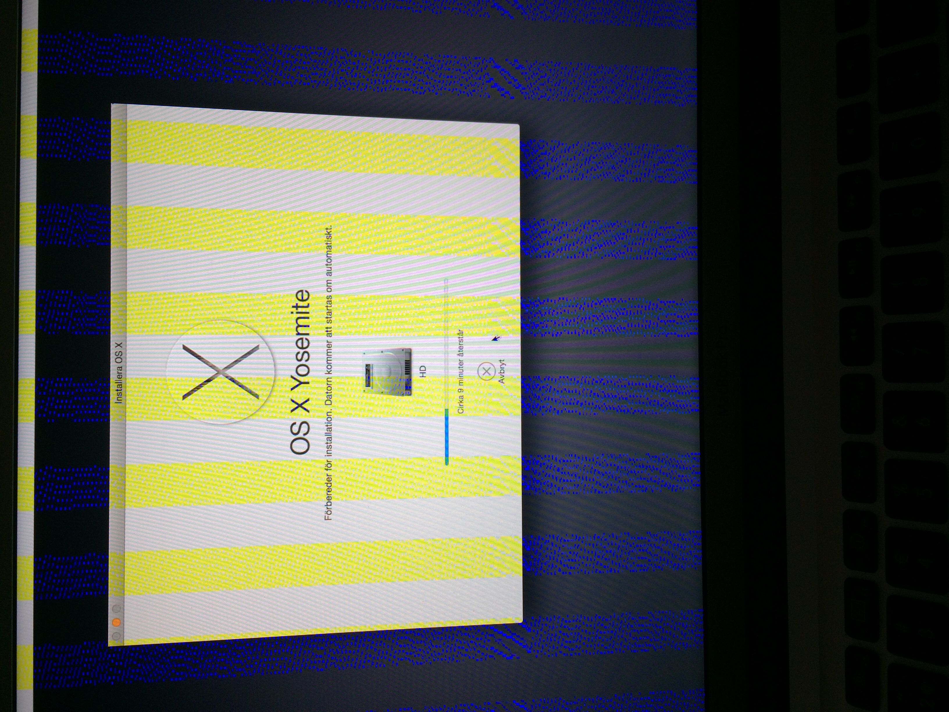

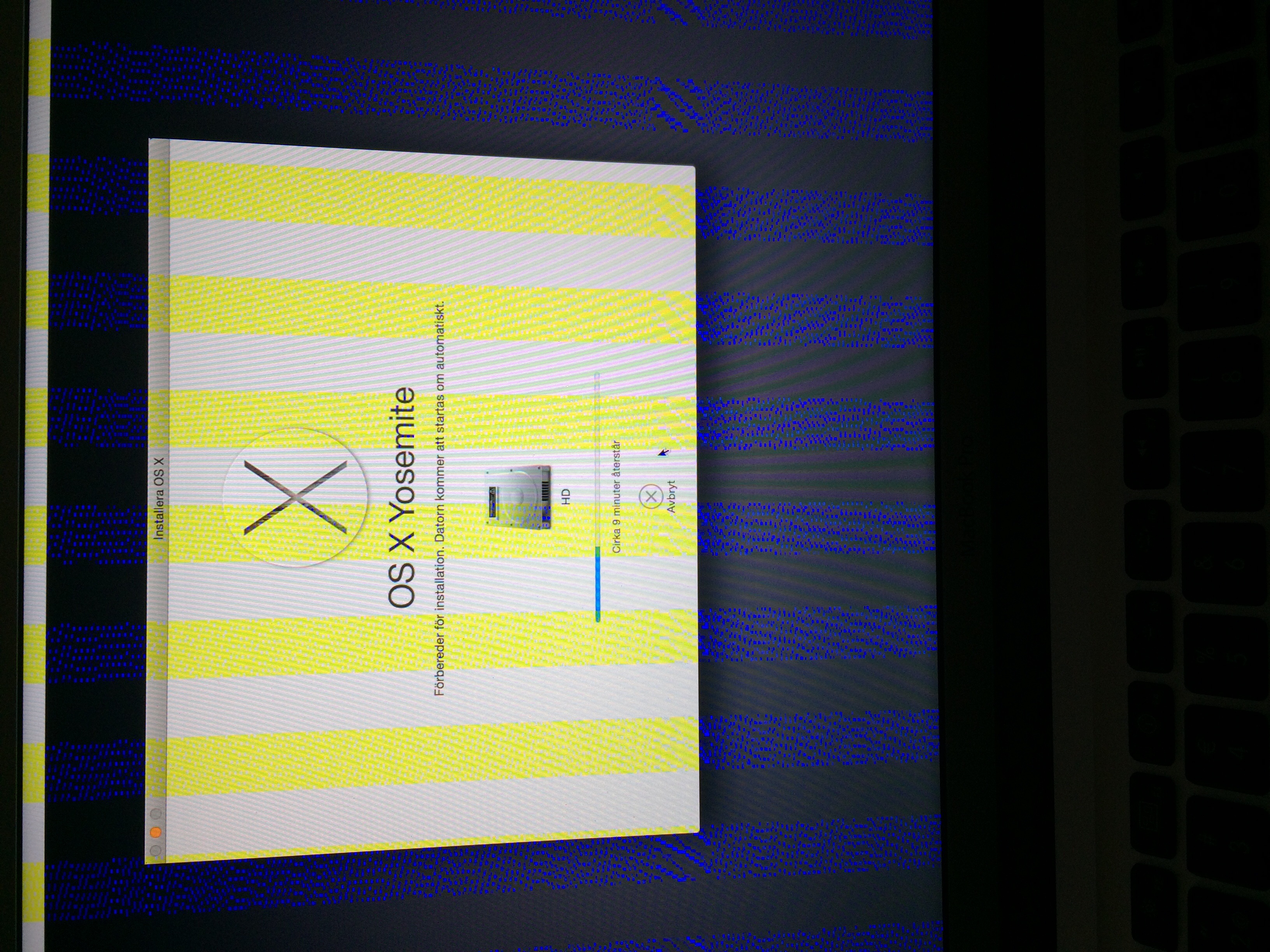

My early 2012 MBP has started to act weird, never waking up from sleep mode, freezing randomly and sometimes shows what I belive to be logic board issues. I am trying to reinstall Yosemite to see if it makes it any better. I recently installed a SSD HD in the machine, could that have anything to do with the issues?
Attached is an example of the screen issues that occur.

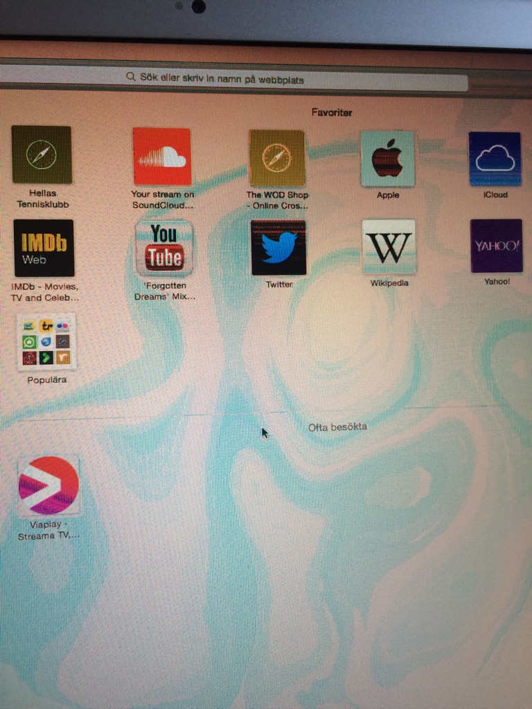

So I went to an Apple authorized retailer to get the issue fixed according to the exchange program.
I got the logic board exchanged but when I booted it up after the repair the problem remains. I still get graphics issues on the computer, sometimes it dissappears and then comes back (see attachment).

I dropped off the computer again to have it fixed and they changed the logic board another second time. However, the screen issues remain although now they seem to be more tied to how the screen is aligned (if I flex it backwards the flickering might stop and vice versa).
It seems totally random as to when the noise/flickering/distortions appear. The technician said that the problem lies in the display.
Could it be the case that the overheating from the broken logic board could have affected the connections to the display, and that could be the reason for the distortions?
Any advice on how to proceed? (Buying a new screen with the risk of paying 800 dollars down the drain does not feel like an option). I think I've read somewhere that under EU-law there is a 2 strikes for repairs then replacement option, would that be viable to pursue?

It's the display cable or its connection on the display itself. Exacerbation of the issue by display movement is pretty solid proof of that.
Also, multiple repairs of the same component, as far as I know, is what that applies to. Although interpretation of specifics of its application is probably up to your service provider. Most would probably replace after multiple repairs to a system, even if it were different parts repaired each time. That's seems to be the most common interpretation anyway.
If you paid for the repairs up to this point, then it's probably safe to say that those replaced parts are perfectly fine. So, if they replace the display, you should only be charged the difference between display and logic board replacement. You shouldn't have to pay for an entire display replacement. After all, payment of problem resolution is the target here, not payment for them to do poor troubleshooting.
