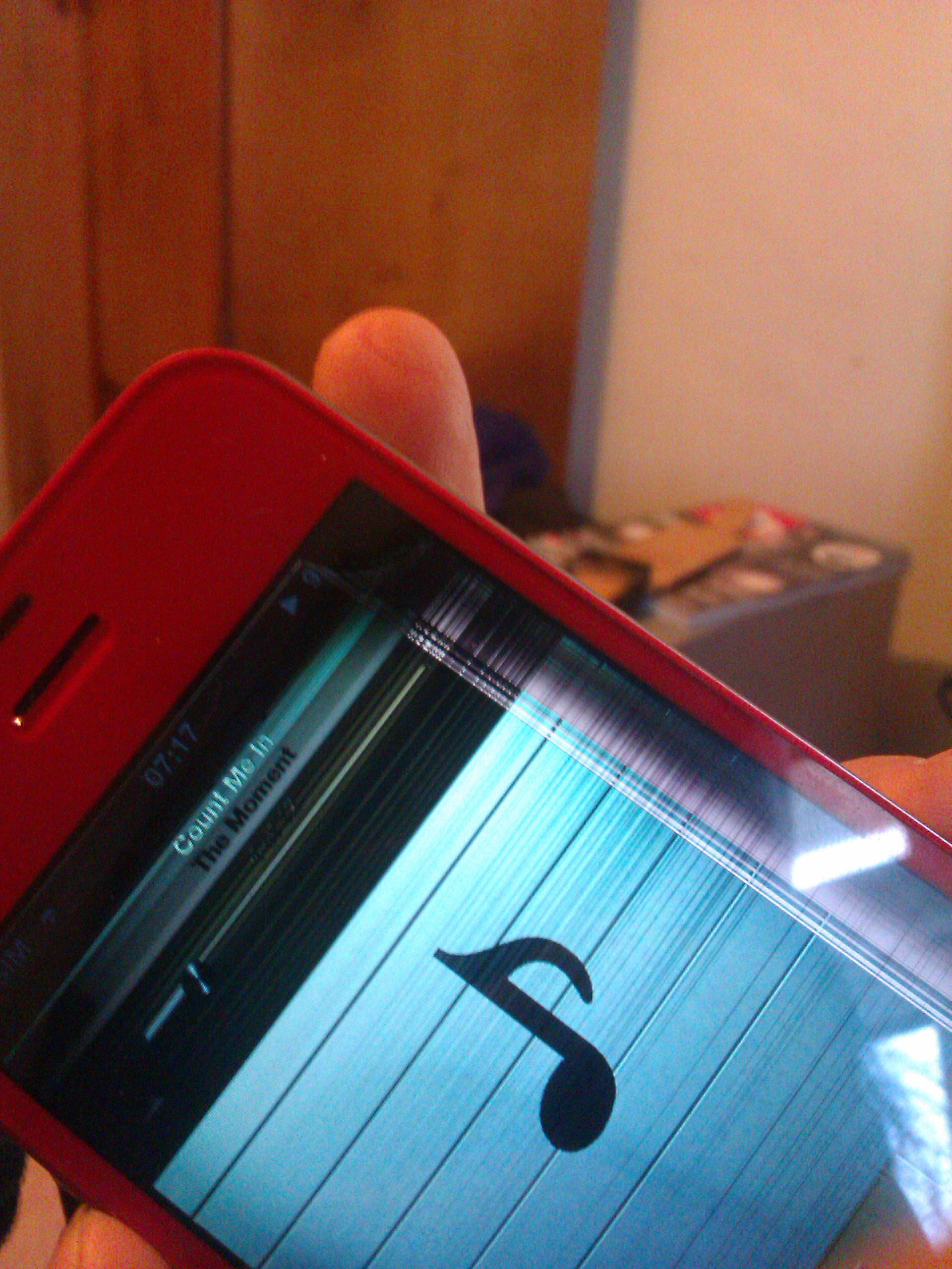

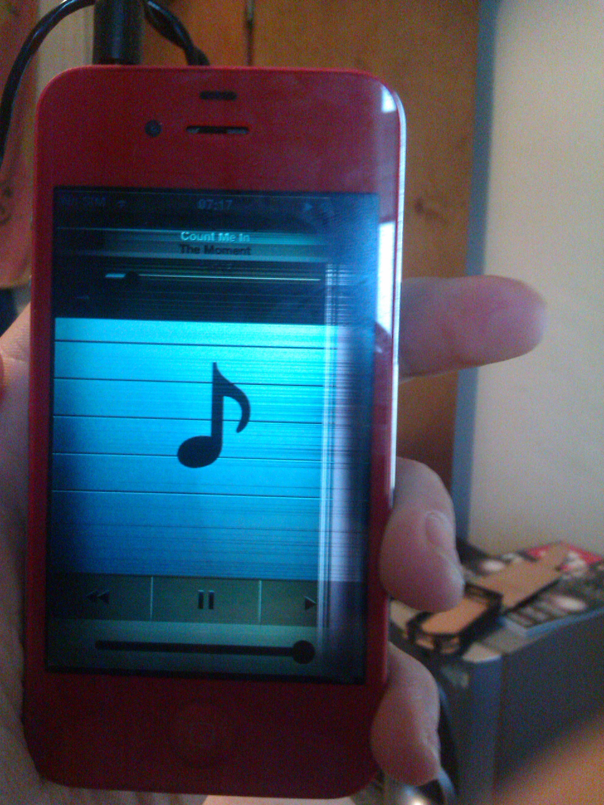

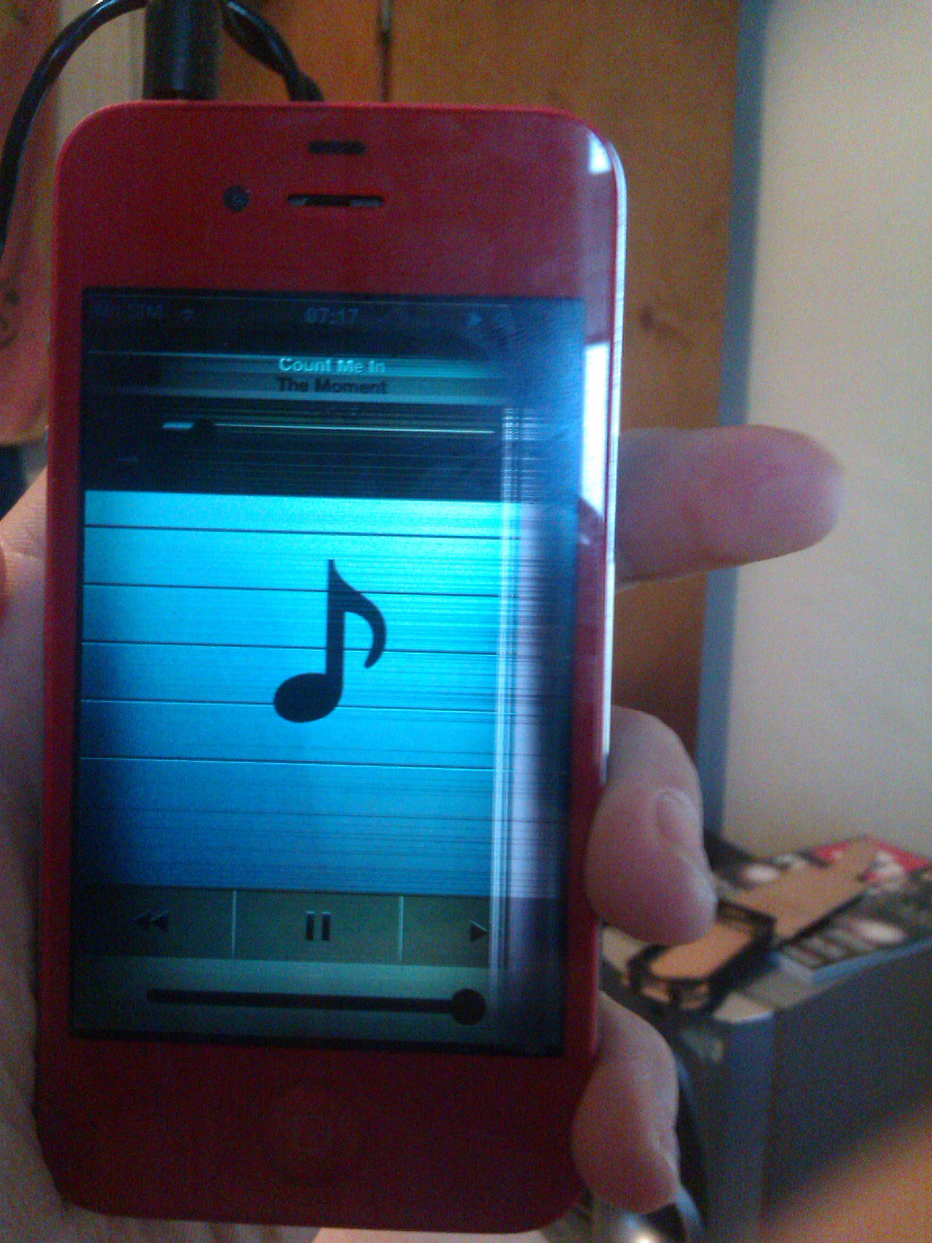

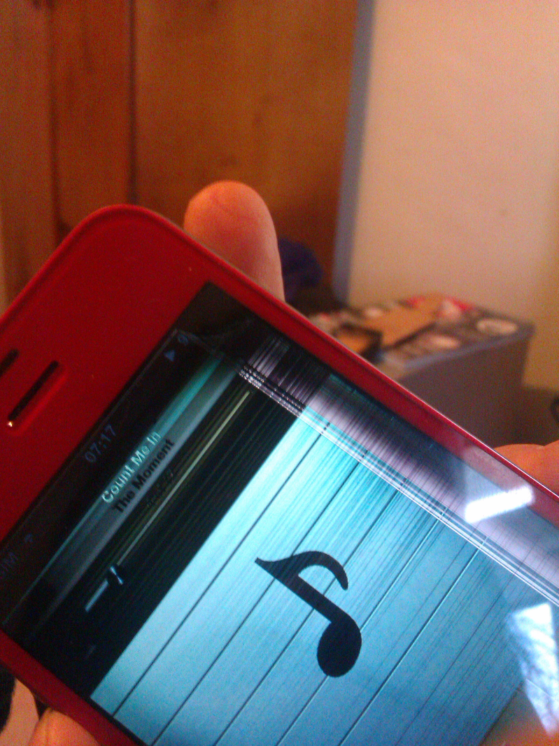

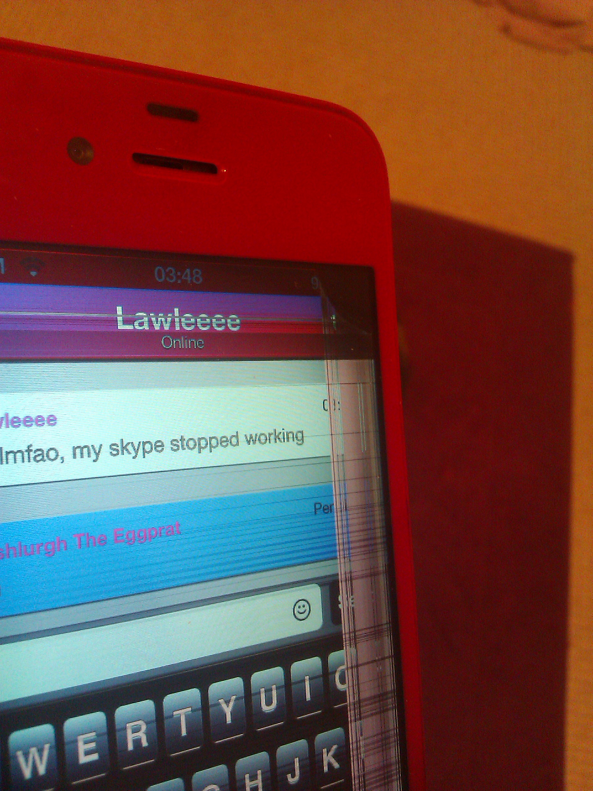

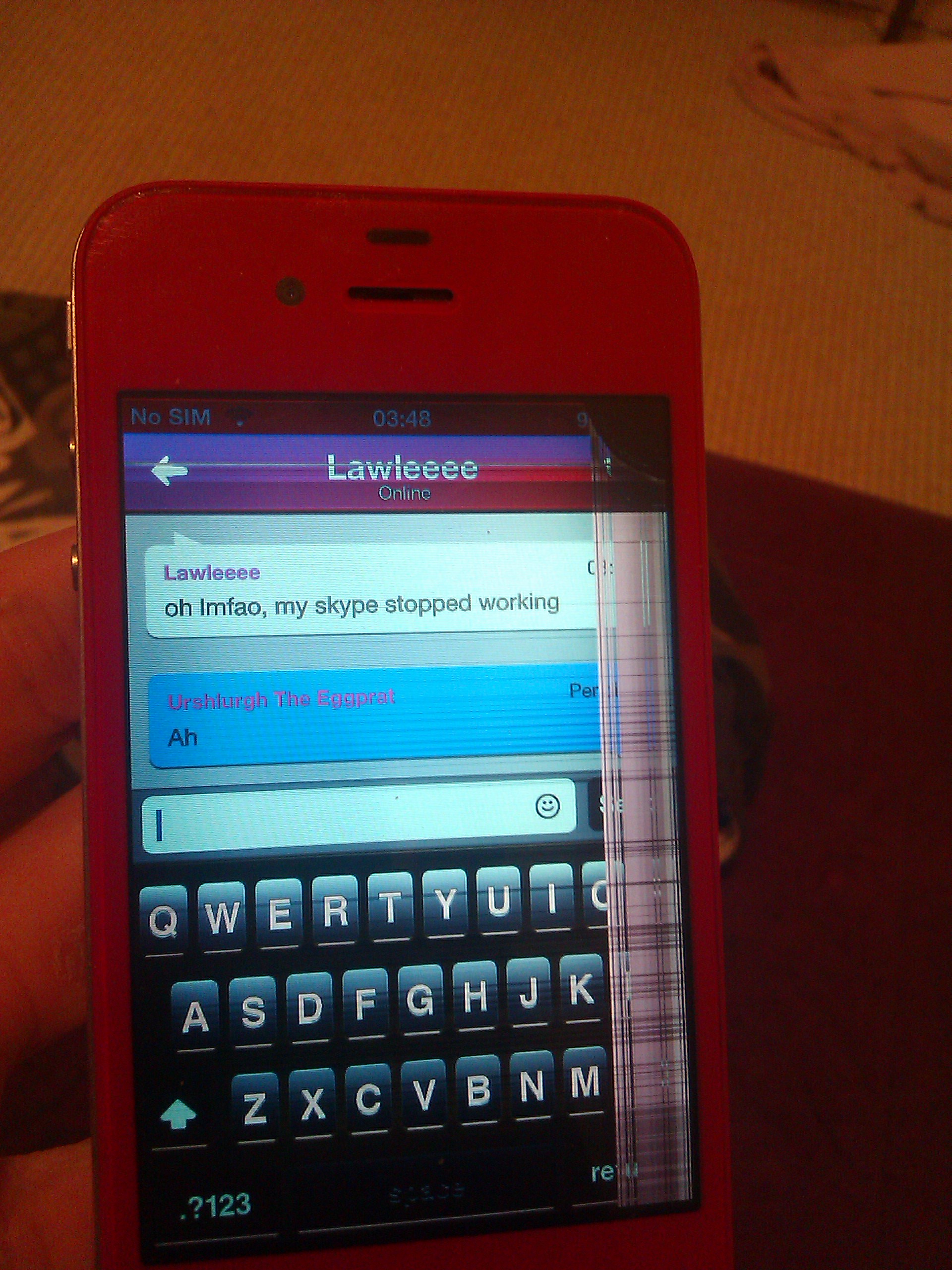

I was recently given this iPhone 4 16gb from a friend who had broken it.
The screen has lines and a black blob in the corner. See attached pics.
I also uploaded a video to Youtube HERE.
In the video you can see the colours are all wrong and such. Apologies in advance for the potato quality, btw.
So basically I want to know, is this definitely a broken screen? I imagined there would be apparent physical damage.
It was dropped on a hard floor if I remember correctly.
Something to note is that it's had a screen replacement before as you can probably tell from the red casing. So before I drop £20 on a replacement front assembly, could it possibly just be a loose cable from the drop? Or is it almost certainly broken?
Thanks, and sorry if this was kind of long winded.
It looks like your friend used cheap parts for the screen replacement.
The LCD is bad. You need a new assembly.

Definitely seems like a bad quality LCD from the looks of the video. Your LCD MAY not have broken. This can sometimes happen when the LCD flex cable is not properly secured to the logic board. Its could just be a matter of re-setting the LCD flex cable.
If that doesn't work, you can be 100% sure the LCD is broken/ damaged.
The black blob in the corner makes me think it probably is broken, but I'll try this if I can get hold of a small enough screwdriver. Thanks for the advice, guys!
