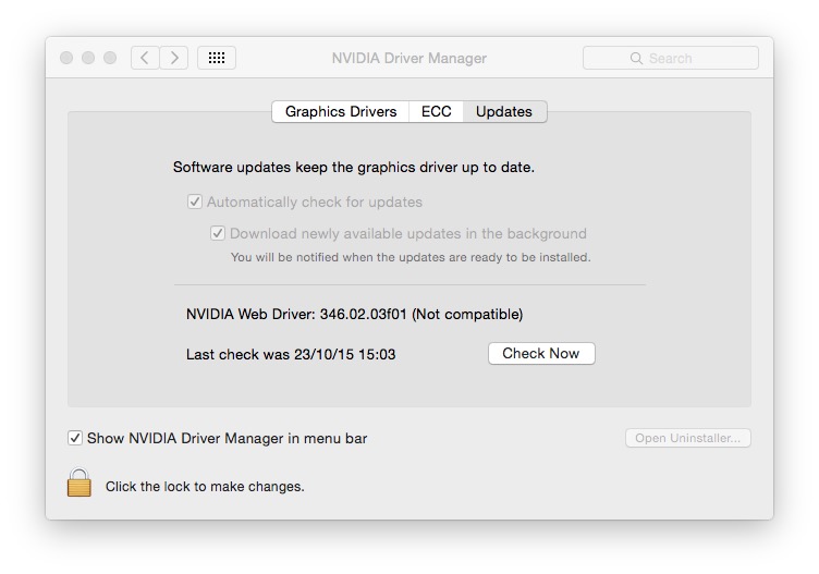

I've been happily using my Nvidia 980Ti in my Mac Pro for the past couple of months with no problems. Even survived a couple of updates within OS X. Most recent Security Update/iTunes update seems to have done nasty things to the Nvidia Web Driver. Driver Manager now reports that the Web Driver is not compatible and checking for an update says there is not one.
Anyone else having this problem?
OSX 10.10.5 (14F1021)
Nvidia Web Driver 346.02.03f01
Hope there is a new web driver on its way, but I'm not seeing any other reports of this problem so I'm wondering if it's just me.
Thanks,
Doug

Yes, the security update changed the OS version from 14F27 to 14F1021. NVIDIA will update the driver very soon, probably today or tomorrow based on their past history.
In the mean time, try using this tool:
http://www.insanelymac.com/forum/files/file/474-nvidia®-webdriver-updaterapp/
if you want to force the 14F27 driver to load on 14F1021.

Thanks Asgorath,
I think I'll check out the tool you mention but at this point I I'll probably just wait for the Web Driver update. I've already pulled the card and thrown in my old ATI's since I need 2 monitors running and have to get work done. Hopefully Nvidia will have the update out by the weekend and I can reinstall the GTX980 then. Glad to know that it's not just some weird quirk I'd have to track down on my end.
Thanks..
D

I always perform a CCC backup prior to any update. That being said I installed the update as well and the computer reverted back to the Apple driver. I downloaded the 10.10.5 (14F Beta} 346.02.03b01 and installed this driver and the computer is working fine. I can still clone back to my previous install but I do not notice a difference in performance or stability, so I will probably just use this driver till the newer web drivers comes out.

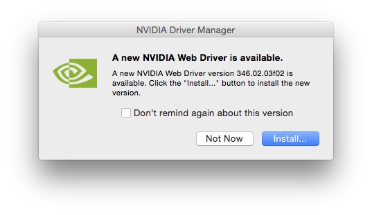

Problem solved with driver 346.02.03f02, thanks NVIDIA!!!!

Yeah, NVIDIA has been very good about releasing drivers when Apple changes the version number of the OS via a security update. Imagine this: what if the security update changed a binary interface that the driver depended on? The old driver would crash or panic your machine. This is the worst-case scenario and is the main reason I can see why NVIDIA would lock a driver to a specific OS version -- they've done all their testing on that exact build and can be confident that it works on that build, but not necessarily other ones.
If you want to risk it, you can always use the InsanelyMac tool to modify the version number baked into the driver.
