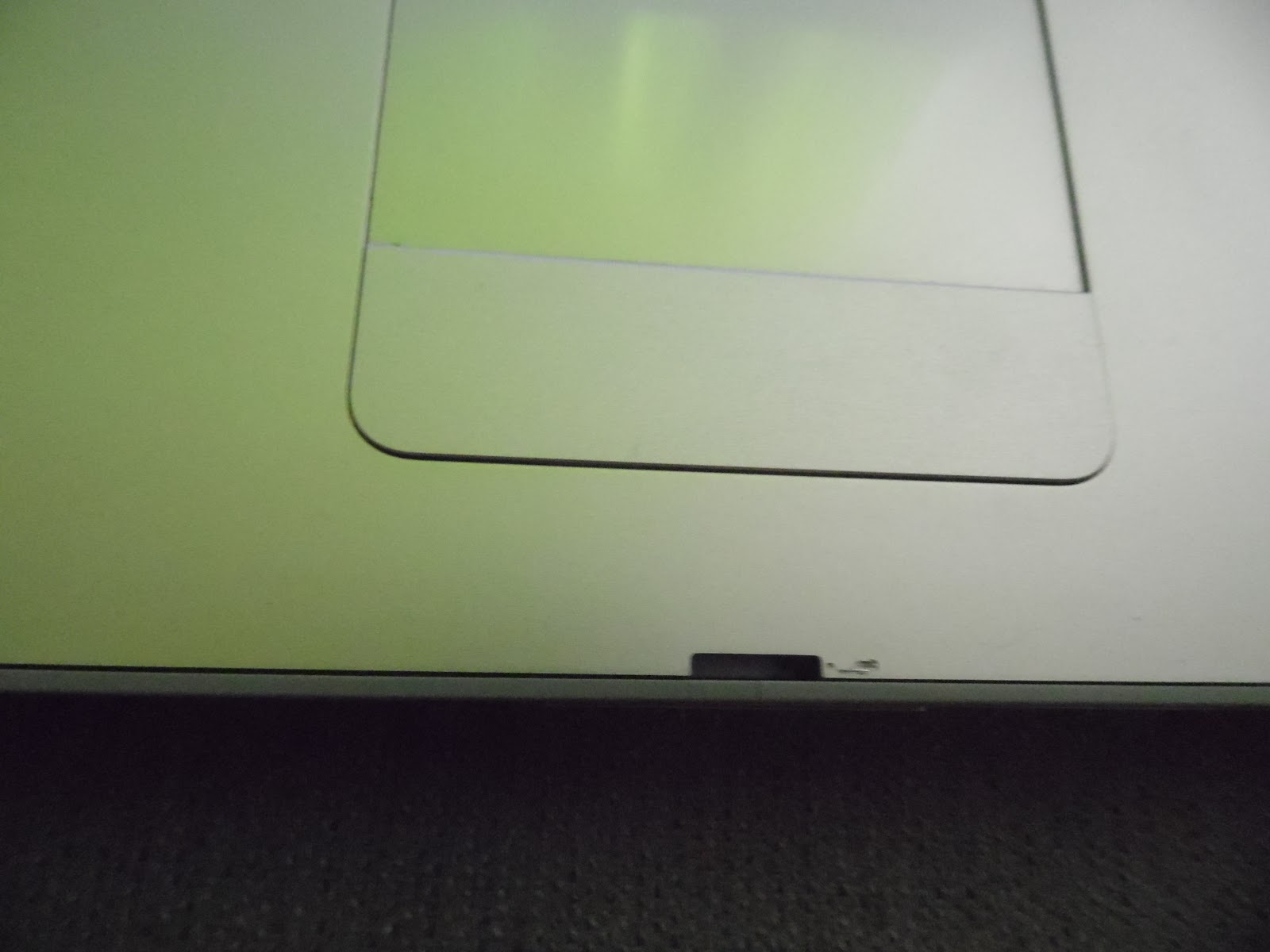

SO my powerbook can't close all the way, it goes to sleep when I close it, but when I pick it up you can clearly see that it is not latched down. AND its not the latch thats broken its the metal piece it hangs on to (below the touchpad), it's beyond me how to fix this one 🙁 if therererers a way I'd love to know, or other ways to keep it closed like a universal Lock idk maine apples:apple::apple::apple::apple::apple::apple::apple:

A Picture is worth a thousand words

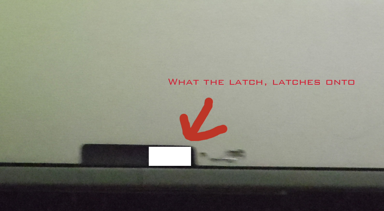

SO as you see it should look like this:
Thanks in advance for the photoshop complements, SO it has nothing to latch onto, I've tried glueing the broken off part back on , but its impossible. and the button to push it back is not being pressed in the picture. halp 😕

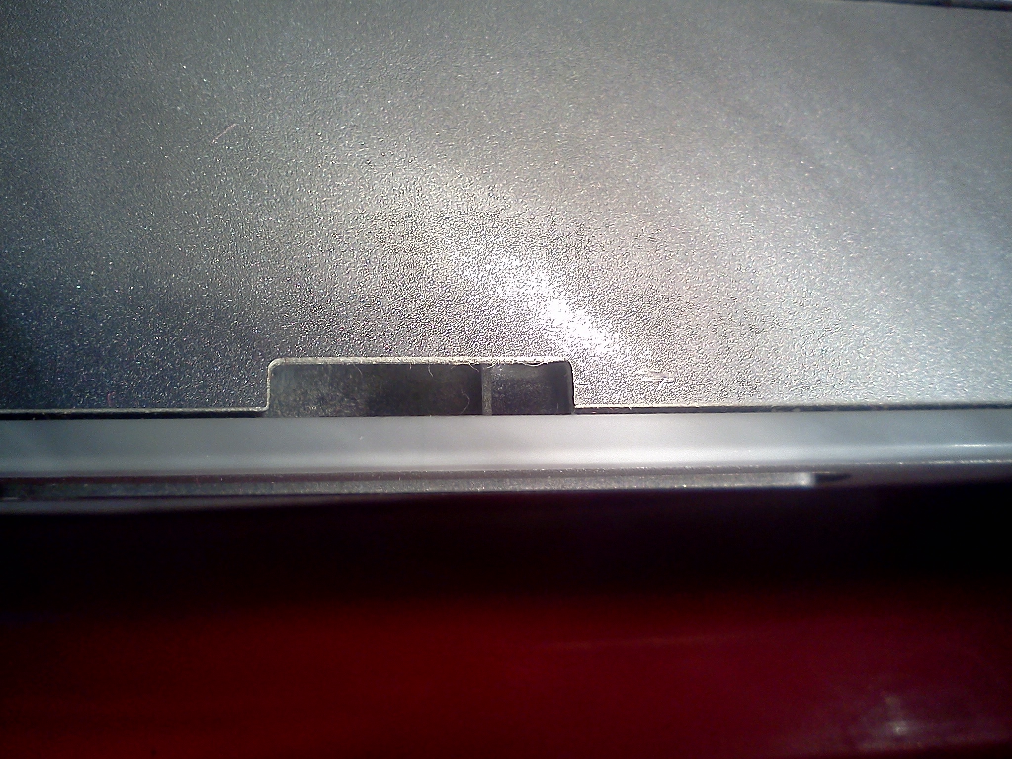

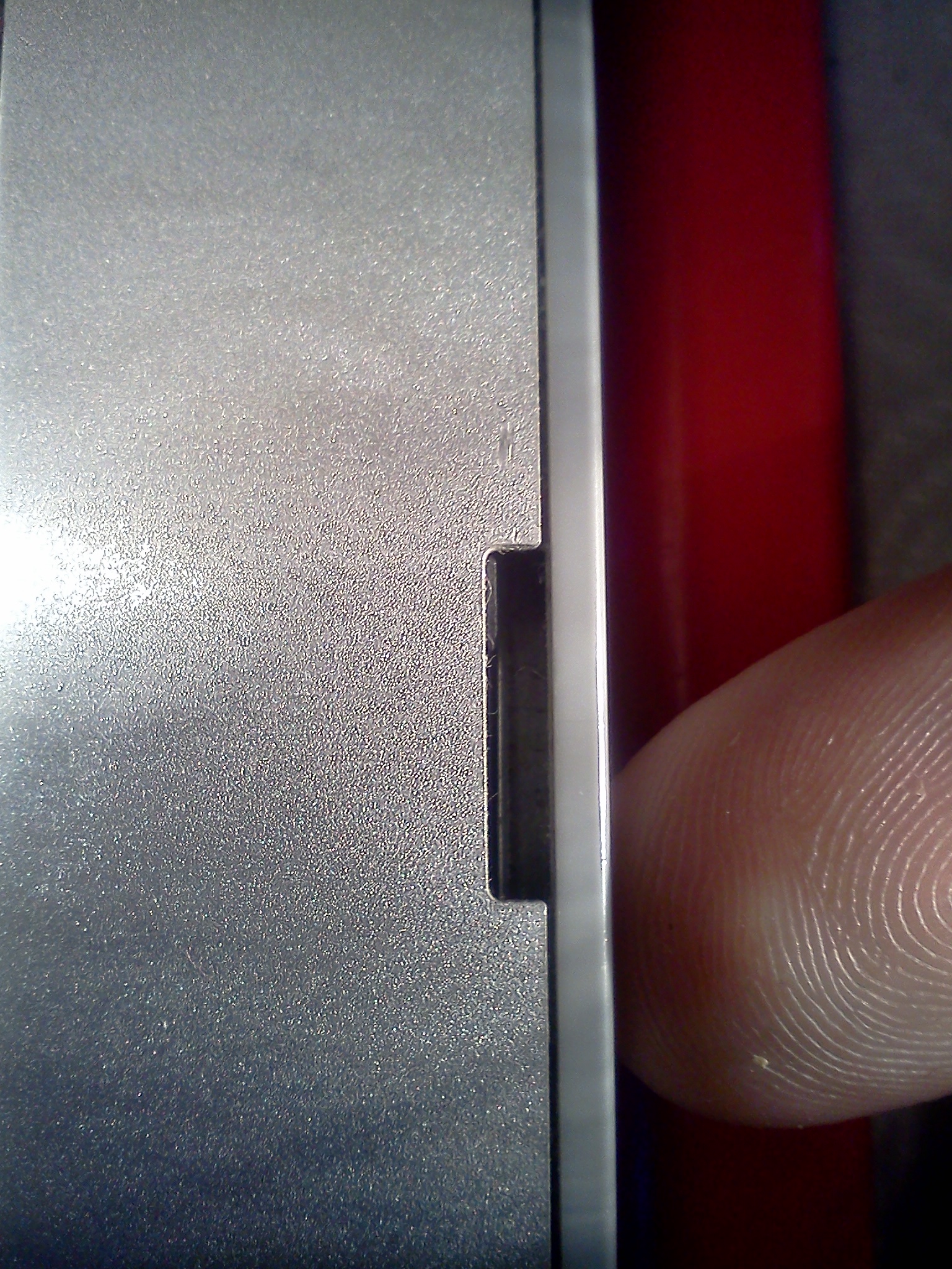

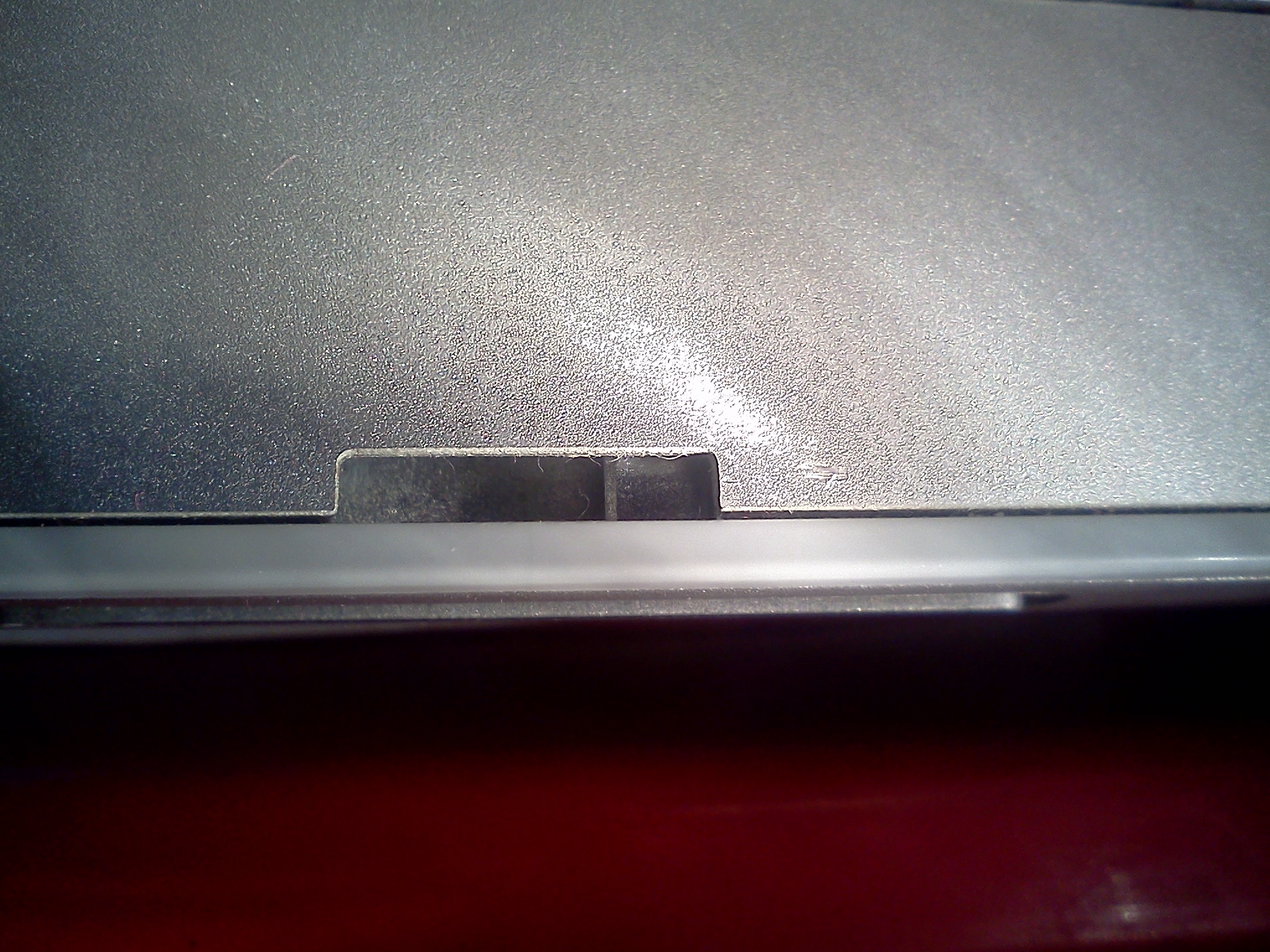

I uploaded some pics of mine,it looks to be all one peice so more than likely you'll have to do surgery.I havent even paid much attention to this when I have the front cover off but you might be able to just lift the keyboard to fix it,somebody will know.

Based on the photos I am seeing here, I'm guessing this isn't the issue in this case. Perhaps, if someone runs across this though that has the issue I had they'll be able to use that.

AND tried to super glue a chopped toothpick in place of the metal part, but it wasen't good enough to hold the hook in place 🙁 also I don't own pliers so shaky hands and all that doesn't help lol I was thinking though.
there could be a universal like suction cut that you could put on the top of the monitor were it would suck to the place around the trackpad, then when opened it would just release. Does it exists? or did I just give away a good idea?

I don't know if this is feasible or not, but there's a product called JBWeld that bonds metal to metal. If you can find a scrap of metal, maybe you can use JBWeld to bond it to the part. Don't know if it will work on aluminum, but it's worth a shot. You have to let it cure though.
The original JBWeld was intended for automotive purposes (I've used it on my car). It can withstand 500º and once cured the only way to get a part unbonded is by grinding it down.

The problem with this is that the area to be bonded is just so so small and too much of anything would crowd it up.Jb weld is a good idea if you had some laying around get a good smooth layer around it and use a dremel or something to grind smooth but if you had to go BUY some the stuff has got high and a latch lock on ebay will be no more than $2-3 more than a new tube of pretty much any good bonding agent (besides superglue)...................................and trust me I am all for modification and I've looked at it and looked at it and I got nothing so if you do get it through sheer ingenuity I wanna know what u did.
