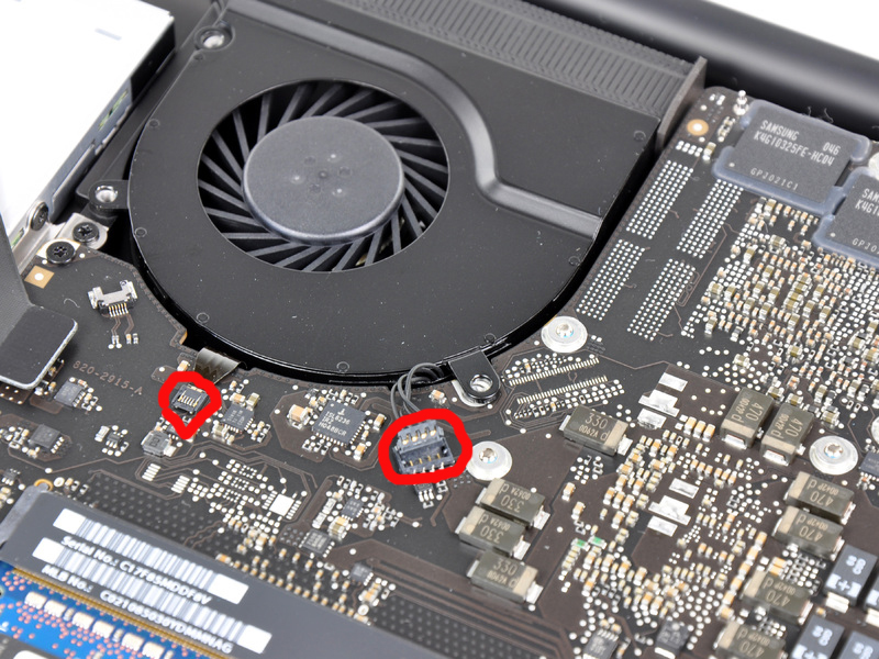

I was taking the right fan off and pushed too hard on the connector which then broke off the logic board, I also managed to brake off another cable which I think is the backlit keyboard since it no longer lights up. Where can I take this to get fixed or do I have to replace the logic board? Could I possibly fix it myself? I attached a picture and circled the plugs which I broke.

Those just look unplugged, or partial damage to connector clips. Are the pins still mounted to the motherboard? If so, glue / epoxy in place.

That's not the actual picture, it's a sample image just to point out which connectors where broken!
Well, finding someone who can replace / repair those connectors or solder the components directly to the motherboard would likely be a lot cheaper than purchasing an entire new motherboard.
Those connectors are stupid fragile, never liked the Zero Insertion Force connectors used by Apple today. Being careful on new hardware, they still frequently break. I've never broke the pins or traces off the PCB, so I usually solder or epoxy them back into place. Worked every time to date from my experience.
Got pictures of the actual patient?
