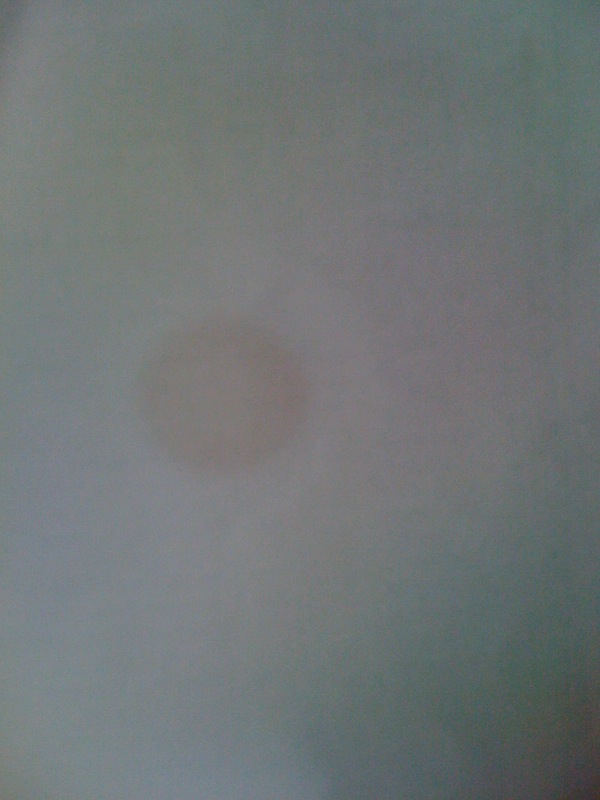

    My iphone camera now has a permanent brown smudge near centre of the image. Stays there when looking at photo and downloading. Tried resetting, no good. Anyone seen this and know how to shift it? Iphone now more than a year old. Cheers.

    The photograph I indicates and is typical of a piece of dust on the camera sensor. This is a common problem with digita SLR cameras with detachable lenses. As you say the back of your iPhone is cracked, it is apparent that dust has entered the case.
    I assume the phone is out of warranty (Apple would have replaced it if was still under warranty)
    This being the case, you have two alternatves. To either open up the phone and carefully remove the spec of dust or buy a replacement.
    It's also a good idea to look after the phone to avoid further damage to it.

    Yes, it's probably a speck of dust on the sensor. Has anybody tried any of the UK repair companies to change a camera? And if the camera only costs a few quid, and doesn't require soldering, why don't apple replace them?

    Smudge Fix
    1) Take some isopropyl alcohol and a Q-tip.
    2) dip the q-tip in the alcohol, and swirl it on the lens briskly with some effort.
    3) Keep doing it until the bluish material on the lens is gone, it will take a few tries.
    I got rid of my iphone 'fuzzypix' this way. There is some sort of lens coating on there that causes problems after awhile.
