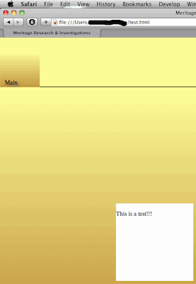

I copied and pasted the code into a new local page and it displayed the same in Firefox and Safari. I don't have the script file that you declare though, so perhaps it does something bad for Safari. That would be the only real difference. I have Safari 5.0.3. Also be sure to clear your cache in Safari.

Adding that had no effect. One other difference for me is that I don't have the images referenced in the CSS. You also use a comma and a space in the files names, which could be part of the problem.
Example:
Code:
../../Meritage%20Research%20&%20Investigation,%20Inc/img/drp_arw.gif
The %20 stands for a space. You should also avoid the & in file names as those are used in URLs for parameters. I'd be willing to be this is the source of your problem. Don't uses space, commas, or ampersands in file/folder names for the web.
Those images that are attributed to those file names display just fine. But the advise is well noted. I use linux, that shouldn't of slipped by me. Windows is making me lazy. Mainly what I see is that on the other browser i'm testing in, rockmelt, firefox, opera and IE show the 200 by 200 px box in front of the gradient in display and in safari it doesn't. I'll switch the file names around and change those values.

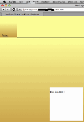

Attached is what I see for reference. I shrunk it a little just to reduce file size, but shows what you describe.
hmmmm... yeah I got nothing, I have it on win 7 so maybe its a problem with that. Mainly just downloaded it so if anyone using a mac saw the site they could see the content. Glad to hear it showed up. Thanks for all the help. 😀
