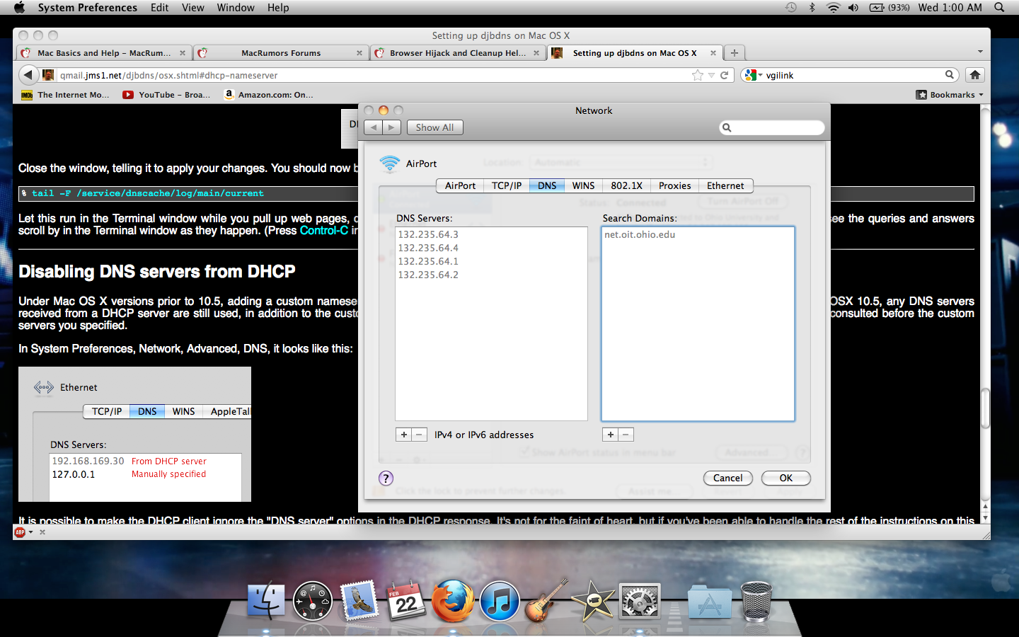

Thank you for that lightning fast response. Now, I took a look at your response, and had read about the greyed out DNS selections. I know absolutely nothing about this, and was a bit intimidated by the part of the guide on how to remove these saying that "Be aware that this is a GLOBAL change. If you do this, your machine will not use the DNS servers specified by any DHCP server"
It seems you're knowledgeable about this, so I'll attach an image of exactly what appears on my screen when I go to DNS under network settings. If you could please break this down for me and just confirm that this is the issue, I'd be super grateful.
Keep a copy of any file you modify and you should be fine. As that link indicates:
This may affect your machine's ability to easily work with corporate networks (especially those using Windows Active Directory) or other networks which use private DNS namespaces.
So do you connect your Mac to corporate networks or any networks other than your local network? If not, there's nothing to worry about. It looks like your DNS servers are coming from RR-RC-Ohio University-Columbus, which appears to be associated with Road Runner service. I don't know if those servers have been compromised or if they can be trusted. The ones in the link I posted can be trusted, so I'd proceed with removing the greyed out ones and adding either the OpenDNS or Google DNS servers.
Hello again,
I don't have the power to remove the servers for some reason, so I went through with the guide I had referenced to before, and have gotten a boosted performance, and no problems.
However, the DNS servers in my previous image are still there. I'm not sure technically what exactly I did by following the steps to remove the three integers from the IPConfiguration file, but does that just stop the servers from redirecting me even if they're still there?
Sorry if that wasn't too clear, and thanks again for your help.
