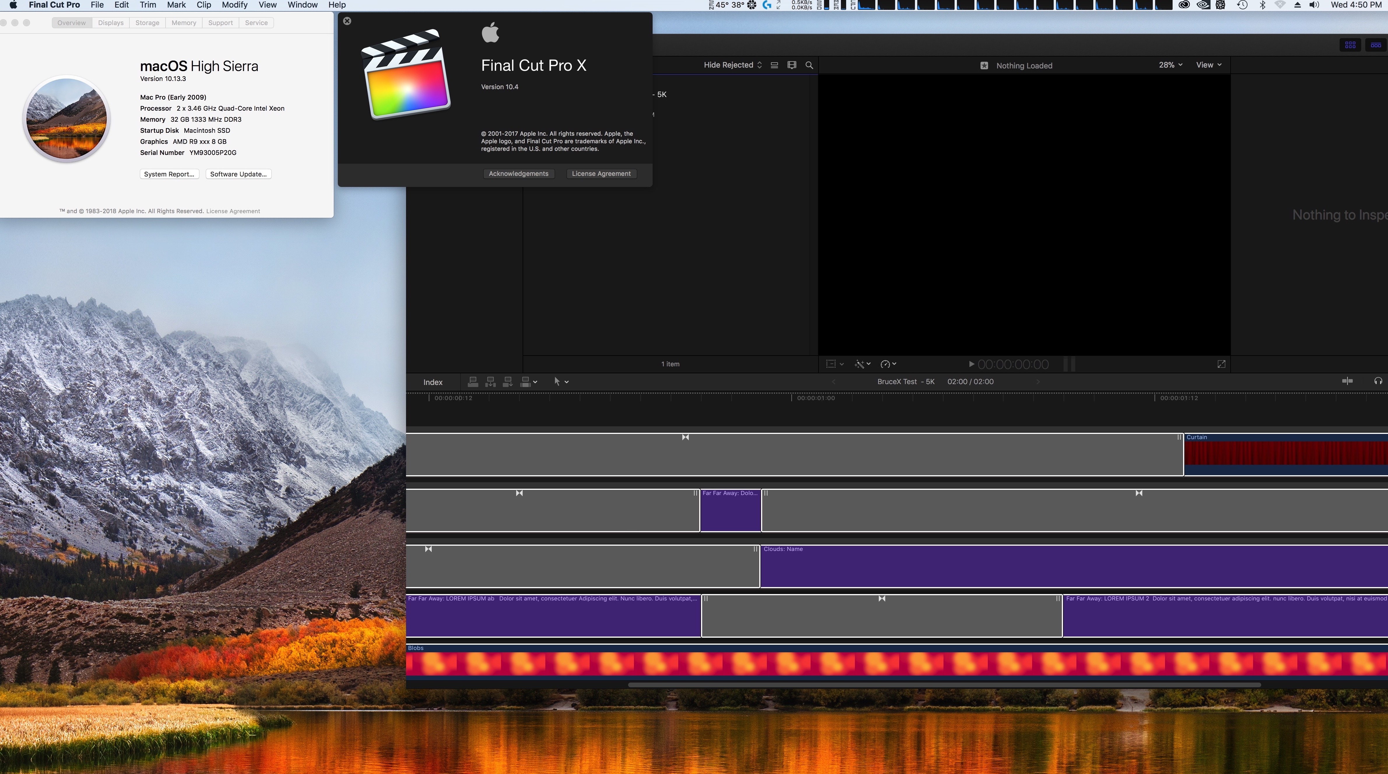

Tested again, this time with 10.13.3, and got 21.6 seconds. ProRes 422.
--EDIT-- Tested again with ProRes 444 XQ 22 Seconds.
Tested again, this time with 10.13.3, and got 21.6 seconds. ProRes 422.View attachment 749374
