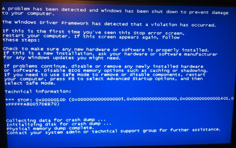

So I installed Windows 7 Home premium 64-bit on my new i7 15" MBP yesterday, and I've already had about seven or so BSODs.
One of the first things I did after I installed Windows 7 was install the driver for my firewire audio interface. After I installed the driver, I plugged in the interface to the MBP, and turned it on. Once it was on, I immediately got a BSOD similar to this:
I restarted the computer and tried to use it as normal. I installed various programs to get back up and running with a workable system, and I periodically got more BSODs. I looked at the Minidump files and Windows debug tools indicated the stop error was probably caused by wdf01000.sys.
The BSODs didn't seem to happen when the firewire audio interface was turned off.
Since the interface seemed like it was the culprit, I tried a different firewire audio interface.
This interface produced BSODs as well, but they were different. This time, the BSODs were more specific and said SYSTEM_SERVICE_EXCEPTION and had a code of 3B instead of 10D. It also indicated the "wdf01000.sys" process again. This Minidump I did not have "permission" to look at with the Windows debugging tools.
This system is completely unworkable, and I need to get the Windows portion of my new MBP working well. It's completely unstable as is.
Does anyone have some serious advice? Are there known firewire issues with Windows 7 64-bit? Or is this a hardware or driver issue with the MBP or Boot Camp? Are BSODs still possible if I use virtualization software instead of Boot Camp? I need to be able to use my audio software in Windows without BSODs.
Thanks
