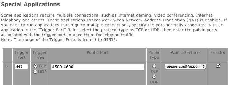

However, I've found that I could not use services such as screen sharing and file sharing through BTMM. So, I edited Bob's configuration under "NAT" -> "Special Application" section as:
Now I can share the screen of my mac at home from anywhere as long as BTMM is working at a remote site.🙂

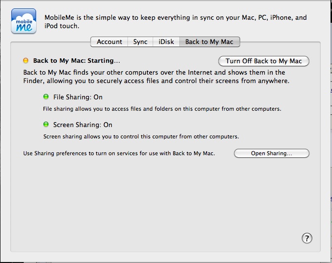

I have BTMM operating on my Macbook Air however I cannot access my other macs on a network I have at work (also running BTMM on the same MobileMe account)
I have attached a screen shot of what the System Preferences window shows when we are in the BTMM menu. It stays on this amber light the whole time. As you can see, Screen Sharing and File Sharing are green lights, yet I still does not work.
I have tried troubleshooting with both Apple and iiNet with no success... Any advice would be greatly welcomed!
