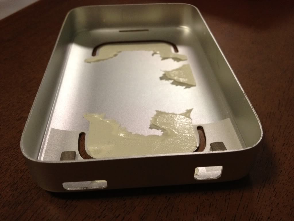

Just seeing this today. Thanks for the great writeup. What's your experience/expectation with re-opening the case several times with regard to the double-sided sticky? Is it ultimately external rubber bands for closure?
I've been considering getting the Seagate thunderbolt sled, specifically to swap drives out for different projects, though it sounds like the biggest concern with that is lack of retention of the drive...rubber bands again.
Rubber bands certainly aren't the end of the world, but it's good to know what to expect.
Once you restick the double sided tape, it isn't as secure as the first time. There is a user on here that resorted to rubber bands as he did away with the double sided tape for the very reason you want the Seagate...hot swap...so closure could be done with very thin velcro.

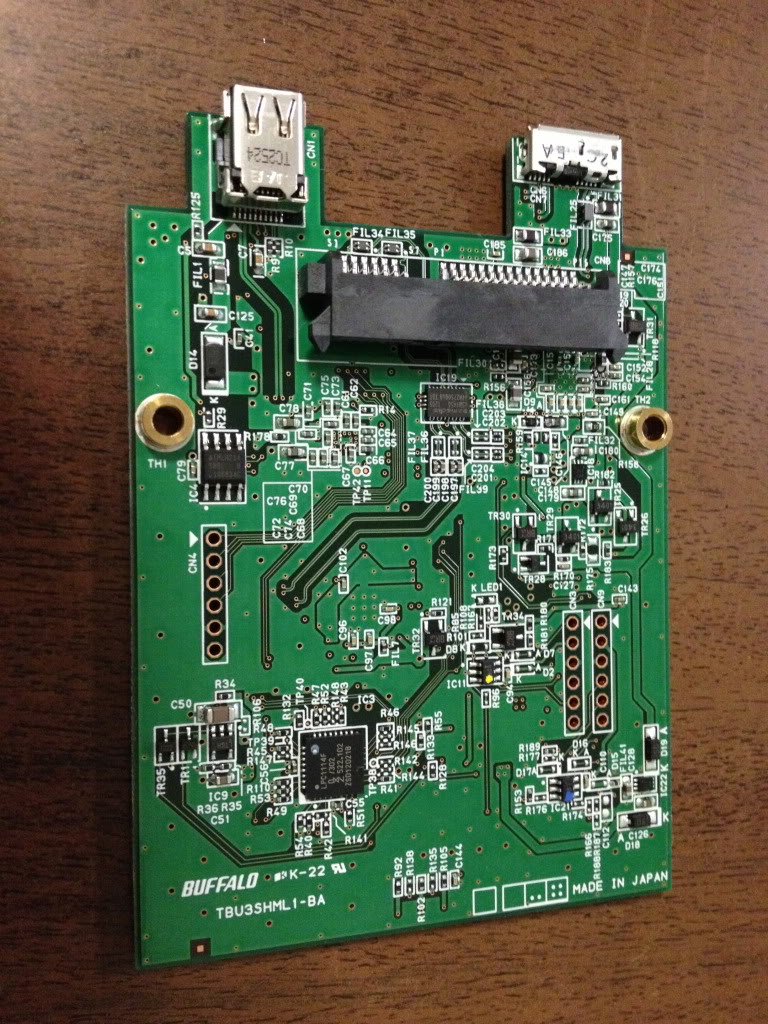

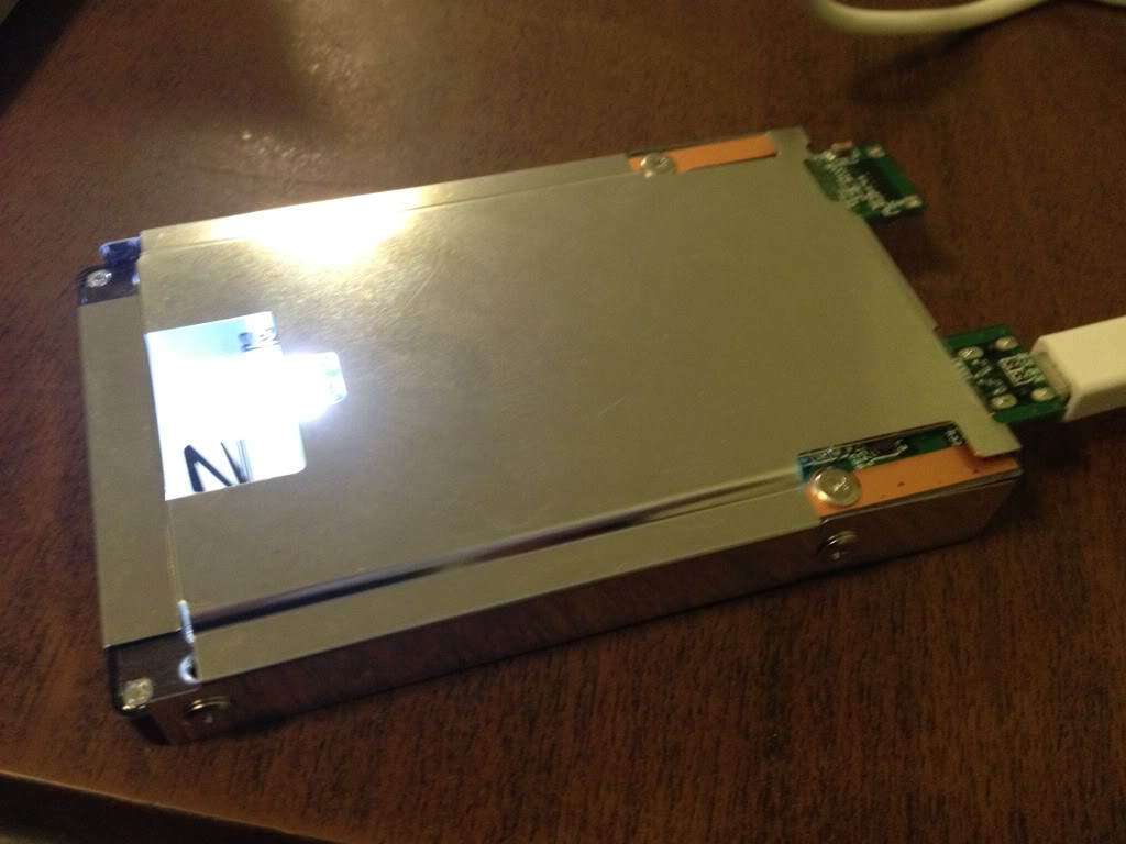

Based on the pictures, I decided to give it a try as well. Not as easy as it looks, Buffalo made it very firm with no intention for users to rip it apart. Some hinges may crack or break but thats a risk you decide to take when taking it apart.
The Buffalo Thunder bolt HD-PATU3 1TB

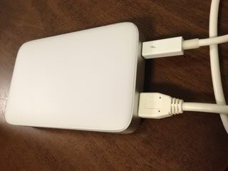

Inside the box - USB 3.0 & Thunderbolt Cable

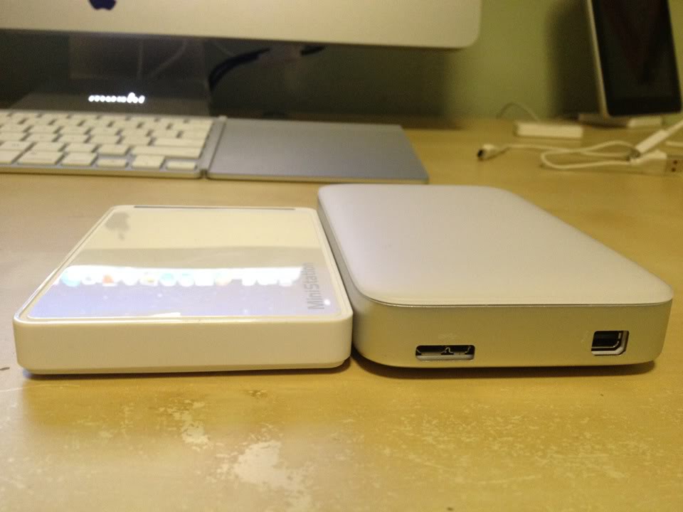

It's rather thick if you compare it to a standard Buffalo drive.

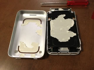

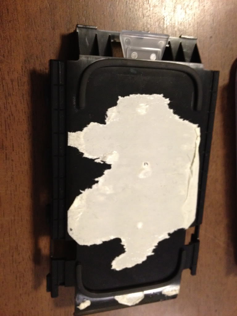

What I did was use some plastic cards at gently inserted them in gaps between the edges of the drive and once I had three cards firmly inserted. I then used a flat head screw driver and inserted that beneath a gap under the USB 3.0 port. Then levered it out till you hear the double sided tape give way and rip apart.
Once you have pried it apart, it should look like this
This is the difficult part, carefully but firmly remove each side of the joints holding the cover and the white casing

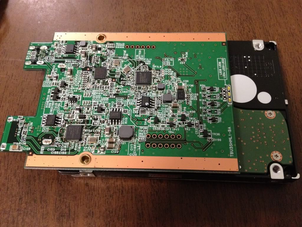

Remove the four screws on each side of the metal casing
Unscrew the two screws from the bottom

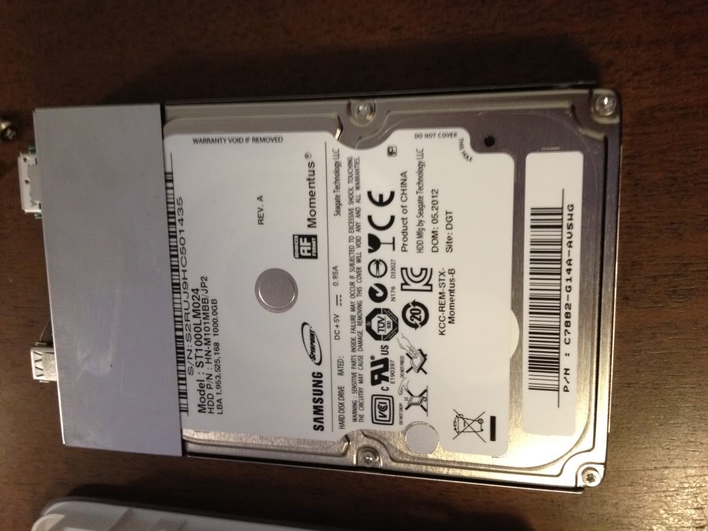

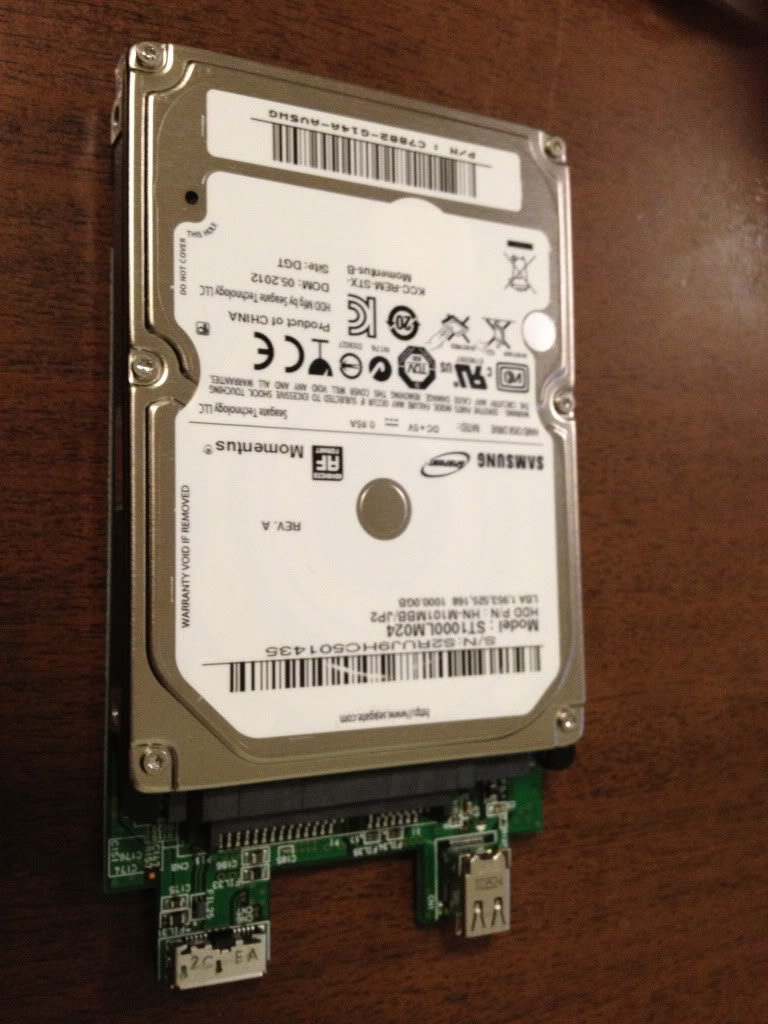

Gently remove the hard drive from the connector
The connector

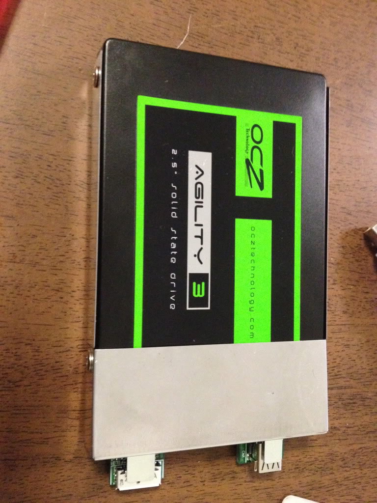

Insert SSD into the connector

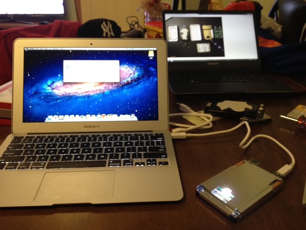

Plug the device into the thunderbolt port
Testing if it functions
Completed
Estimated time taken was around 40 minutes, cost was around $238.59 for the Buffalo Drive and the SSD was around $199. Totals to $437.58 for this thunderbolt solution.
The Build quality of the Buffalo was excellent, The top is made from hard plastic and the bottom is Aluminum Unibody to match the MAC design.

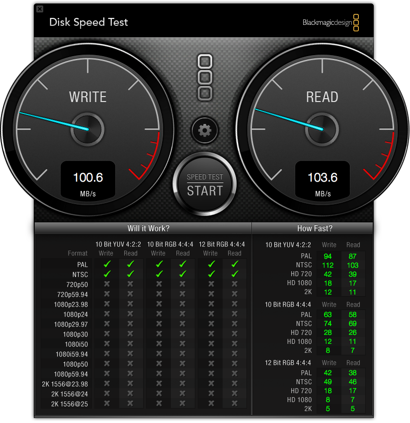

I have a problem with this drive , got the 1TB version from Newegg. The transfer rate hits a cool 100-110MB/s over Thunderbolt but i'm getting only 35-40MB/s over USB 3.0
Problem is only have my rMBP with me right now and don't have another machine to test the drive on to figure out if its a rMBP/ Mac /Mountain Lion issue. It's not a HDD issue on the Buffalo drive as it hits 110MB/s on thunderbolt.
I suspected my rMBP and tested a lexar usb 3.0 usb drive and it crossed 80MB/s.
Should I contact buffalo tech support ?
Perhaps your Buffalo drive does not support UAS on the USB 3.0 side. Or with your particular drive it is only connecting at USB 2.0 speeds. See: http://en.wikipedia.org/wiki/USB_Attached_SCSI
Check Apple System Profiler to see if the drive reports being connected at 5Gbps or 480Mbps in the USB section.
Sometimes my Buffalo only connects at the lower USB 2.0 speed. This might be due to cable issues.
You hit the nail on the head, seems like a cable fault which occurs at unpredictable intervals. 5 mins back it was on USB 2.0 480Mbps and now USB 3.0 5Gbps
I'm not sure if it has got something to do with the USB 3.0 implementation on the rMBP as the drive seems to connect in USB 3.0 every time on my 2011 Windows Desktop with a Gigabyte motherboard.
