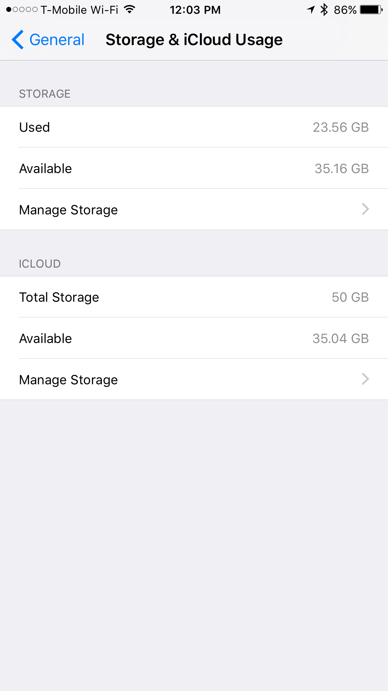

Jailbreak seems to have gone ok, except that almost half of my total available storage space is gone.
This is a 64GB iPhone 6s Plus iOS 10.2. I have very few tweaks installed. Basically just sped up animations. Also iCleaner. Installed Kodi, it crashes in boot, so removed it. Beyond that I've done nothing.

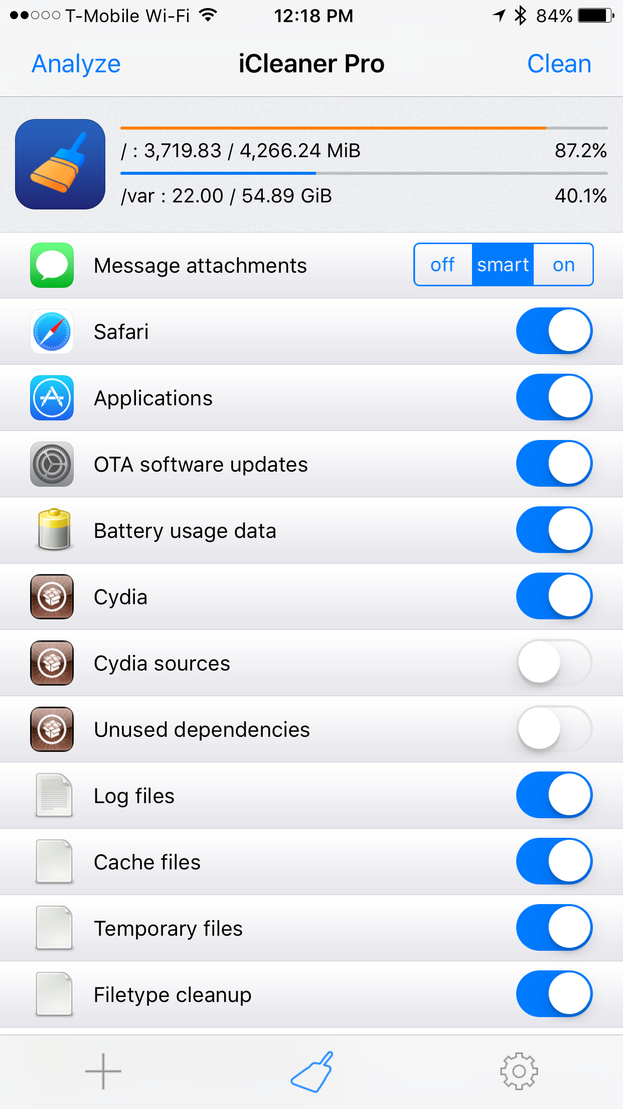

[doublepost=1485623908][/doublepost]IMG_4448.PNG Interestingly )m(or maybe not idk lol) iCleaner seems to be aware of the total max capacity.
