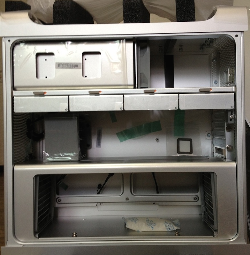

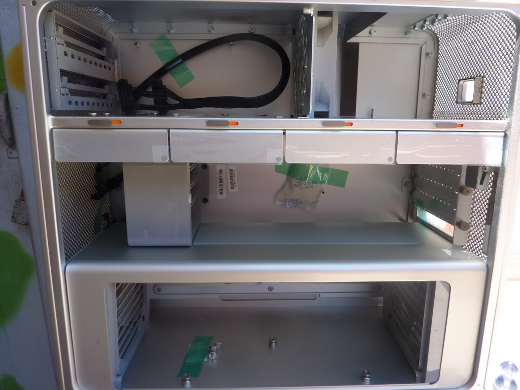

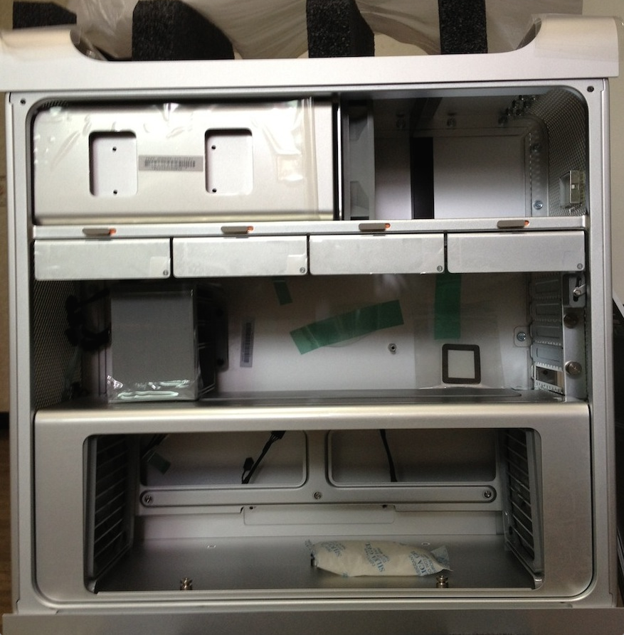

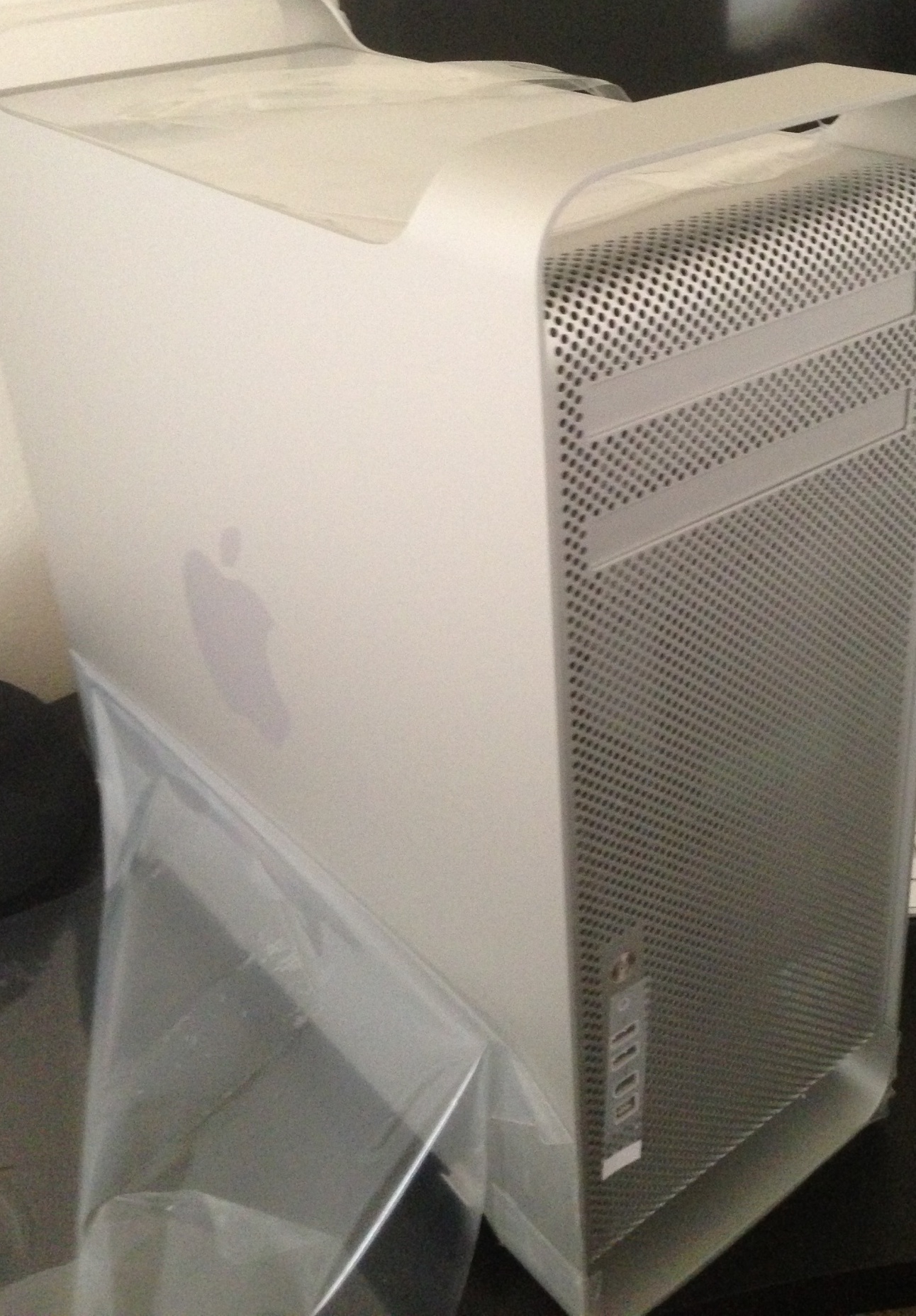

Hey guys, Im currently trying to do this exact thing, build myself a mac pro 2009 octo from scratch. I found a place selling the enclosure with fans, cage, caddies, and everything it seems for $99 usd. I am also looking into buying 2 matching engineering samples xeon x5560's. i have also found a guy selling a psu from the original mac pro for $45 usd. I'm a little new to building mac pros, although I have built dozens of pc towers and a few macbooks and macbook pros. but right off the bat i have a few questions maybe you guys can help me with.

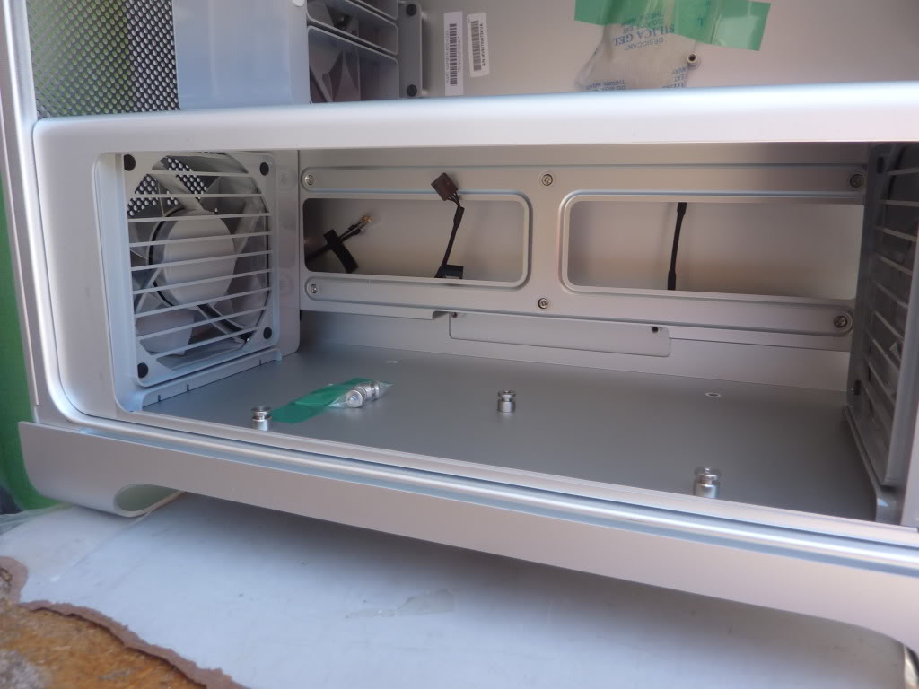

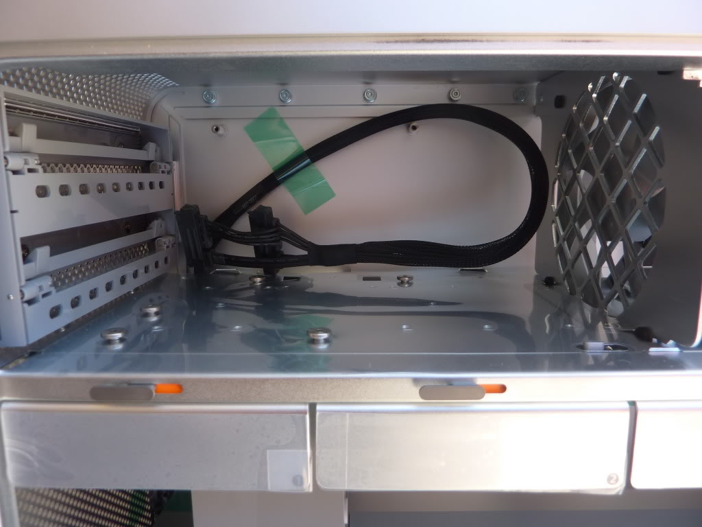

1.First off is the case Im looking at pre-wired or not? I honestly cant tell from the pictures sent to me. (i will post pics at the end.)
2.Case doesnt come with power supply. will a psu from an original mac pro work? if so is there anything I have to buy for it to make it compatible or is there no way (also found a psu which is a pull off from MB535LL/A, which i believe is the 2009 mac pro for $120, which isnt bad but isnt as nice as $45🙂)
Those black things you see are wires. Now guess. 😀
You need a 2009/2010 PSU. Others are incompatible in any possible way.

Thanks for the reply. I could see that there are SOME wires in the chassis, but i was unsure because ive messed around with a 2008 mac pro, and they have SIGNIFICANTLY more wiring than this case did. I also figured that maybe those wires just for the superdrive. ok, so it looks like ill have to bite the bullet and pay $120 for the psu, so that makes $240 (shipping included) for the enclosure and power supply. not bad i guess
