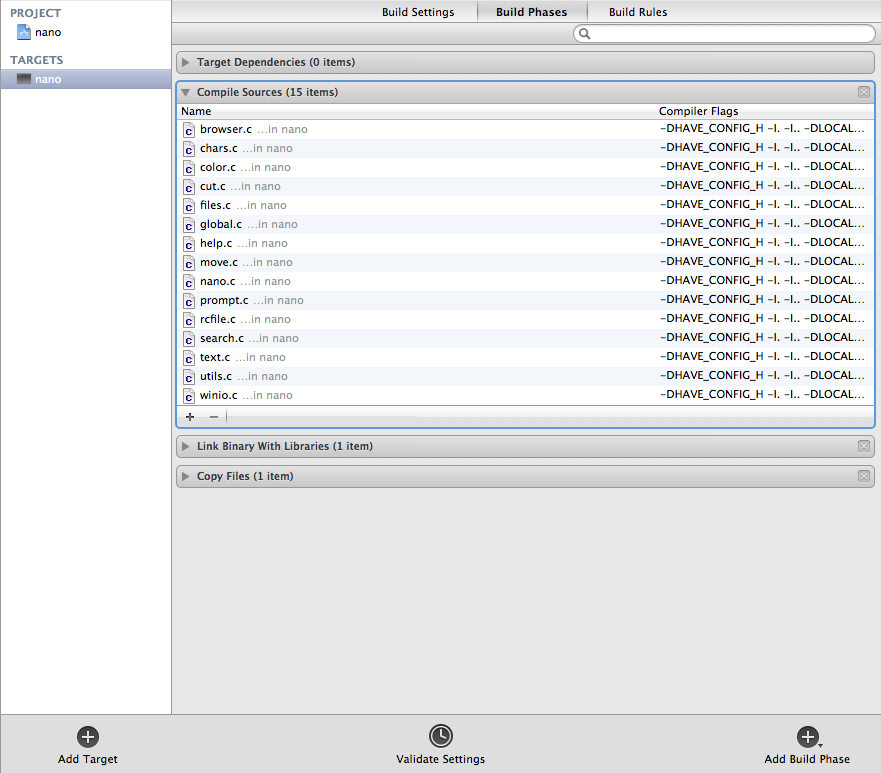

Instead of looking at the makefile I just decided to run make and look at the output in the terminal. I get this command run for every source file:
Code:
gcc -DHAVE_CONFIG_H -I. -I.. -DLOCALEDIR=\"/usr/local/share/locale\" -DSYSCONFDIR=\"/usr/local/etc\"    -g -MT winio.o -MD -MP -MF winio.Tpo -c -o winio.o winio.c
Of course the filename is changed for every file, but the flags are all exactly the same for each source file. I've put these in the "flags" portion for each source file. The final command is:
Code:
gcc  -g -O2   -o nano browser.o chars.o color.o cut.o files.o global.o help.o move.o nano.o prompt.o rcfile.o search.o text.o utils.o winio.o  -lncurses

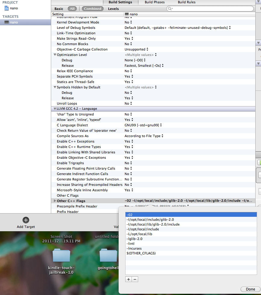

I've added these to my XCode project (screenshots attached) along with something I think I need because of glib (it complains about files missing without these lines). Basically I had to run pkg-config to output the correct compiler flags for building with glib like this:
Code:
pkg-config --libs --cflags glib-2.0
I've also added /opt/local/lib/glib-2.0/include and /opt/local/include to my header search paths.

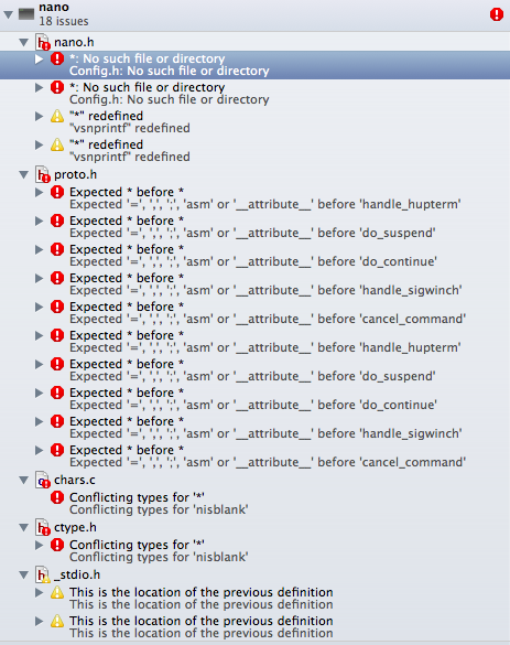

So, since when I run make it uses GCC I switched the compiler to the LLVM GCC compiler in XCode (it should be the same one that make is calling). Unfortunately I get 13 errors and 6 warnings in the build. I think it's because XCode is using the LLVM GCC compiler and make is calling just GCC, but I'm not sure if I can fix it. At this point I'm a little stuck. If anyone has any input I'd be grateful 🙂

You have -DHAVE_CONFIG_H. If you do that, you'll need run ./configure from the command-line to get Config.h.
