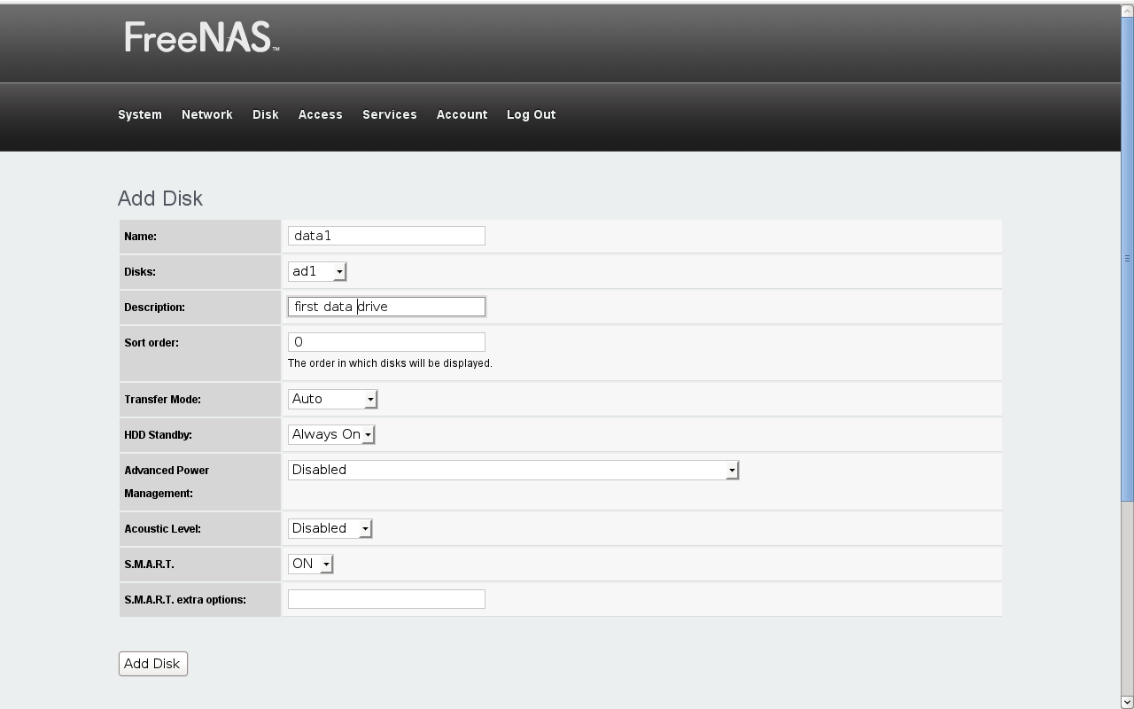

I've been a long time user of FreeNAS and find it to be a really great product.
It is based on zfs and you can easily create AFP, SMB or NFS shares. It also supports timemachine natively, as well as being a iTunes and Windows Media server. So it can stream your media from a single source to both Apple and Windows devices. It can be your Timemachine destination as well.
It's pretty easy to setup and their website has great walk throughs. It's managed via a web gui quite easily.
You can also take all your drives and dump them into a zfs pool. If you have an SSD you can use that in the same pool as zfs cache or zil cache. zfs also gives you snapshots and you can define the snapshot schedule. Fantastic for point in time backups.

For Freenas it doesn't matter. You make a bootable USB stick and the Freenas O/S exists on the USB. That way you get 100% usage of your disks for the NAS.
I have no idea what your techie skill level is. So it is hard to say how hard or easy Freenas is. If you've got a PC or Mac that you're willing to totally erase and play around with, defiantly give Freenas a whirl. I think the hardest step for most is probably creating a bootable USB stick. The Freenas.org website has a very good walkthrough. However, basically the procedure is downloading their .ISO file and loading it up in Disk Utility and restoring the image to a USB stick. Then you take the USB stick to the machine you're turning into a Freenas box and boot from it. If it is a MAC press "option" if a PC then you may have to go into the BIOS and set it up to be able to boot from USB.
Once booted from the USB you answer a few simple questions about networking to get the Freenas box on your network and from there you do everything else via a web browser. I find the whole thing remarkably simple. However, I'm a UNIX admin of 20+ years so a BSD based Freenas box is rather straight forward to me....
Speaking to ZFS. Unlike MacZFS or some of the other ZFS products that have been trying to make a ZFS file system for OSX (ie Zevo) with varying degrees of success and trouble. FreeNas is built on a very new BSD kernel and the latest ZFS. It is very feature rich. The best part IMO is being able to create hybrid RAIDZ volume pools that also use a SSD drive as L2ARC cache and zil. This makes for some blazing speeds. In a lot of ways you gain the speed of SSD by using a smallish 80-120 SSD drive and then a bunch of cheep slow 5400 RPM SATA drives. Your frequently used data ends up on the SSD and when the volume is less busy it stages the data to the slower disks in the background. Also a RAIDZ pool is also fault tolerant. Assuming you have more then 1 physical disk drive. All data is protected from a disk failure. It is kinda like a RAID 5 but isn't. It is much more advanced.
Freenas with ZFS also supports dedup and disk compression and of course snapshots. But I'm going to end this novel of a post here :)
