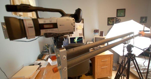

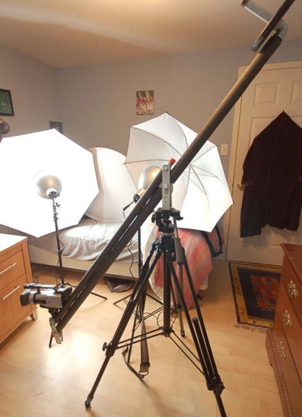

I, also, homemade a jib arm, i didn't have access to any crazy machines or materials so I used materials anyone could get from a store like Home Depot.
Here is my jib:

Shmexi. 😀 Really need to get round to making one of these.
That looks very good. How well does your tripod hold the arm and allow you to rotate it? Also, how long is your arm?

The tripod holds the arm with no issues at all, I just have to make sure to mount it so that the tripod tilt mechanism is not running with the arm, so that the tripod does not "tilt" the jib arm like it would a camera.
I can rotate the jib just like I would a camera. I created the jib, so that the bottom of the jib is mounted by the same way a camera is into the tripod head. Once I pop in the arm, I have the same controls on the tripod head.
As far as the length of the arm goes...I don't entirely remember what the measurements were... 60" comes to mind, but Im not sure.
