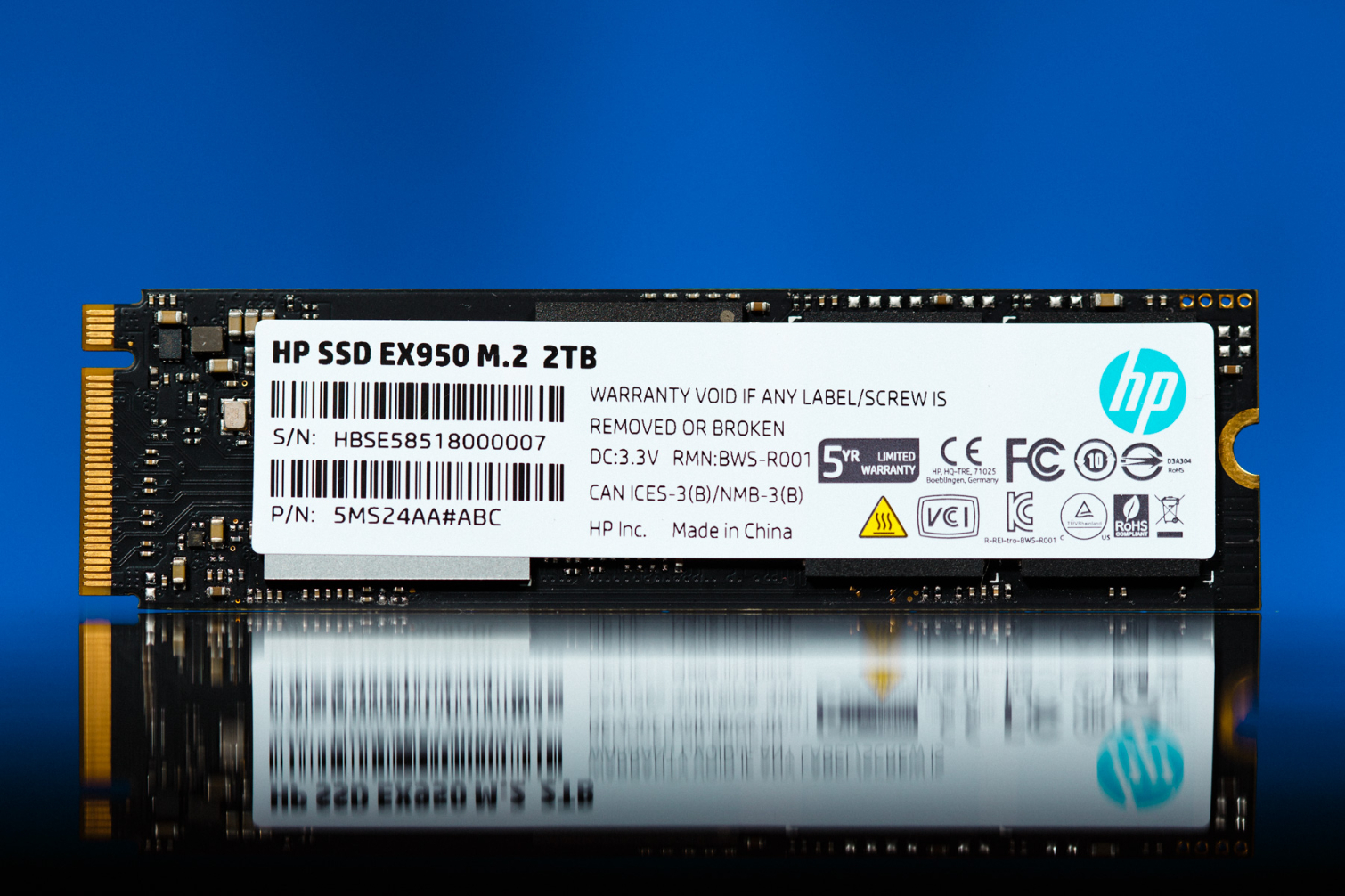

The 970 Evo Plus are also unnecessarily expense. The HP EX950 goes toe to toe with the 970 Evo Plus. Usually for a lot less money. It varies on the benchmark as to which is faster. The EX950 has better random read speed for one. Which is the most important for gaming. It may make a difference of 100 to 200 milliseconds for a game to load. :eek:
