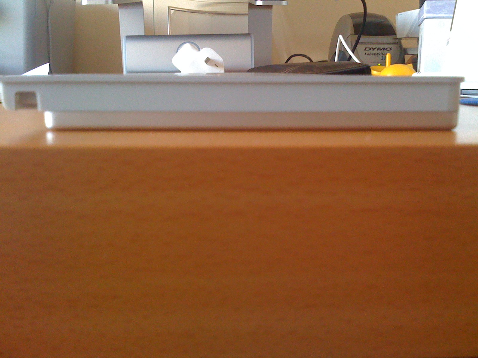

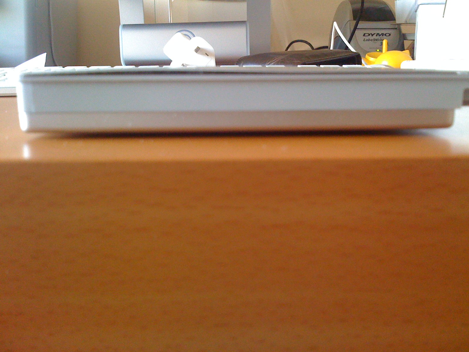

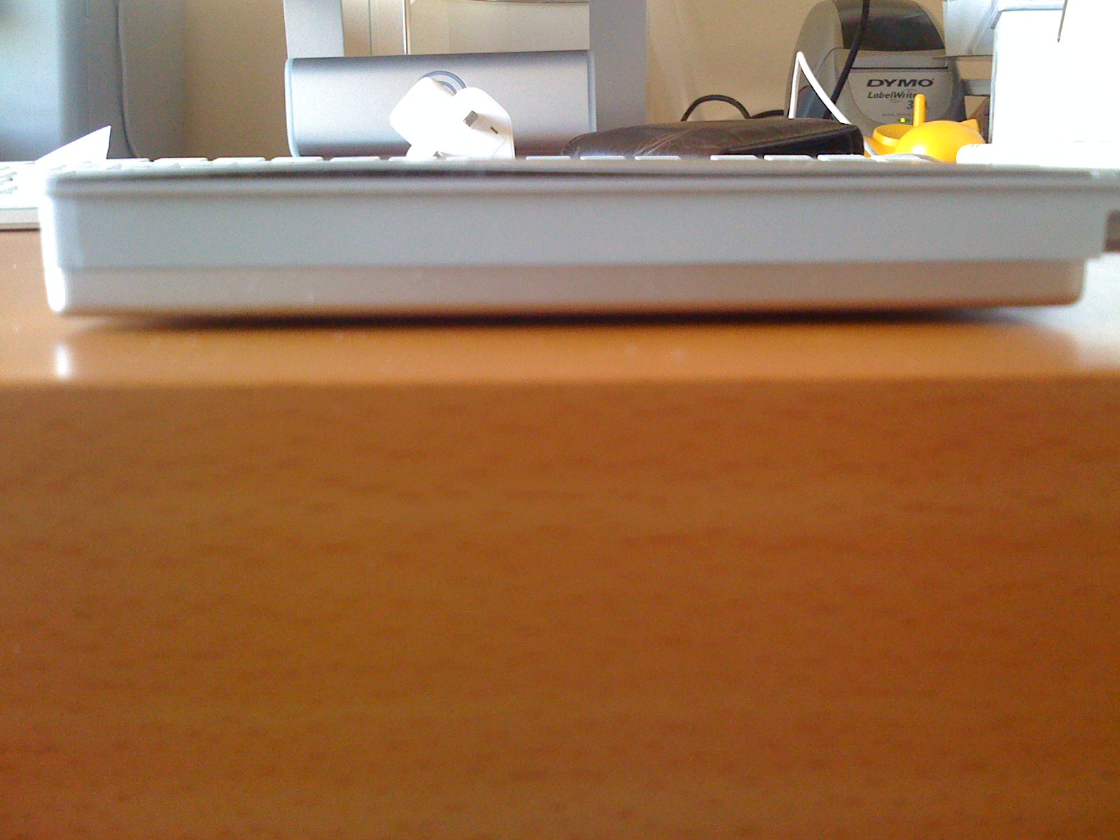

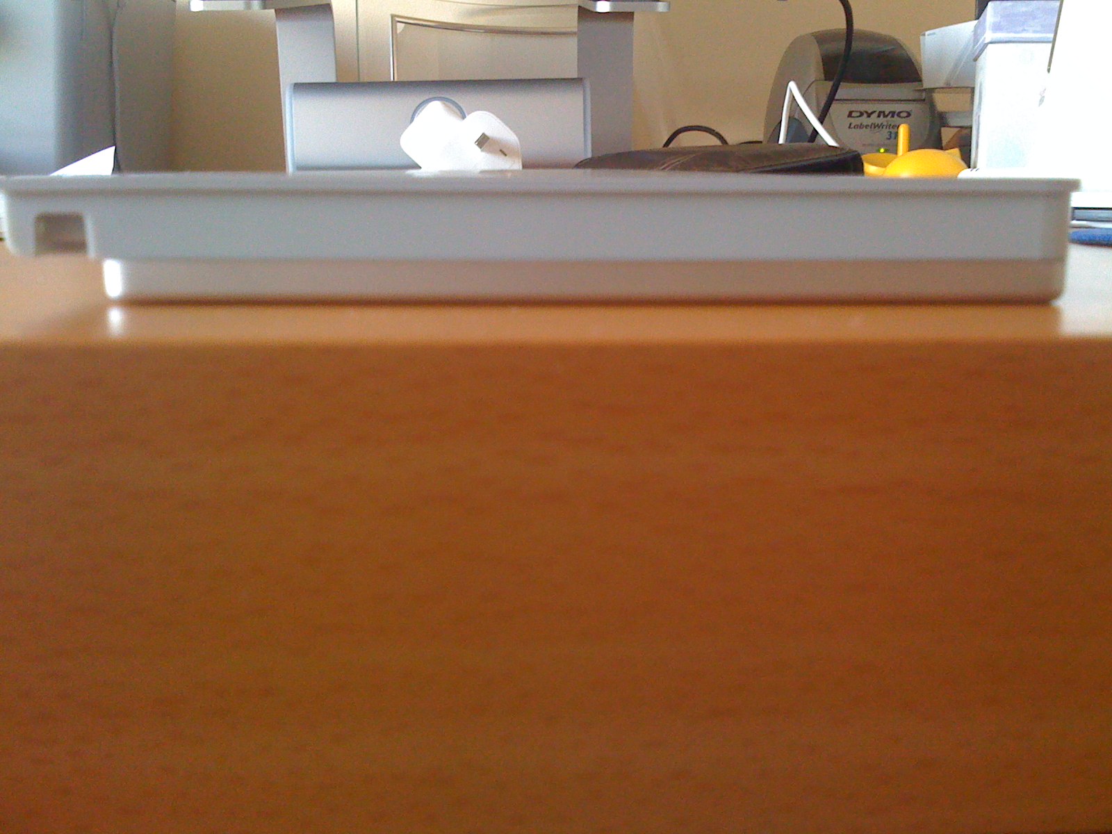

Here are some pics, one is the side with the bulge, one is the side without.
I have only just noticed it, dont know how long it was there? I have taken the battery out and am just running it off the mains.

yes post some pics with maybe a straight edge ruler next to it?
if its bulging I would rmove it straight away and maybe place it in a tin!
Wouldnt want a bulging lithium battery in my house 😱
Yeah there have been numerous reports of those Li-ion batteries turning into ugly balls of flame without any warning. Many major laptop manufacturers have had recalls on defective batteries due to this. I'd be a little careful when you handle that battery and definitely never use it again.
