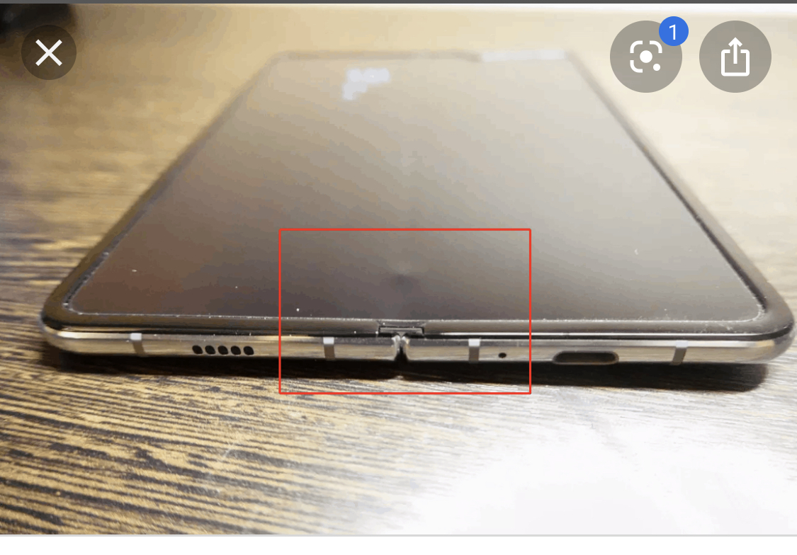

It’s possible it was there the whole time. Need the right angle and direct sunlight to see it and I may have not seen it in those conditions before. I can see the contours of it. It doesn’t cause any distortion at all on the pixels but it most definitely looks like a physical bump. Could definitely reproduce it for an Apple genius since now I know exactly where to look so even if it remains the same, I should still get a replacement. The bump itself doesn’t bother me. It’s the possibility that it’s causing my battery life issues.
This image of a Galaxy Fold would best describe what I’m seeing but it can’t be felt...
Oh, OK, that’s a fair bump.
I guess monitor it and return it when the Apple stores open again, or ring Apple if it gets much worse before then in case it’s a dangerous battery issue.

It's normal, and unlikely you'll find a version without it. I believe it may exclusive to the stainless/sapphire models, though. I went through 4 models (all with various bumps/waves under the display) before I gave up. If you do some searching, you'll see similar threads!

Great to know. Saves me a trip to Apple. I feel much better now, thanks!

It drove me crazy... until it didn't. I wish it wasn't something common, but it's also pretty easy to move past (and you'll stop noticing/caring, I think). I went through the Apple Store with a sales rep and we didn't find a single SS model that didn't have it on the show floor - makes me think that people who claim they don't have it probably don't notice it (and good for them! Wish I wasn't so obsessive).

Yep, I forgot about it instantly after you said it was normal lol. Mine looks similar to that last photo only not as sharp. Mine is more rounded off at the apex. Thank you for taking the time to reply. It’s much appreciated.
