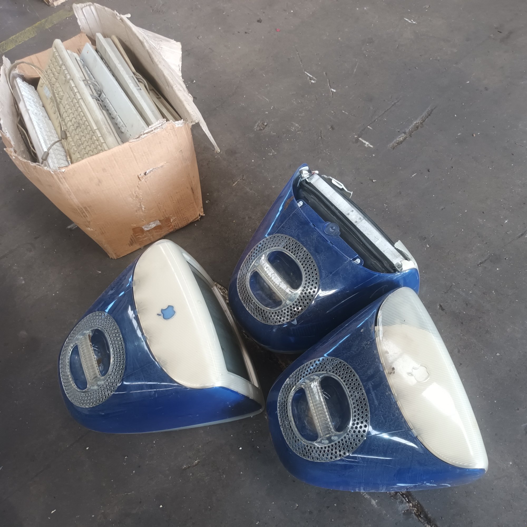

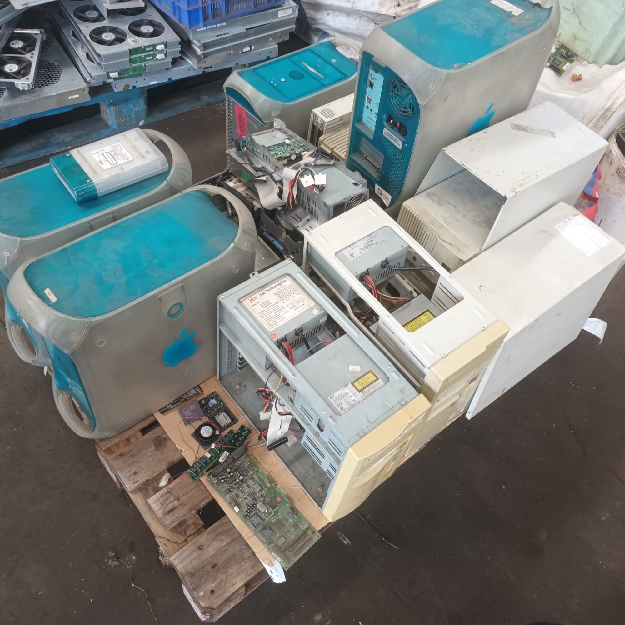

i recently saved 5 mac g3's and 3 imacs from being recycled...unfortunately the recycling company took the hard drives out of them to destroy because of "data privacy"...

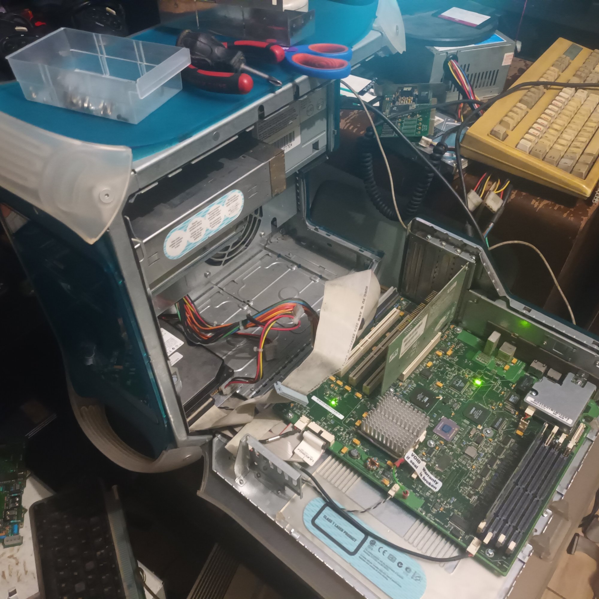

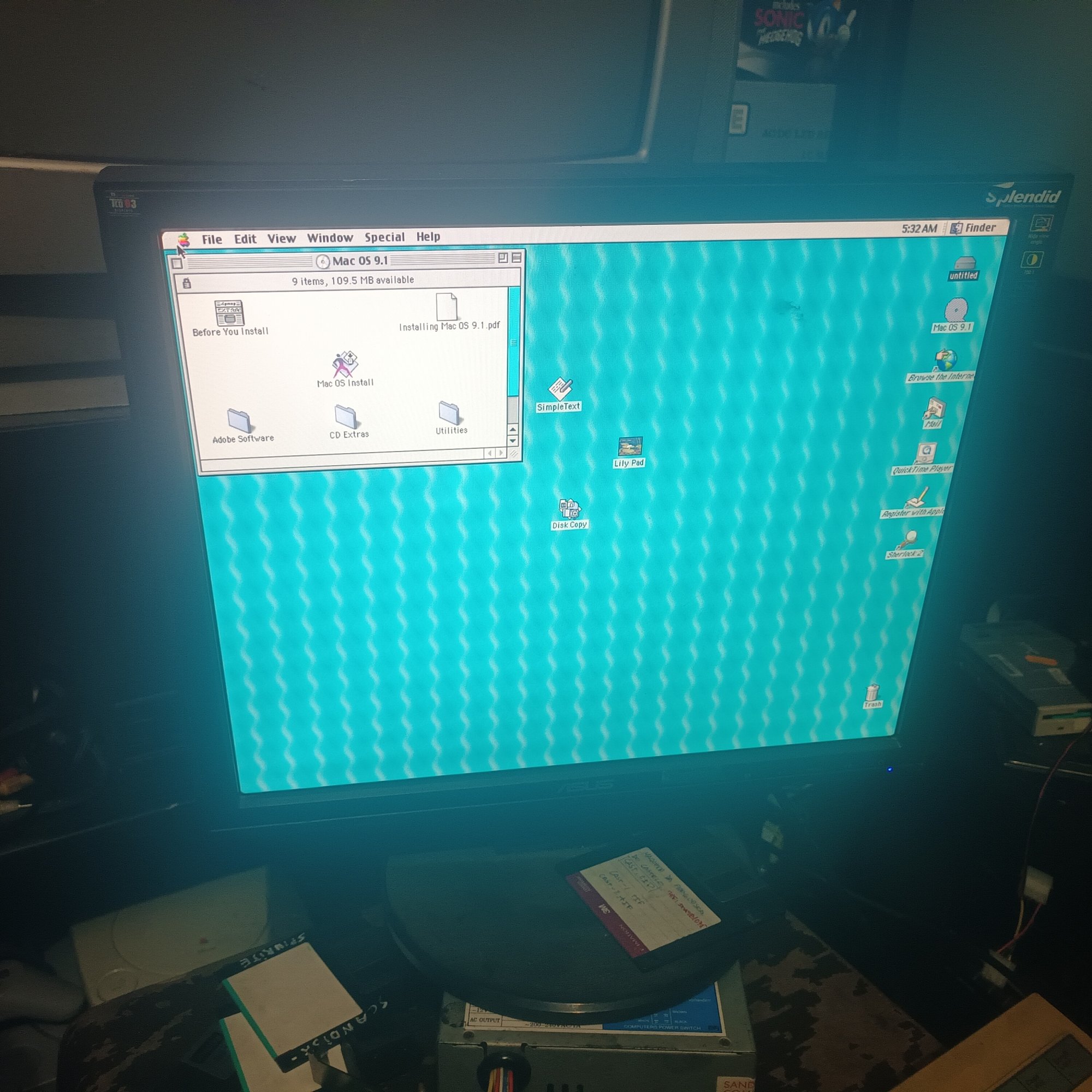

Thanks for all the help. I was surprised with how easy it was...i never had formatted a mac before, only pcs... the g3's are all done, i cleaned them and installed ide drives , because the scsi ones i had have way more pins (maybe more modern)... now i have to make 2 good imacs out of those broken 3 and format them too and i also bought a quadra 700 also without hdd..i think that one is going to be s challenge to install an os...what do you guys think?
