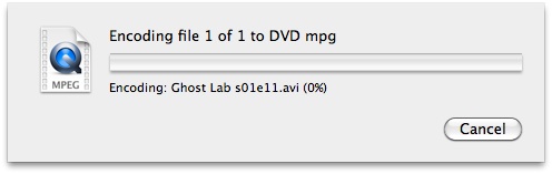

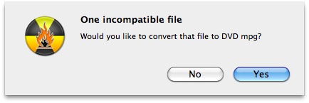

Hi folks, I searched the forum and can't find anything about this issue.
I'm trying to burn a xvid/divx file to dvd using Burn. Burn offers to convert the file so I let it and below is what I get.
The console readout is below as well. I used Burn under Leopard, but it appears to be hosed under SL.
I installed ffmpeg via macports.

Did you ever find a solution to this? I too just ran into the same error (same output in Burn's Console) after attempting to burn a DVD-video disc. I too went through the conversion process, so perhaps there's a problem there?
I didn't install ffmpeg (at least, not that I'm aware of), I think everything that's required is included with Burn...
