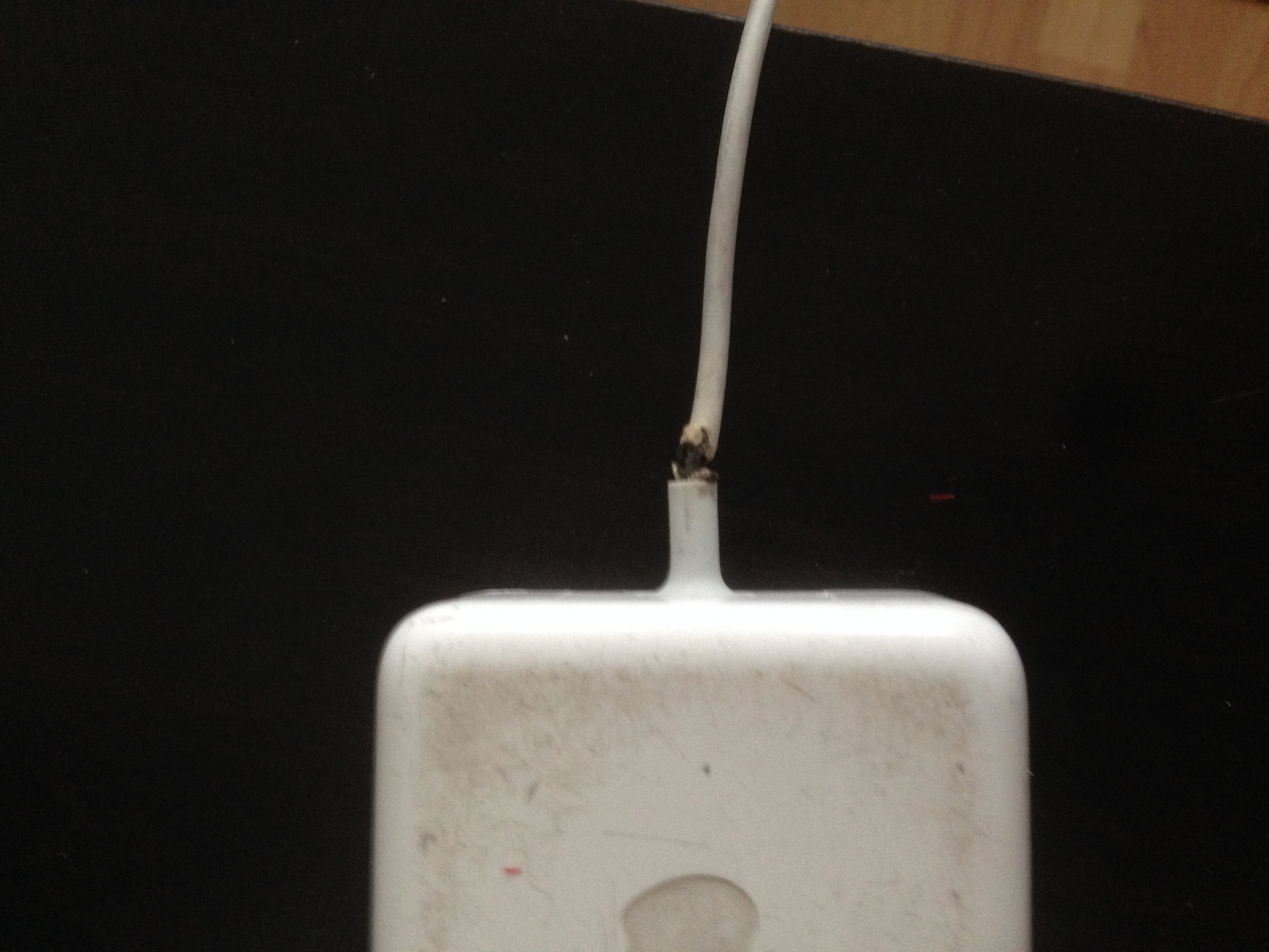

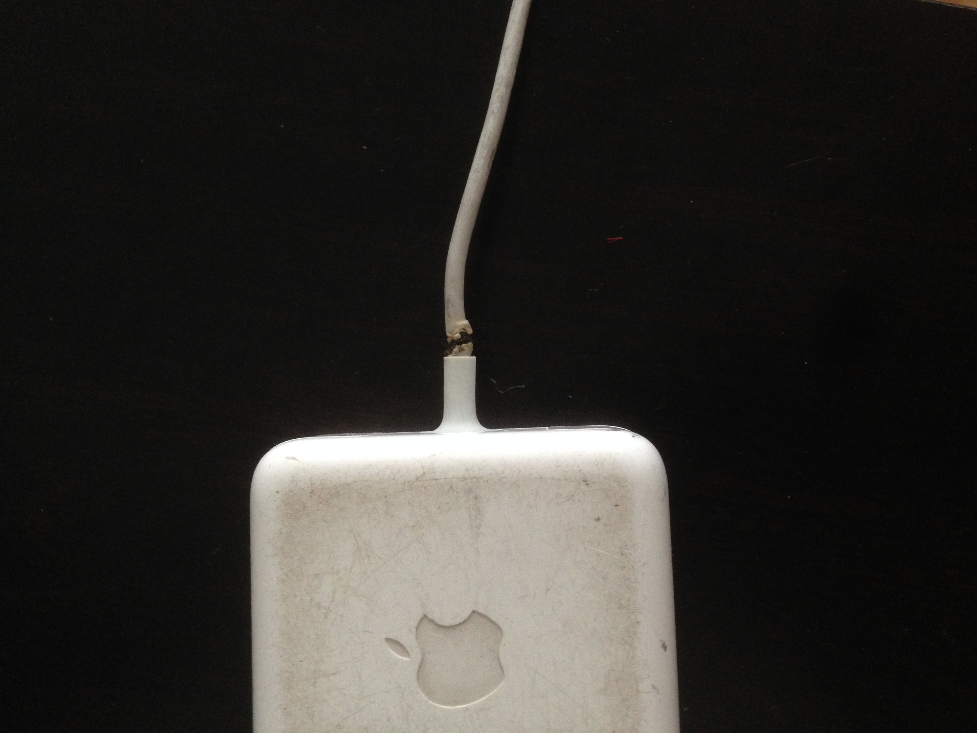

Last week, my wife noticed her Macbook Air wasn't charging. We found a small fray in the cable near the brick, and I immediately covered it with electrical tape. A few minutes later, she noticed it was also frayed near the Magsafe connector, so I covered that with tape as well.
As the days went on, it was harder and harder for her to charge her Macbook. I found that if I twisted or bent the area near the brick, I could make it work. A day later I was doing just that when I was burned. That spot was really hot and had melted through the electrical tape. I've attached pictures. Last night it shocked my wife when she was trying to get it to work.
I've read this is a fairly common issue with these chargers. I plan to go to my local Apple Store today and complain, but as her computer is two years old, I don't think they will capitulate and give me a new one.
Who can I complain to about this? Wasn't Apple sued for a similar issue with the old Magsafes? I'm really frustrated and don't want to pay $80 more for an inferior product.

Of course it should melt. The wires were frayed and you were twisting them together. Anyone with the most basic understanding of electronics knows this will short out the charger and probably cause melting, smoking, a fire, etc. You're very lucky nothing caught on fire and that you didn't destroy your laptop. I mean, what were you thinking??
Once you see exposed/frayed wires on something that you plug into the wall, you should stop using it immediately.
Apple uses some kind of soft rubbery compound on their cables to make them flexible and convenient to use but this also seems to make them fragile. It's a trade off. You do have to be more careful with them. Now that you know this, you can be more careful with the next one you get.

Does it? The pictures you posted show a charger that looks like s***. It's super dirty and scratched to h***. They don't look like this from sitting undisturbed in one place.
Just to amplify a point, wrapping electrical tape or doing equivalent "repairs" on the outer insulation does nothing to prevent a potentially catastrophic short circuit if the insulation on the individual conductors that are in the outer sheathing become exposed. 🙁

The problem is usually that the twisting at the strain relief location causes individual wire strands to break at that point in the wire, which causes a high resistance point in the wire. This high resistance point causes localized heating of the wire, leading to the charred appearance of the white outer coating, causing it to break down and than flake off. The individual wire insulation inside has a much higher melting point, and is not as prone to damage as the soft outer coating.
The insulation of the inner wires usually seems to remain intact, although in your case your trying to twist the connection to cause the separated wire strands to touch probably did in what was left of the insulation.
Since the charger is only putting out 15VDC, the "electric shock" isn't really a personal safety concern (but don't lick it... you would be sorry).
Apple is notorious for their poor strain relief on their power supplies. This has been a problem for 6 years, yet they keep pumping out power supplies with the "elegant understated strain relief solution" which is non-functional at best. Form does not beat function. I have replaced 4 power supplies on two MBA in the last 5 years because of this. The last one I bought I wrapped self fusing tape around that point on the brand new power supply to try to extend the life of the cable a bit. My problem has always been the magsafe end rather than the power supply end (which is much harder to repair yourself).
