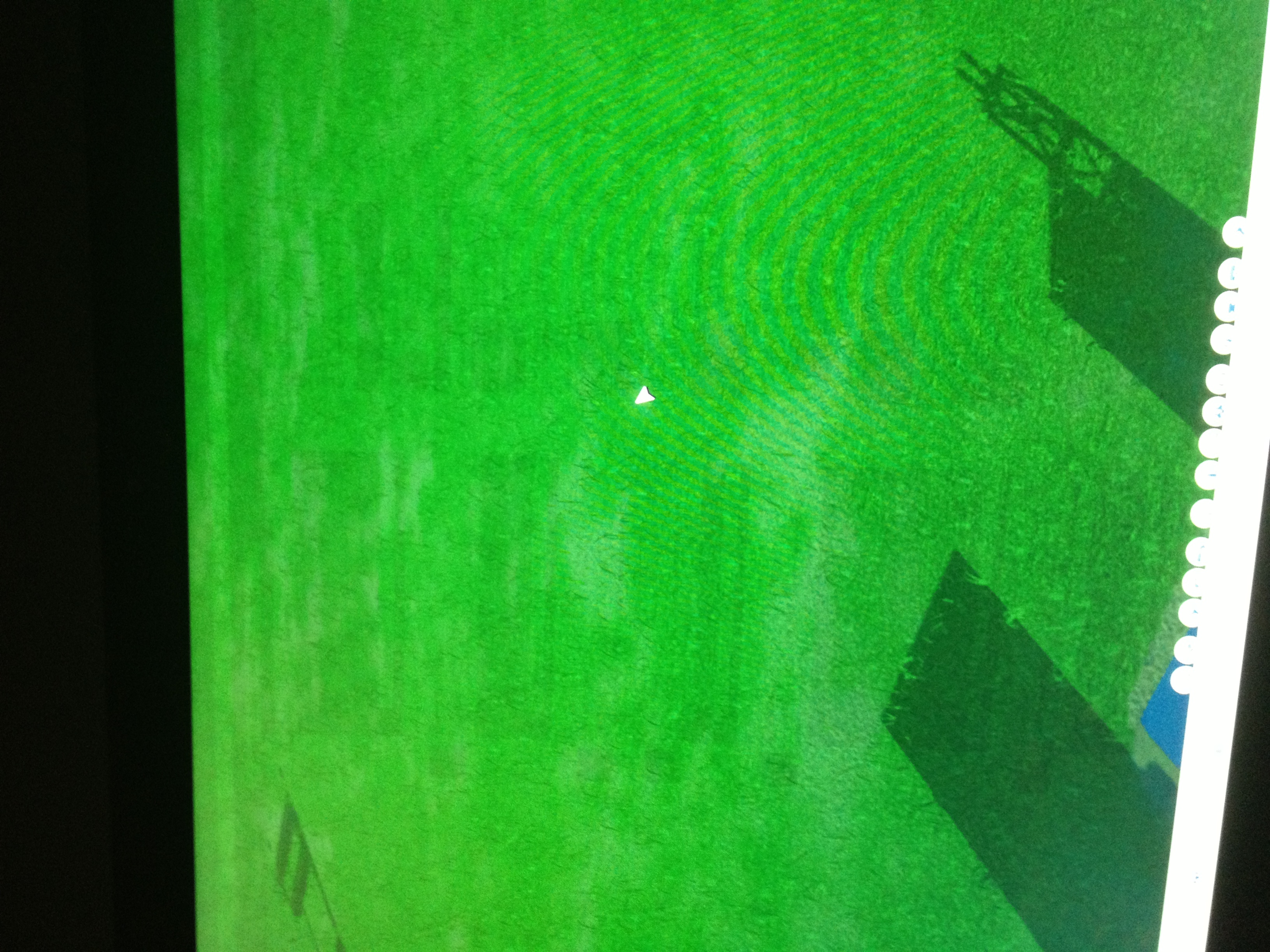

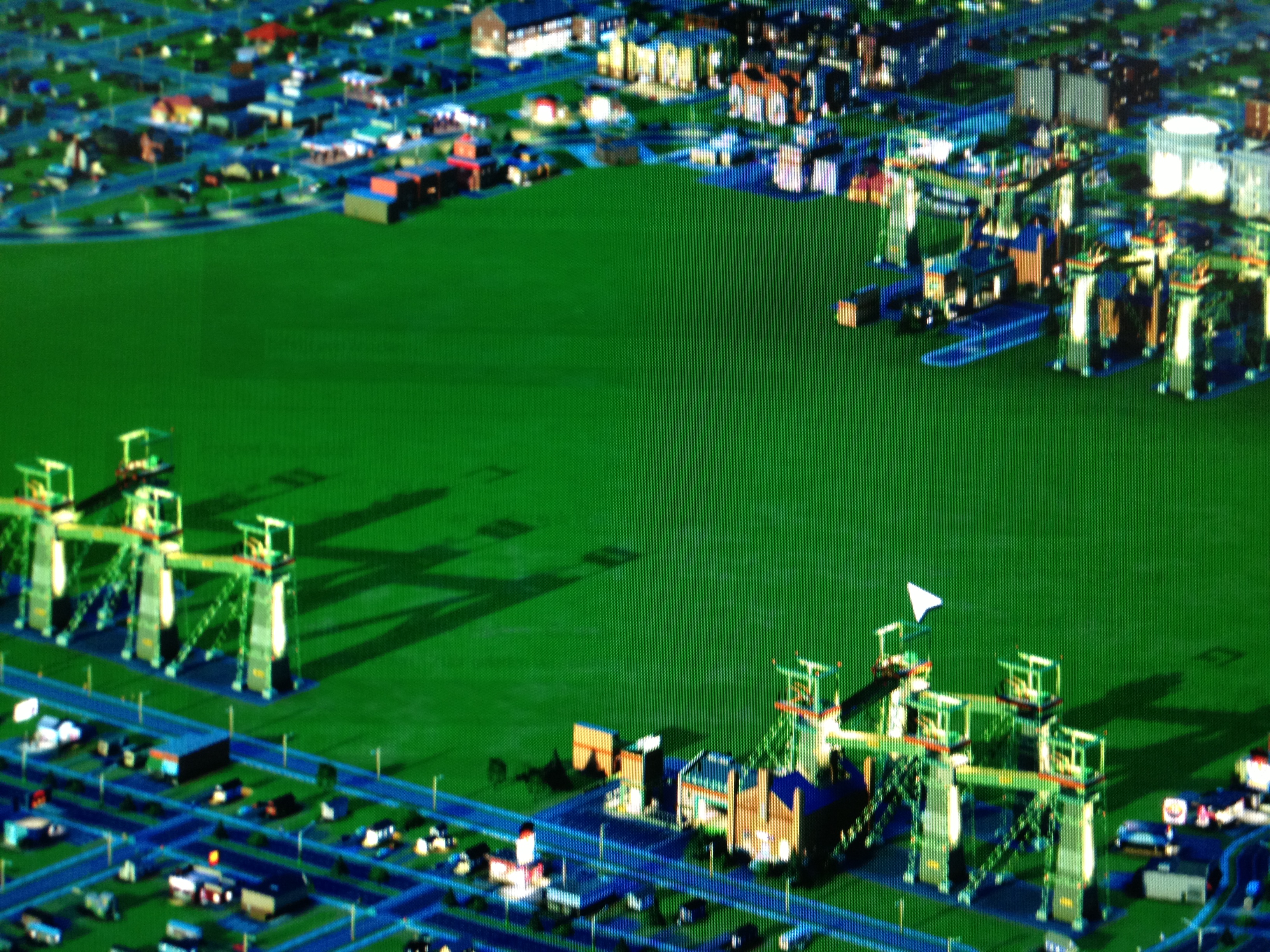

Just opened my SimCity on my new late 2012 (27") iMac, and suddenly i see some burned in image of facebook of my browser
What do I need to do? And how is this possible?

Please post the exact specs of your machine.
If you search for "iMac Image Retention" you'll find that this is an unfortunate problem that is plaguing some of the 27-inch late 2012 iMacs.
Since it's not happening to everyone out there, I'm trying to see if this is only afflicting a certain combination of custom configurations.
Are you using an i7 processor?
Again, please post the exact specs of our iMac.
