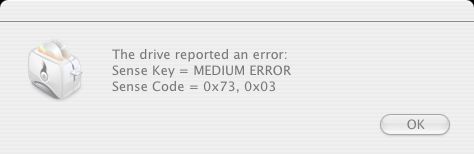

Last week a burned a dvd fine then I needed another copy. I went to burn it in DVD studio pro 3 and I got this error:
Error = 0x73, 0x03
I then tried to burn it in toast and got the same error except with a little more. I attached the toast error. Any ideas???

Its probably a hardware problem. Where the buffer of the drive is bad and when burning at the highest speed causes a buffer under run which then causes this error message to show up. Try burning at a slower speed.

I had it set at 'best' before, I will try a lower speed.
Thanks 🙂
yay, thank you so much varmit. I just tried burning at 2x speed and it works fine now. Thanks again
