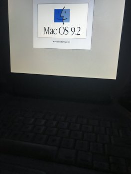

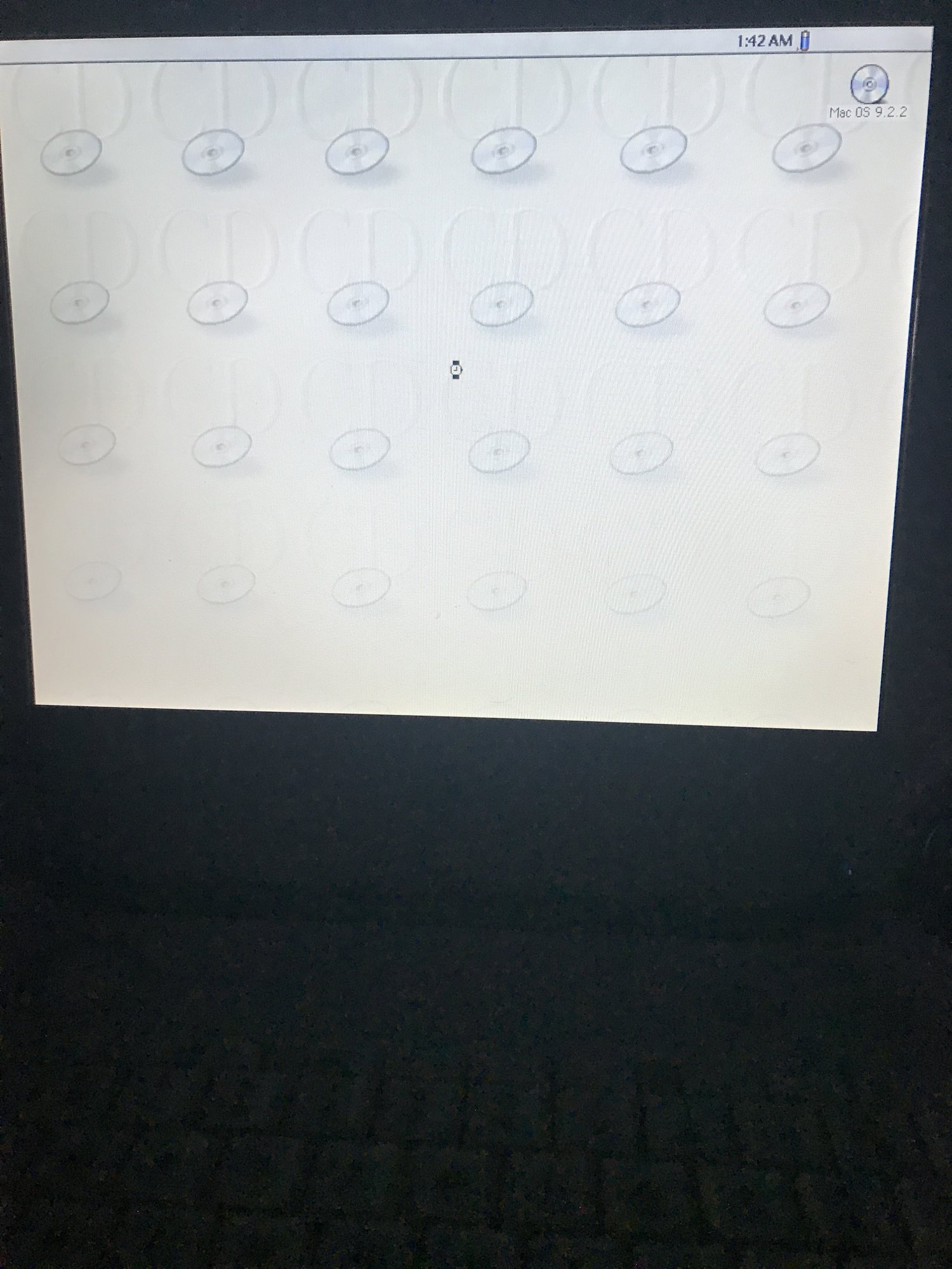

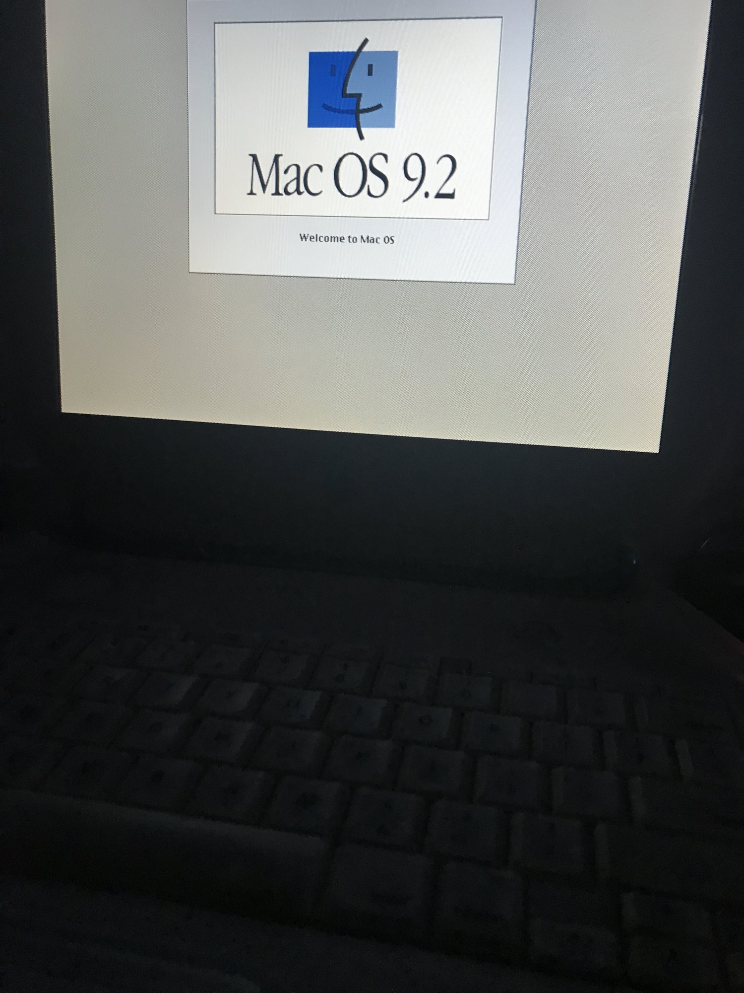

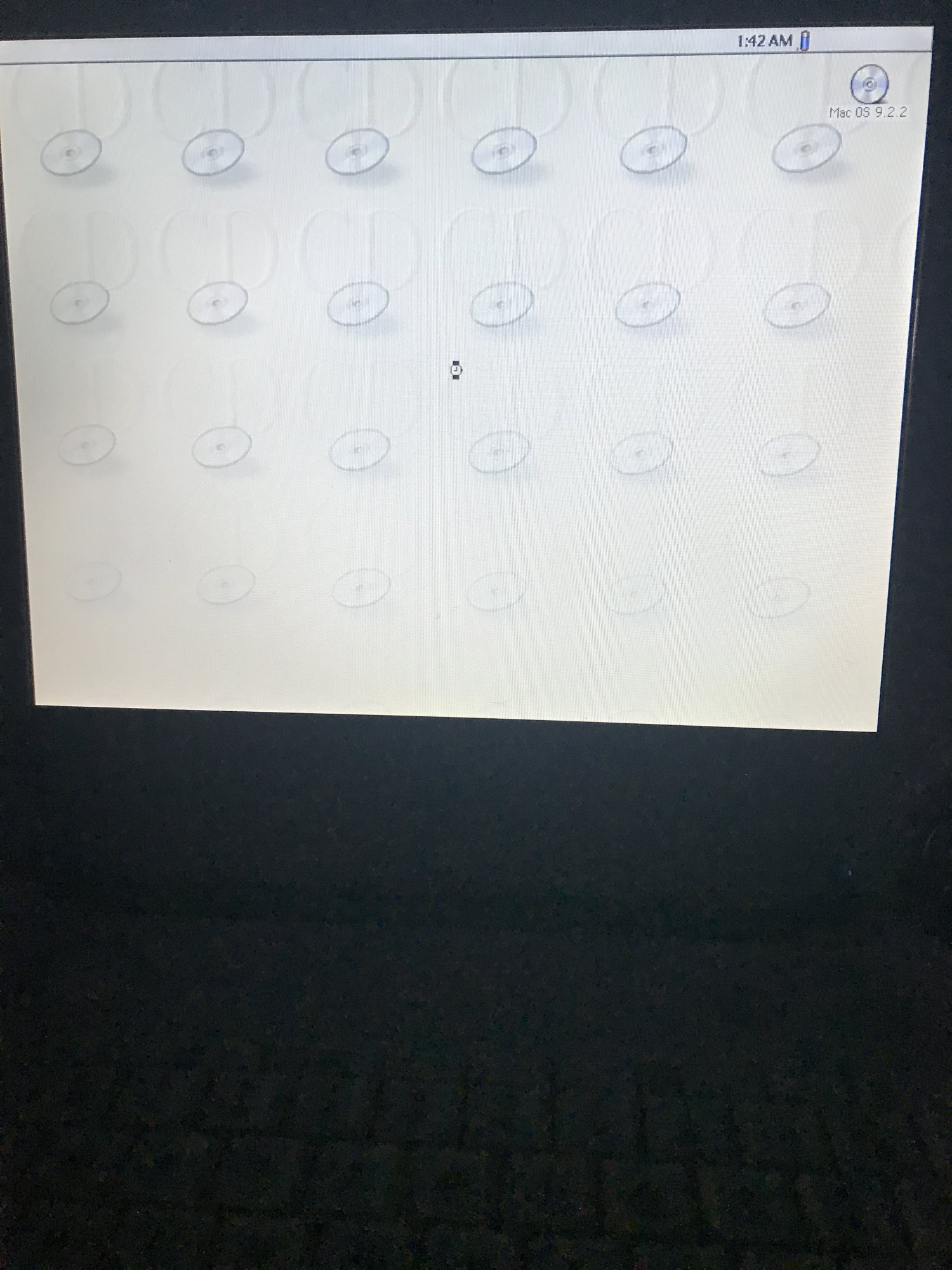

To the left of me is TWELVE CD-R coasters of 8.6-10.2. Inside of my iBook however, is a booting OS 9.2.2 CD! I thought the CD Drive was broken, and I had a serious problem because my iBook does not have FireWire (nor do I own any FireWire stuff), and I swear usb booting is a myth at least on the original iBook 300MHZ I have.
The 3GB HDD just stopped booting entirely the other day, probably due to the weird thing I did which basically converted jaguar into OS 8.6 since I couldn’t get a single CD to boot.
I was at a desperate situation. My USB DVD burner did not show up as a boot device either (works for my Mac mini, I don’t think it can get enough power out of the iBook). I thought my only course of action would be to remove the HDD and install an OS using my Mac mini. I don’t even have all the tools to do that.
I bet 8.6 will work with burn as well. I used my Mac mini btw, somehow both my Macs have working optical drives.

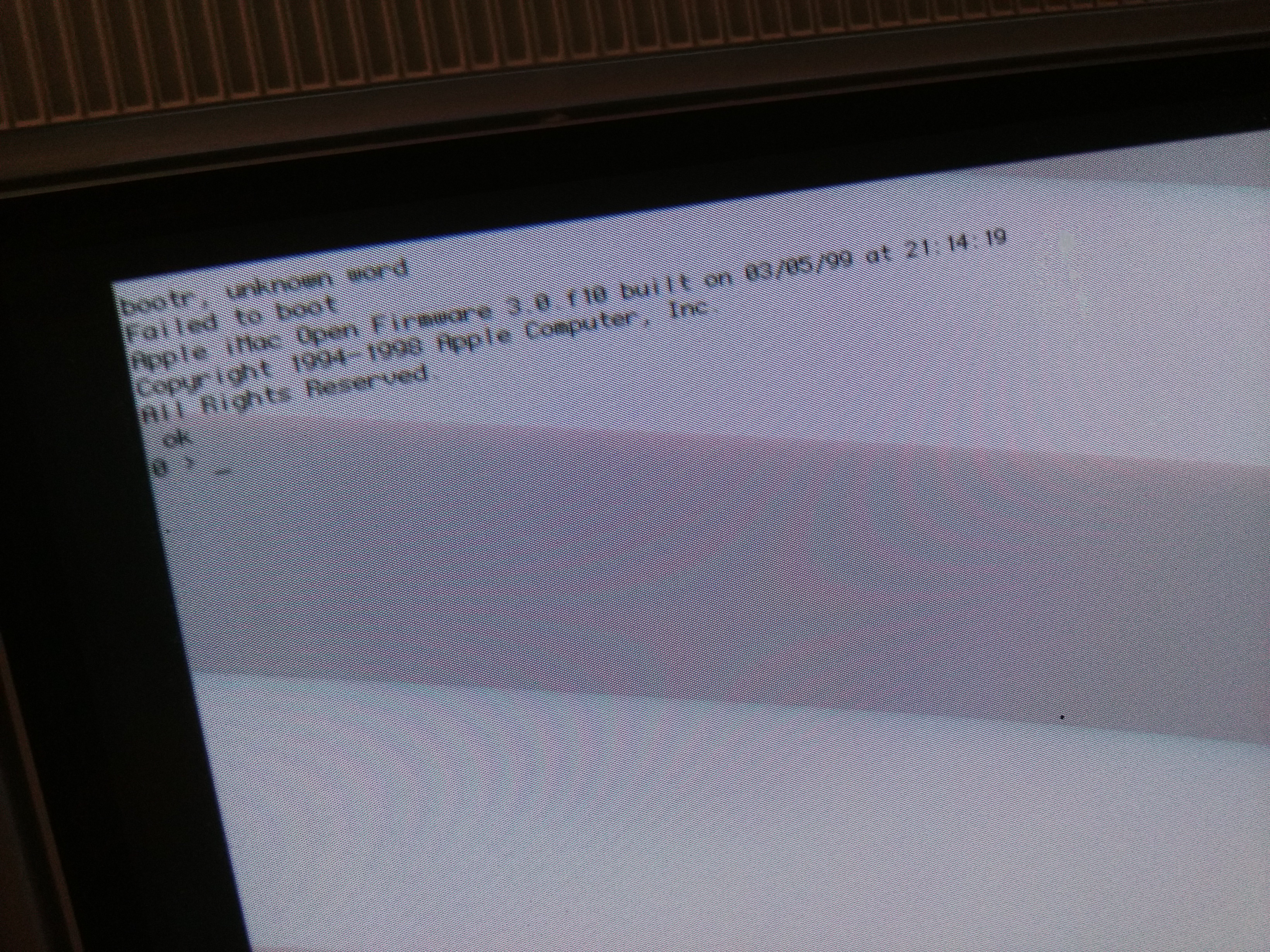

The bad VHB error is weird, only happens on the iBook never on the Mac mini. I swear it’s a chipset incompatibility, usb 1.1 is ancient and if a usb DVD burner can’t be a boot device (that is supposed to be usb 2.0/1.1!, it was made in 2019 and was the cheapest thing at the store) then it’s not to far fetched to think the usb flash drive controller of newer flash drives could be incompatible as boot devices.
I have never had a usb device show in the multi-boot menu. And in open firmware I can find the usb but when attempting to boot on it I get that cryptic bad VHB error that there is no info on.
Thoughts?
one extra step i took to make the G3 bootable after OS installation was to make hard drive the start up disk (https://ibb.co/zXgZxCG) still same problem not being able to boot from hard drive, one strange thing is that i am installing 9.2.2 but why the installed version is 9.1.2? any idea?
re drivers, the hard drive is blank so there is no previous OSX or any other OS installed. can't figure out why it doesn't boot?
taking my attecntion of this one i switched to installing 9.2.2 on the second G3, i get this error (ttps://ibb.co/yyQZy8f) which i guess it means my firmware is too old. would you know where i can find the firmware?
i guess if have a newer firmware i might be able to boot from USB
