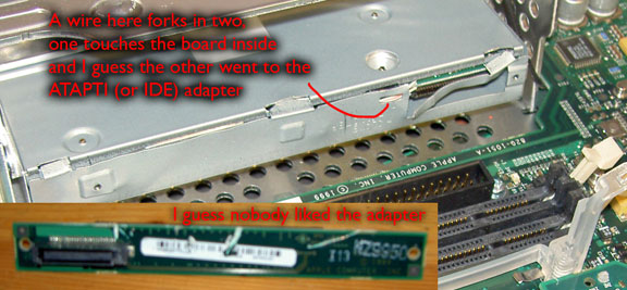

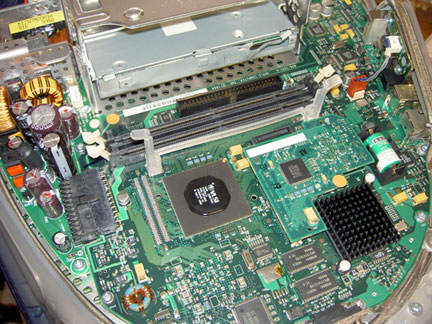

EDIT: Here are some pictures, I noticed the DVD drive may be 'semi-working' since it looks a bit damaged or something. It's ok I can always use a FireWire external one if need be. 😀
