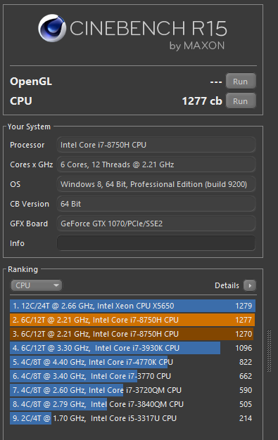

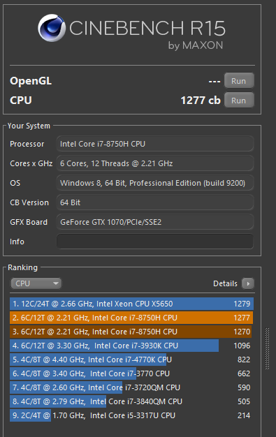

A more representative rendering benchmark is Corona Renderer as the test duration exceeds the PL-1 (short term Turbo limit) Cinebench R15 on a fast CPU will generally complete the task before the PL-1 limit kicks in at around the 28 second mark. Any takers 😛
Although we're having a little fun here 😛 it's also important to understand the why's and wherefores, also the limits Apple has to put in place due to the physical design. TBH I don't see any rights or wrongs, more differences in execution, although I feel Apple could do more if it was inclined to do so from an engineering perspective.
In all transparency I believe my 8750H is very likely to be a binned down 8850H hence it's significant performance advantage, being close to 3 seconds faster on Corona than it's counterparts, similar applies to Cinebench R15 being one of the top performers.
nb. If demand dictates Intel will bin down and clock-lock higher performing CPUs, such CPU's tend to perform way above expectation in comparison to their nominal counterparts.
