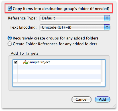

Are you copying the files into your destination group's folder?
